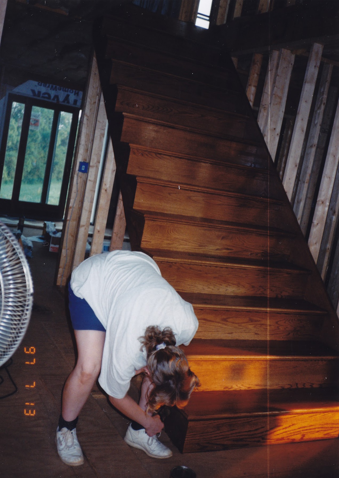

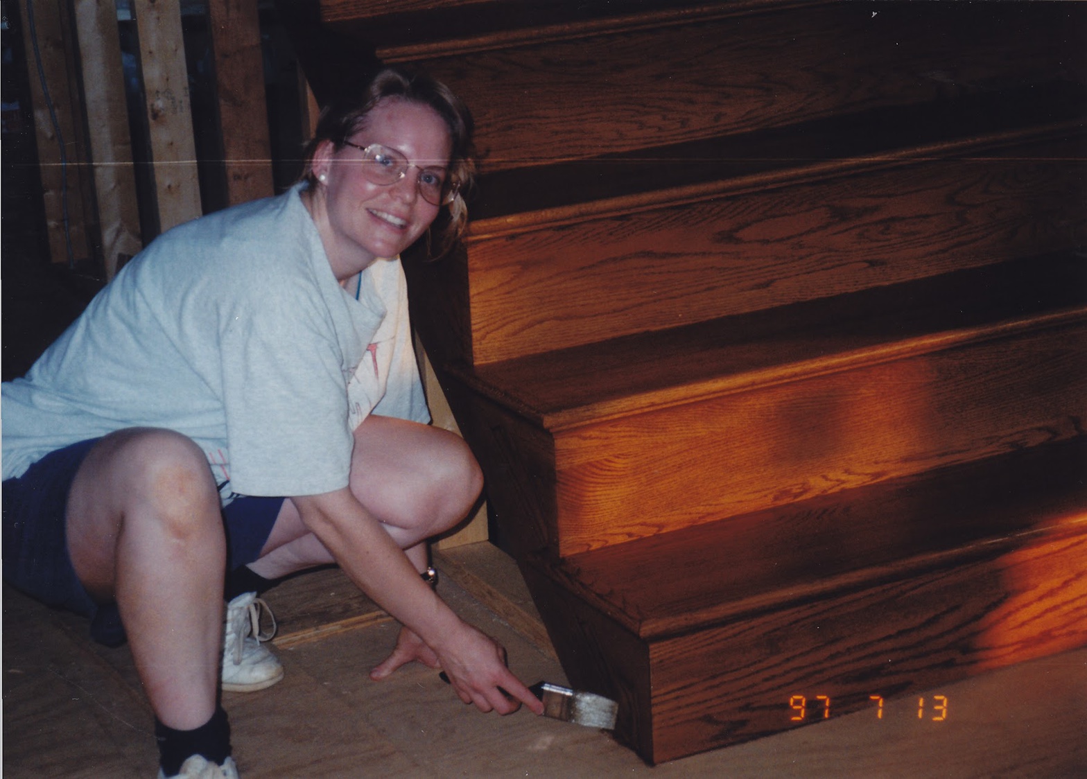

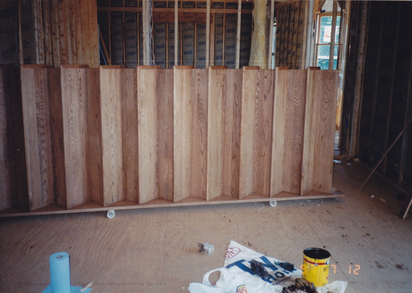

19970712 Saturday
Hutch helped 4 hrs
Stained new oak stairs
Removed temporary stairs.
Installed oak stairs.

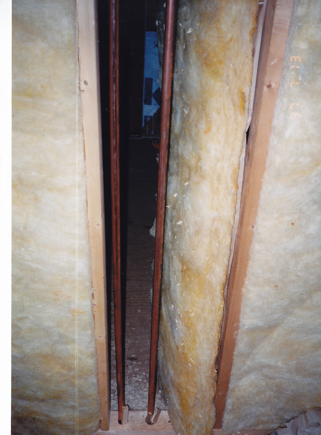

Install copper pipe loop for upstairs heat exchanger. This is wall between half bath and front closet. I insulated bathroom walls for sound.

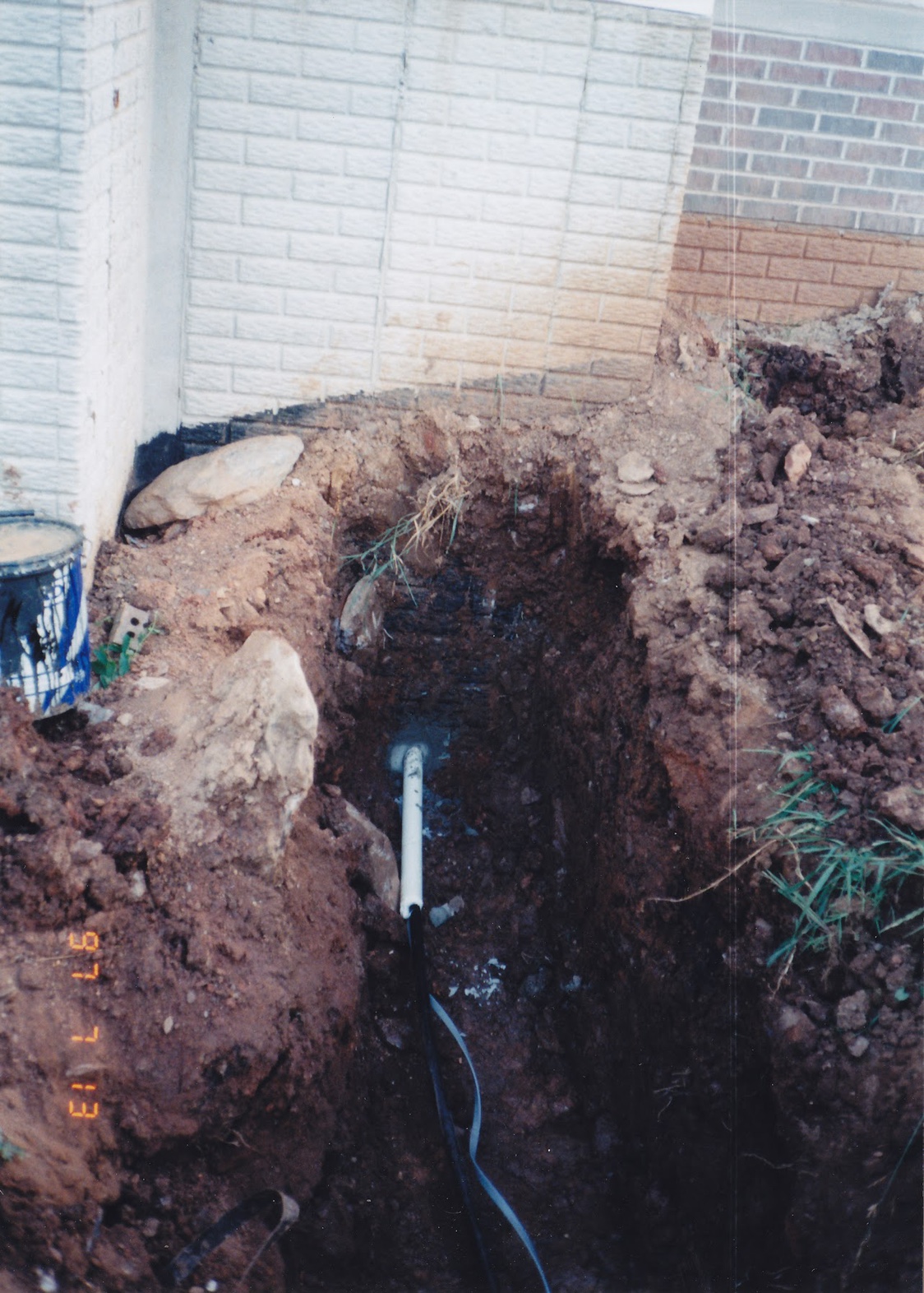

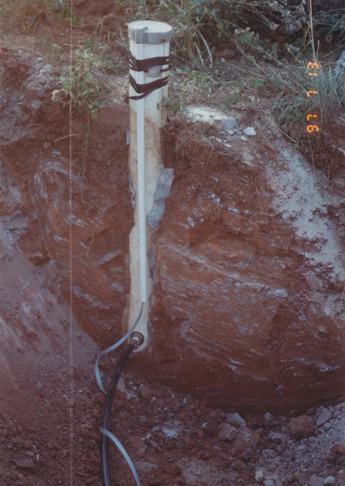

My neighbor dug for my well line and we installed water line and pitless adapter in the well. Sleeved thru larger pipe thru basement wall.

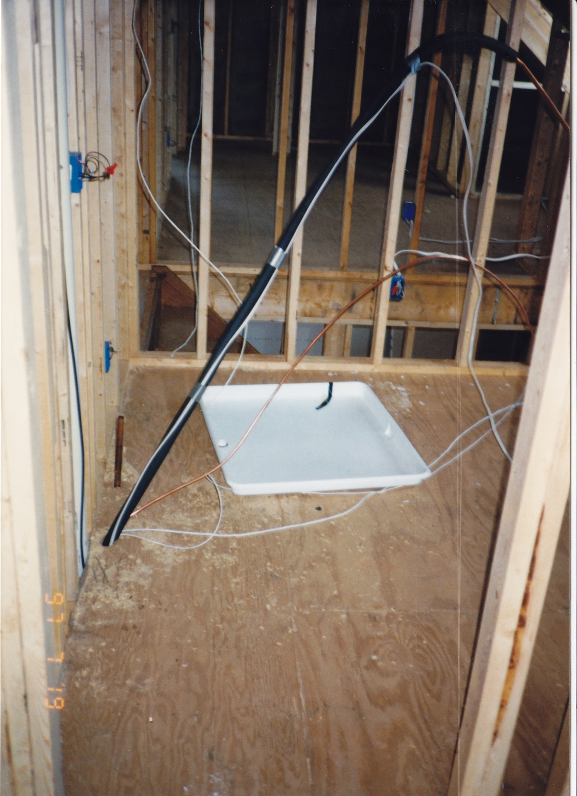

And installed AC line set to upstairs unit.
Line set next to house stack, heat lines to right, this is ceiling of half bath.
Lines coming thru floor upstairs. We ended up putting upstairs unit in corner of our walk in closet, which I had made larger. Originally was going to put this unit in attic, but just not enough room. This unit has since been removed with my geothermal install.
Pan was installed under the unit, and was needed a couple times when condensate drain clogged.

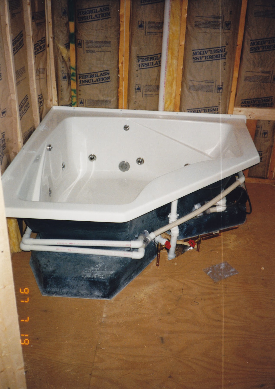

After work, picked up the whirlpool tub and carried it upstairs.

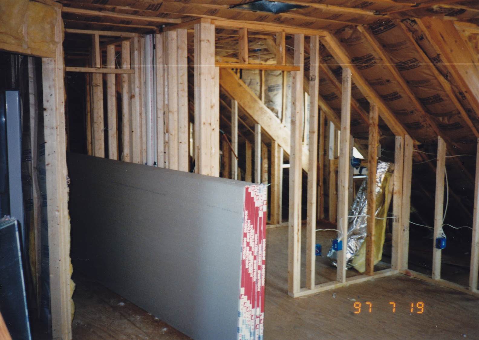

19970715 Tuesday
Drywall delivered.
