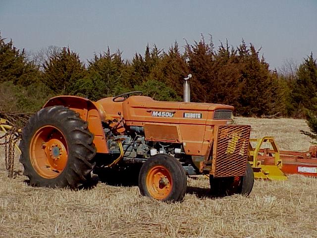

This old Kubota found a new home where there are Bodark thorns and stubs remaining from bush hogging (big mistake) and has front flats like never before. It will be getting item 9DR4 from Gempler's. Hopefully that will solve the problem.
