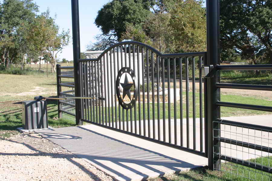

Okay, Harv. You've had enough time to build the gates and we want to see an update with detailed pictures of the hanging and all. I want to see how the powder coating came out. My last gate was 15 feet and sagged less than 1/8 of an inch so the pressure is on. ;)

Gary, thats a fine looking gate. Who did you use for Powder Coating. I have not had time to look and find some one local. I have a small project I want to do in the next several weeks and will need a powder Coater.

I sandblasted and painted my gate with Imron (Dupont). Maybe I just didn't find the right powder coater, because they were all way too high. I picked up a business card at Mo's BBQ the other day. It's a powder coater in Liberty Hill - Diamond Powder Coating, Dave Hansen @ 512-778-9345. Next time I have something, I'll give him a call. You do the same and let me know what you find.
