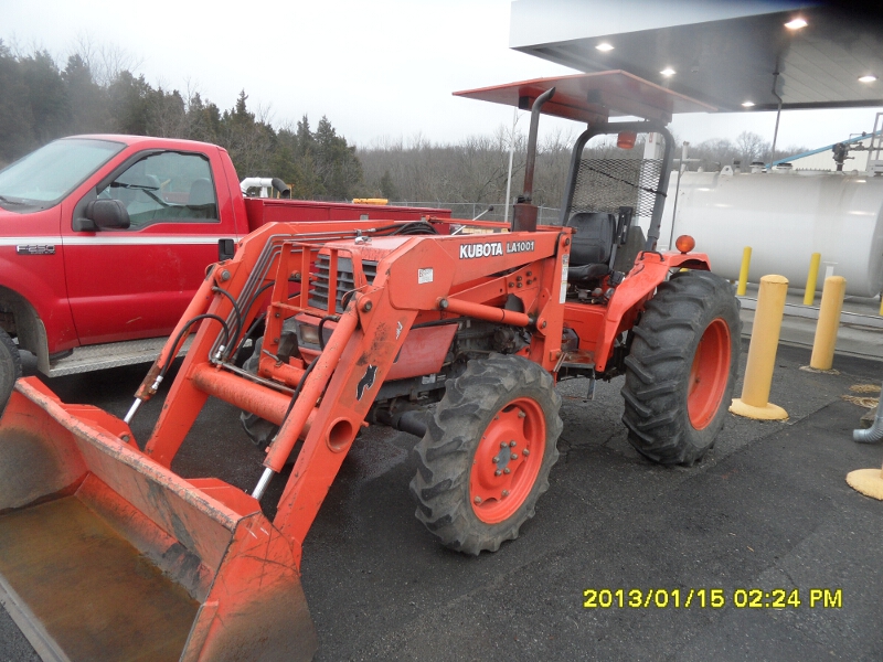

Other than the size that looks remarkably similar to my M4700 when I bought it back in 2013 for about $12K.
Same color, similar wear pattern, same cracked taillights, same flashers.
Mine had been used for mowing beside the county roads for about 1400 hours.
Over the last 10 years and MAYBE 1,000 hours MAX, only minor repairs and replacements. Biggest being the front tires.
I see you have the light duty material bucket which usually gets bent on top. The excavation bucket has a rolled top ends and a double floor too and no SSQA which I feel is necessary. When I do field work, the bucket is always off and usually the entire loader. Very easy to dismount and remount.
