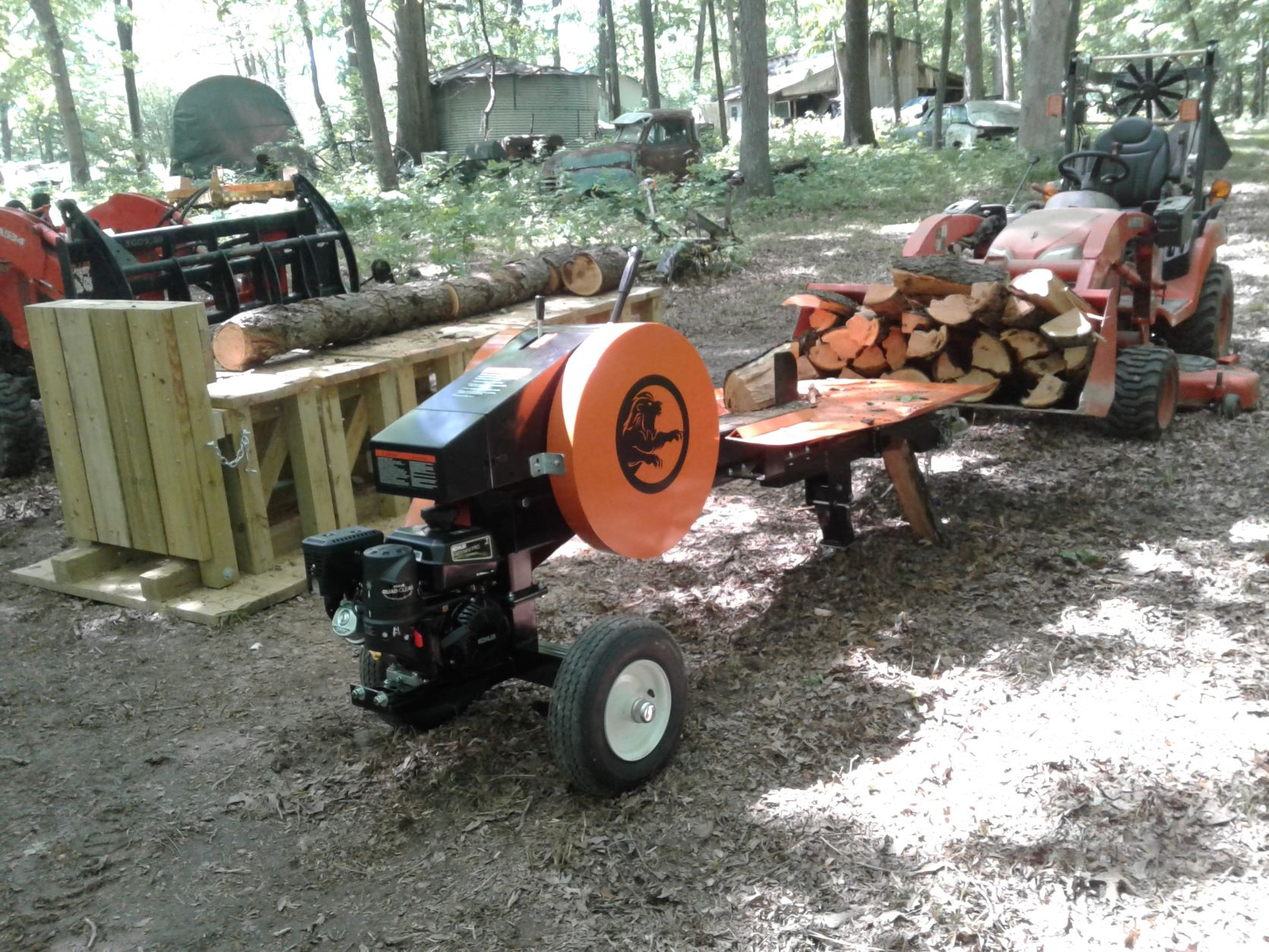

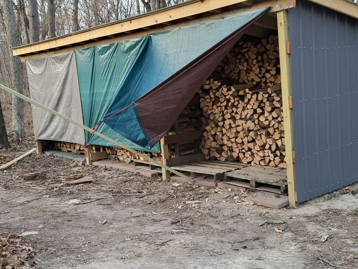

Beautiful rack, but have you ever thought of putting a roof on it to protect your implements?
A roof & 3 sides are a project for next year. Working solo I've built a bucking table, woodshed & stocked it and started the Kubota toybox

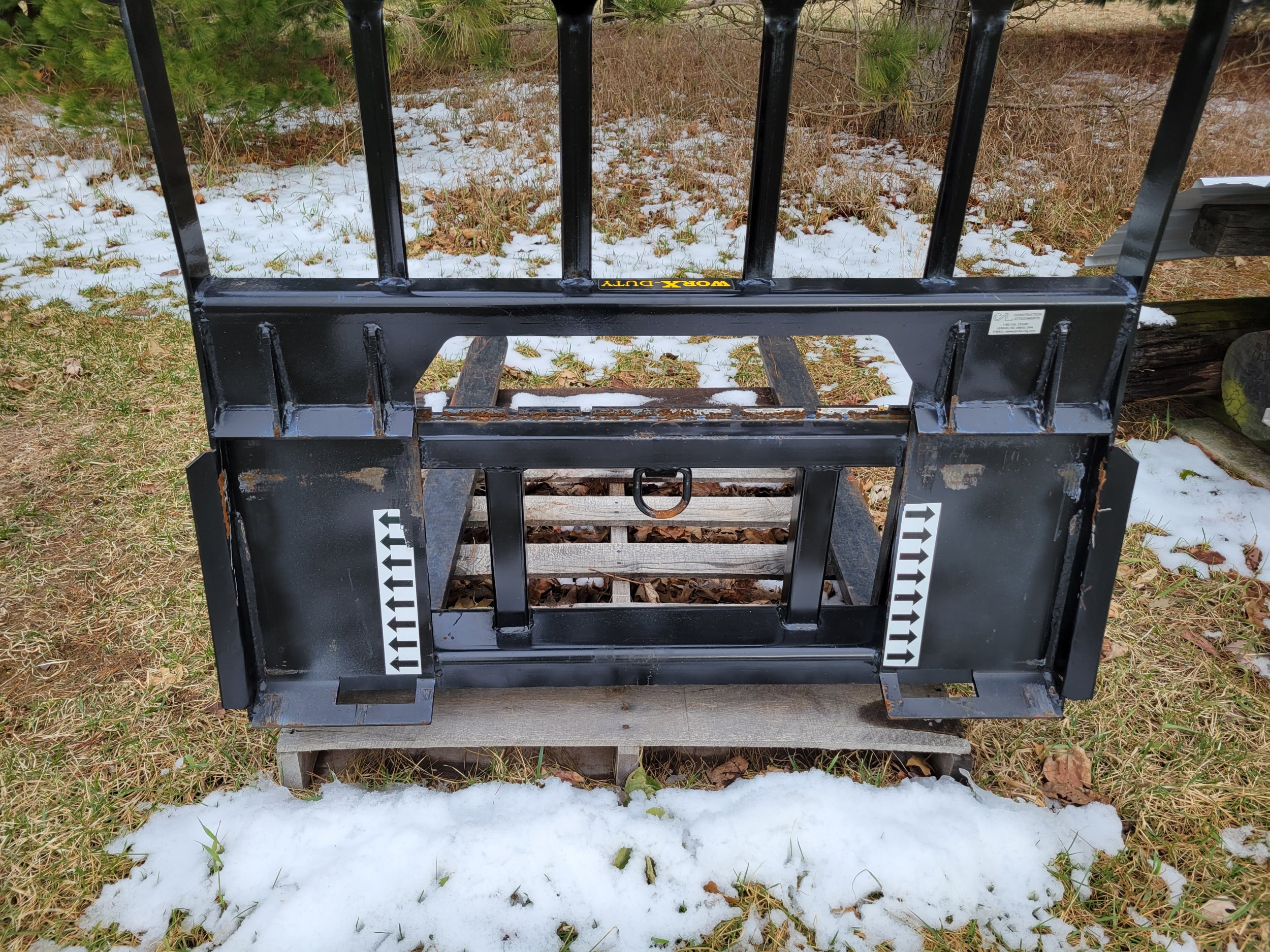

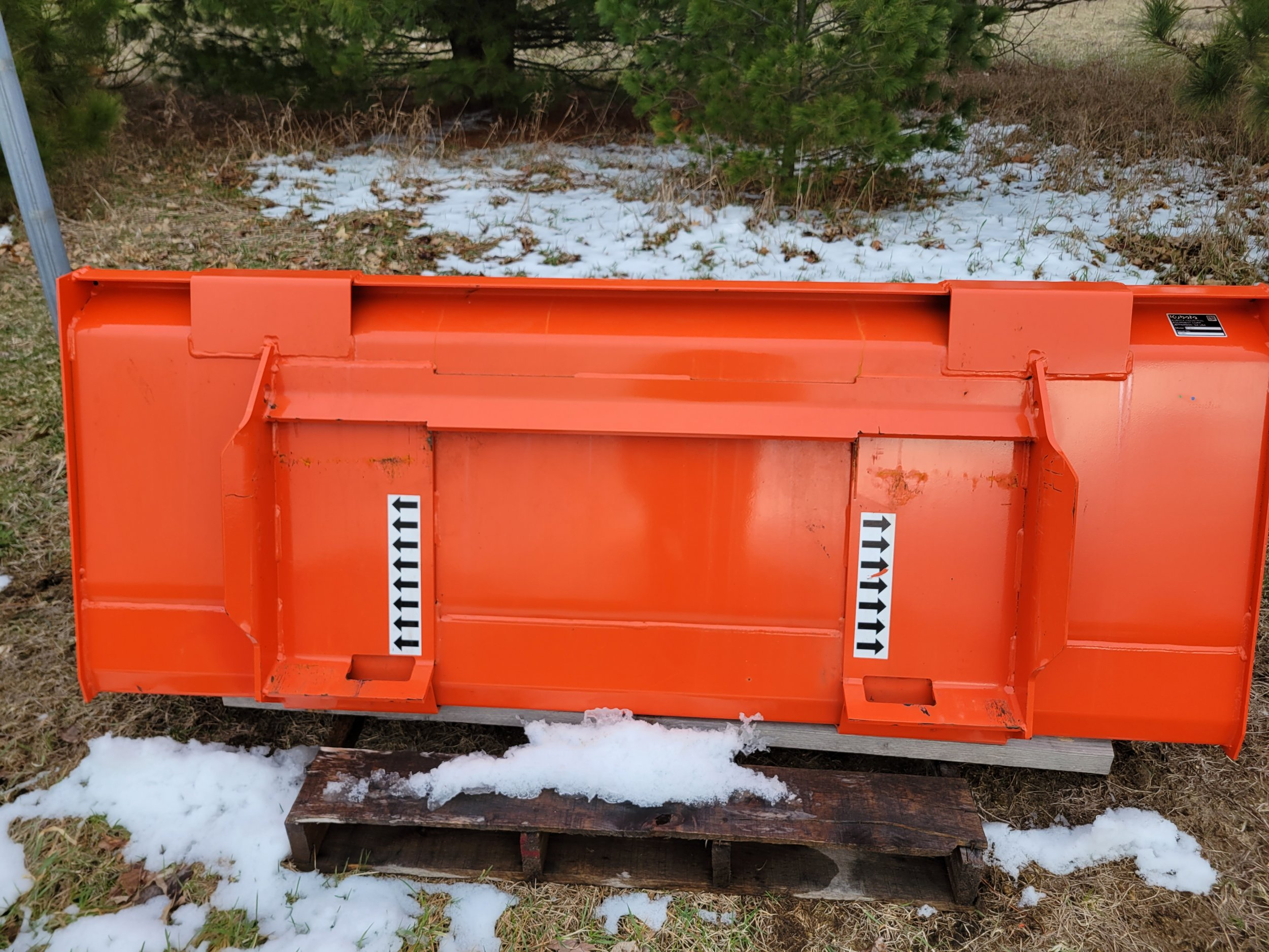

I added some contrasting pipe marker tape on mine to help line up.

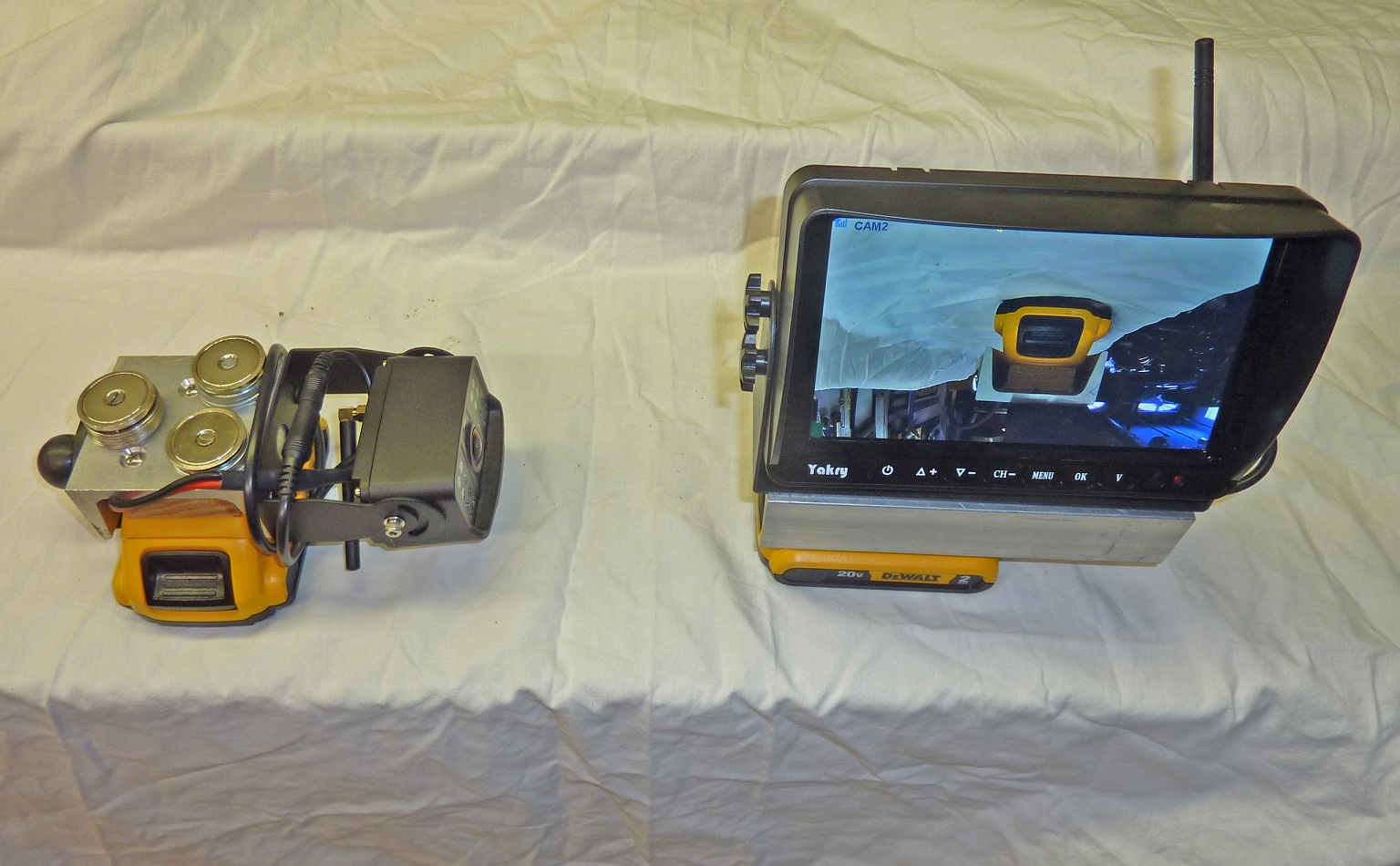

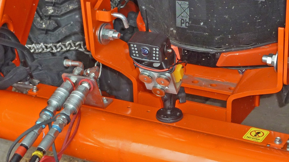

I use a wireless camera powered by a cordless tool battery. It has a dual magnetic base which will stick to any metal surface:
View attachment 771524 View attachment 771525
View attachment 771529 View attachment 771526
View attachment 771528 View attachment 771527
I store it in the cab and place it wherever it's needed. It can also be placed on the ground which sometimes gives a better view of the work operation.
mind sharing links or anything else about this project, i want to add a camera to mine and really like this idea of relocatable camera and monitor
   / Thoughts On Lining Up Bucket to Front End Loader #39
Here's a link to the thread on how I made mine. Some questions were answered but if you have more, just ask:
