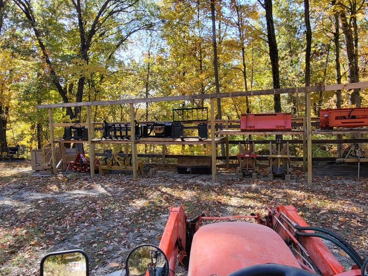

So I painted a line and it works really well. Unhooked and hooked four times and got it on the first time! Thanks again!

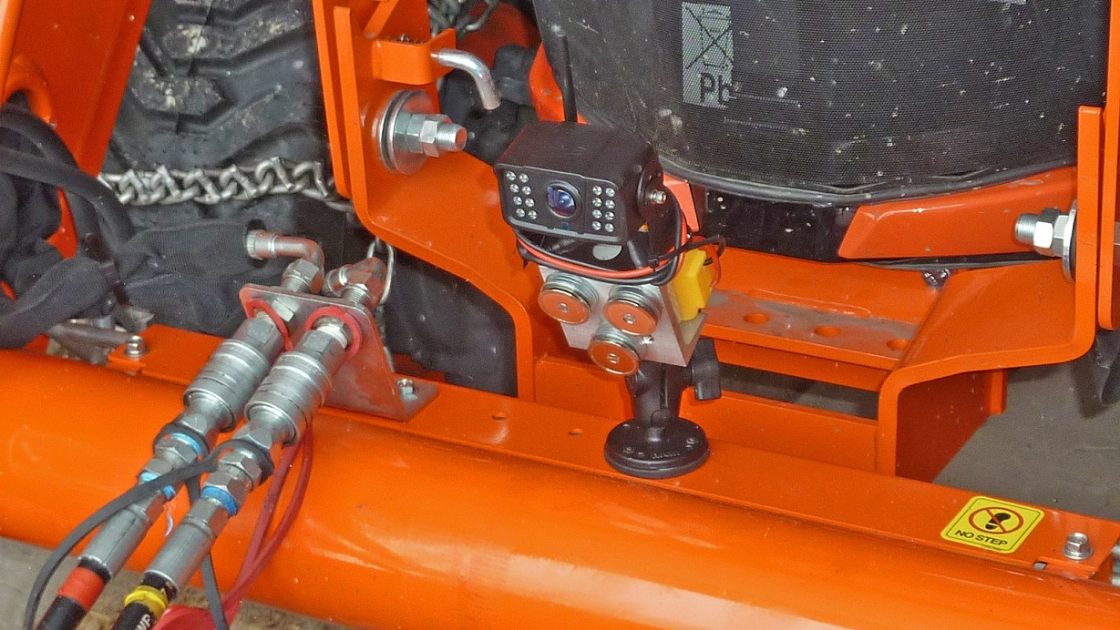

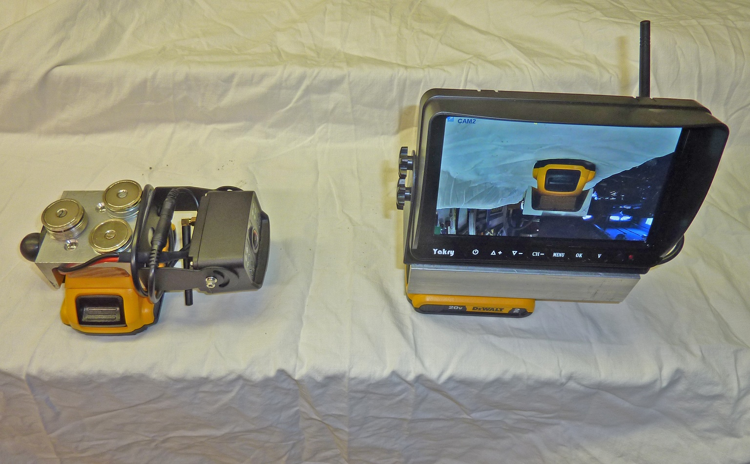

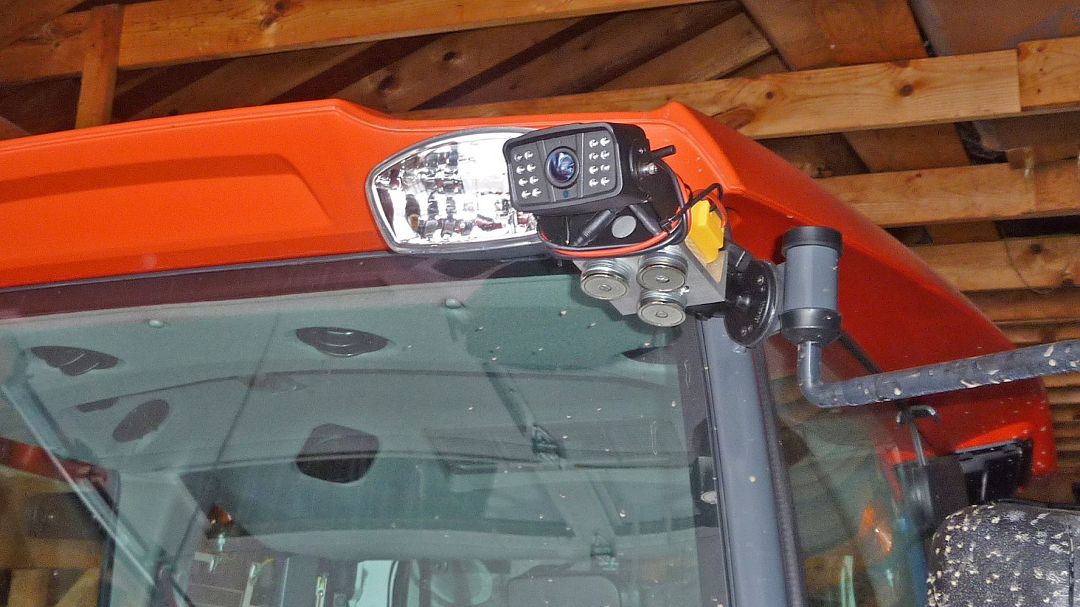

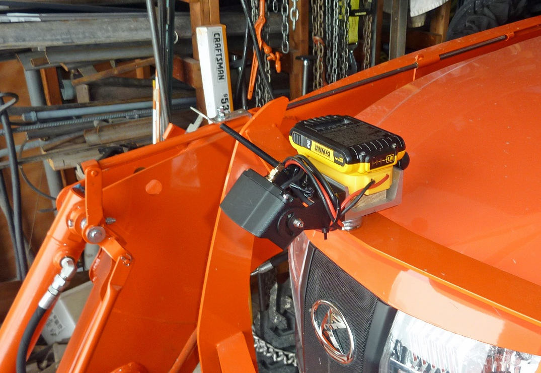

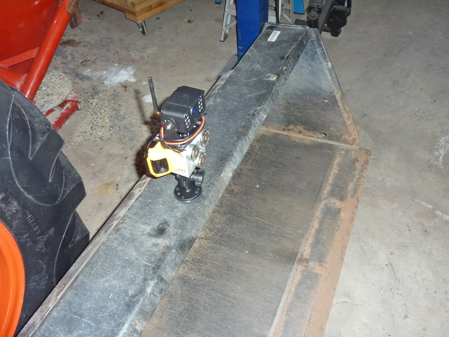

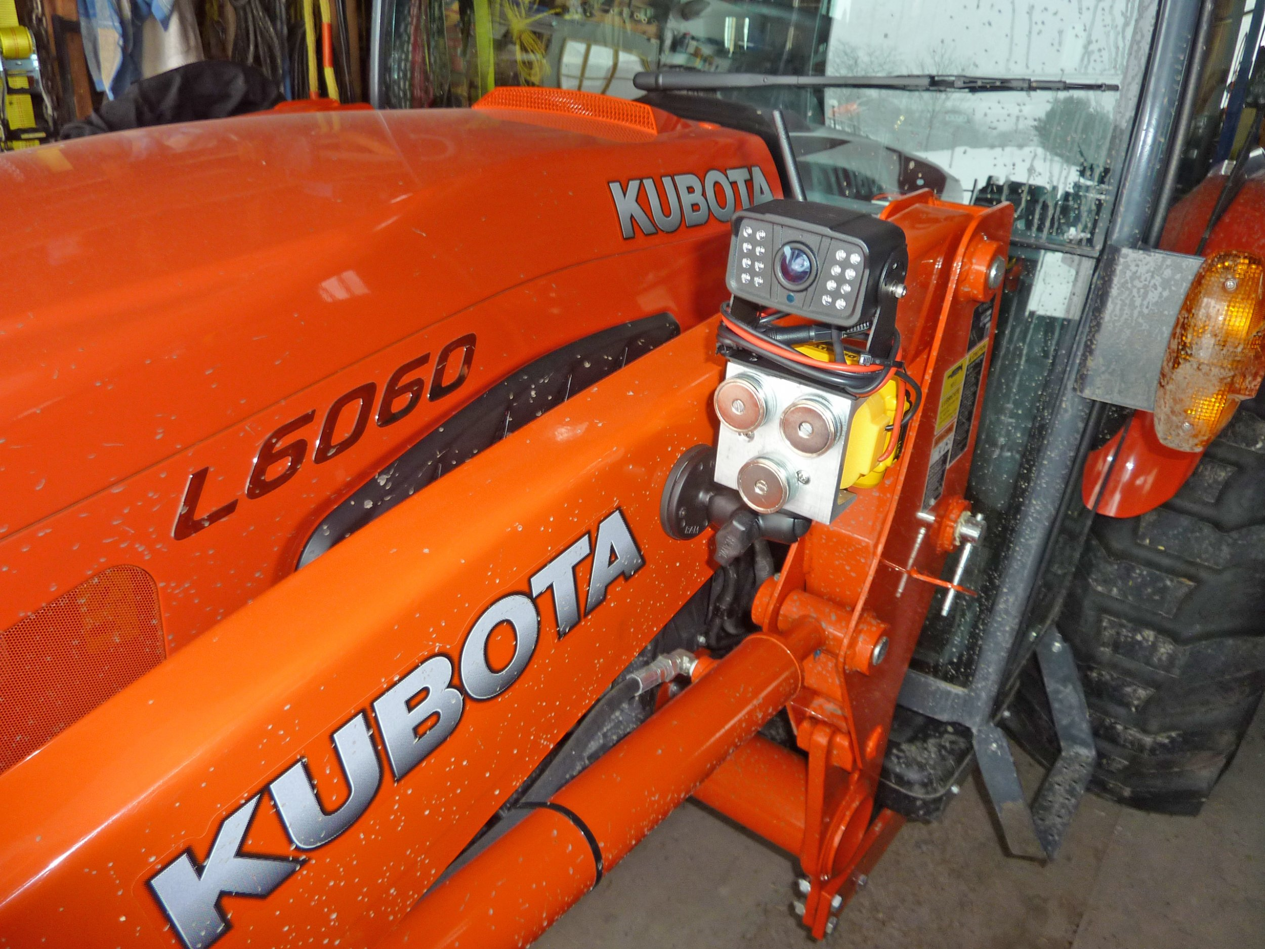

I use a wireless camera powered by a cordless tool battery. It has a dual magnetic base which will stick to any metal surface:
I store it in the cab and place it wherever it's needed. It can also be placed on the ground which sometimes gives a better view of the work operation.

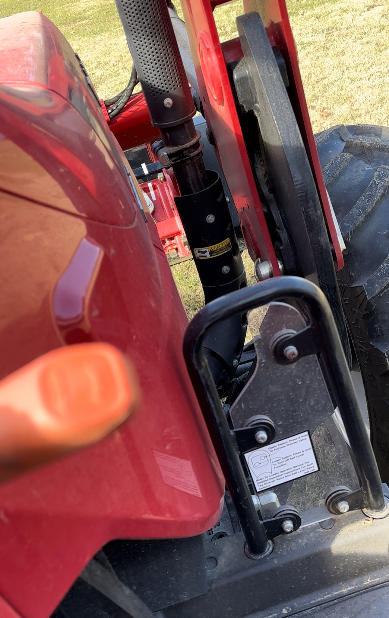

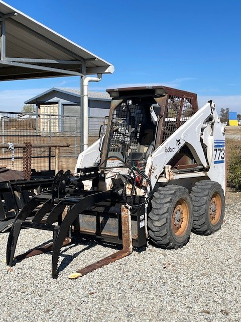

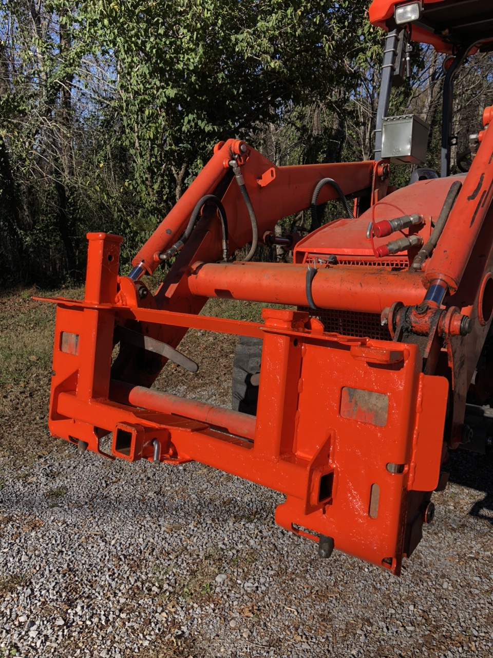

It's just easier to see the contact points on some tractors than others. I read the LS or NH tractors had a very sloping hood and loader arms making SSQA easier to see.
The MX Kubota is not too bad to see. But nothing come close to the ease of connecting implements on the Bobcat
