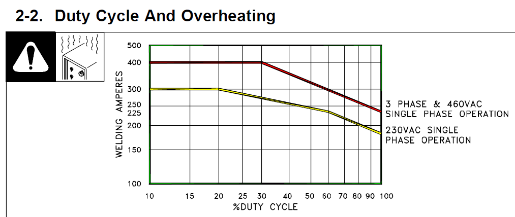

My XMT 304 is an inverter and has a significantly higher output limit on 3 phase.

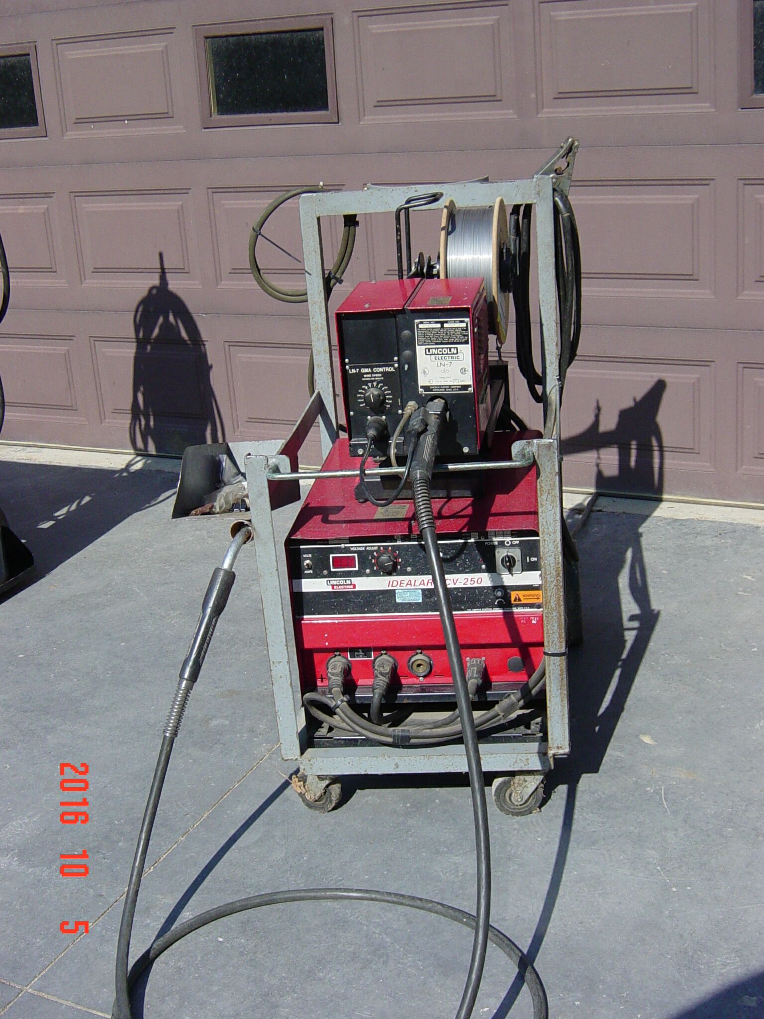

I bought this machine by accident at an auction for $1000 CDN years ago. Looked at nameplate and saw one option of 220 or something, not realizing it was three phase.
Built a 10 hp Rotocon to run it but the computer in the welder never liked the fake phase and would do odd things.
I do miss the pizazz of the bigger machine. NOTHING like industrial equipment! No Silly NASCAR stickers either!
I also ran it on 600 VOLTS which allowed for nice long extension cords and feeds to other buildings.

Actually, what the graph shows is a lower output at a lower voltage. The top line is 3 phase and 460v SINGLE PHASE. The lower line is 230v single phase.
...Which would include 208 3 phase on the higher line...thus my point.
