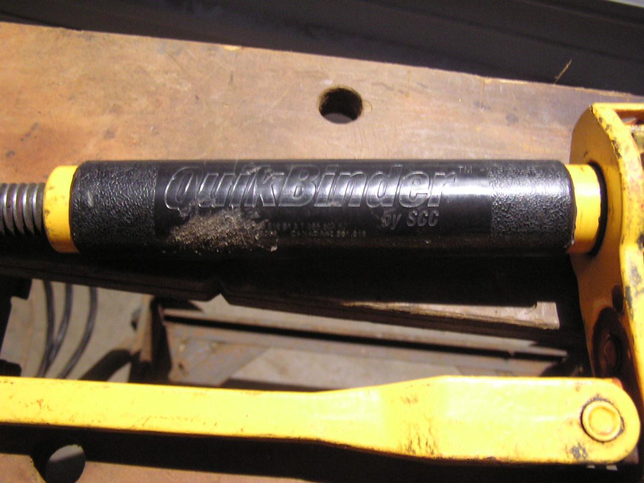

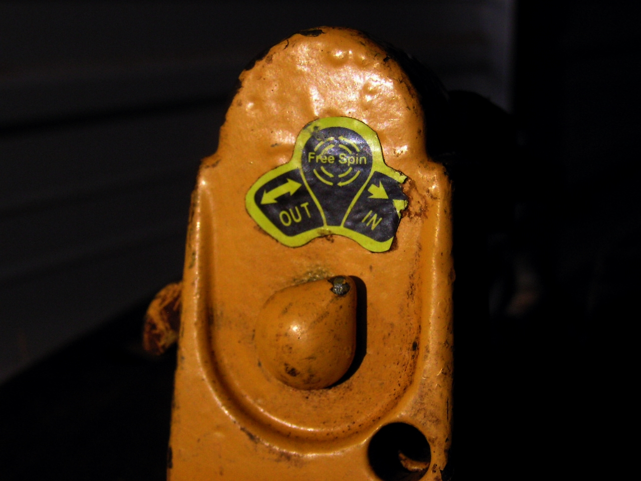

One thing I did decide yesterday my first time using the screw type binders, wish had bought the higher priced ones you use cordless drills to run down. Bout wore me out.
Mine are the folding handle style:
With a neutral position so you can spin them by hand till they get snug:
7,100 WLL:
