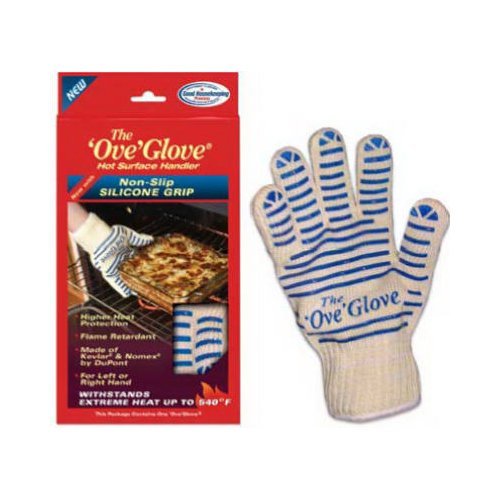

Stop by the grocery store and pick up a pair of Ove-gloves. ;)
Shield Arc, I read about those on Weldingweb, thanks. Do you use them?

Yes I use them. I'm the one who gave Zap the idea.;)
I am going to get a pair of Tilman's, but I will check a pair of those out also. You can't have too many gloves.
