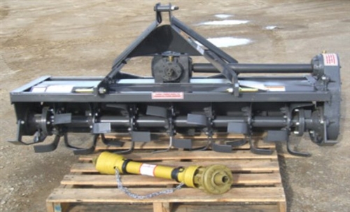

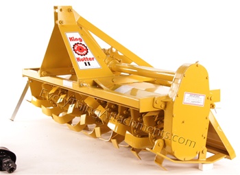

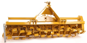

Well, If we could get reverse rotation capable on a forward rotation tiller like Tarter at basically the same price point as KK, progress will indeed may made. What is the tine scroll diameter on the KK? It is 16" in the Tarter which should give about a max tilling depth of 7 inches, if buried to the axle. Forward or reverse capabilities all come in the same machine on the 4 ft, 5 ft and 6 ft Tarter. Ken Sweet
I was only asking for the same info on the tarter that I provided for the KK.
I can't imagine anyone taking 1-2hrs to reverse a new tiller that was really made for forward rotation;
I think they'd just purchase a reverse rotation tiller with a guard to protect the tractor and operator from flying rocks.
I'm not sure of the measurement you asked for but someone can surely provide us with that. If tarter did a good copy job, they should be pretty close!

If Tarter copied, KK should be reversable also? If KK don't reverse, Tarter is not a copy. Ken Sweet

How are you determining a Tarter will till 7"s deep??
This was copied & pasted from the Tarter sales info. Adjustable runners for working depths from 1" to 4"
As far as changing from forward to reverse rotation one needs to remove gearbox & flip over plus reverse ALL tines.

This has all been discussed in a recent TBN thread if you would like to do a search. Tarter is honest in their ads..1 pass = 4 inches. Everyone else say MAX 5-6-7-8 inches. Actually, you just measure your tine scroll diameter and divide that by 2 and then subtract approx 1 inch or so for the axle diameter. Runners sink in the loose dirt 2nd or 3rd pass. Ken SWeet

On my ground, a reverse rotation tiller will dig deeper than a forward rotation.
I can't envision how reverse rotation will penetrate any deeper given the exact same conditions. One way the tiller is trying to push tractor and the opposite way the tractor is having to pull the tiller.
/ tillers #56
It tends to 'suck' the tiller down into the ground with reverse rotation. But tine design plays a part in this also. My Bush Hog tiller will dig deeper than my BIL's KKII tiller because of tine design and the length of the tines. KK and Tarter are using the 'L' shaped tine, mine uses a 'C' shaped tine.
