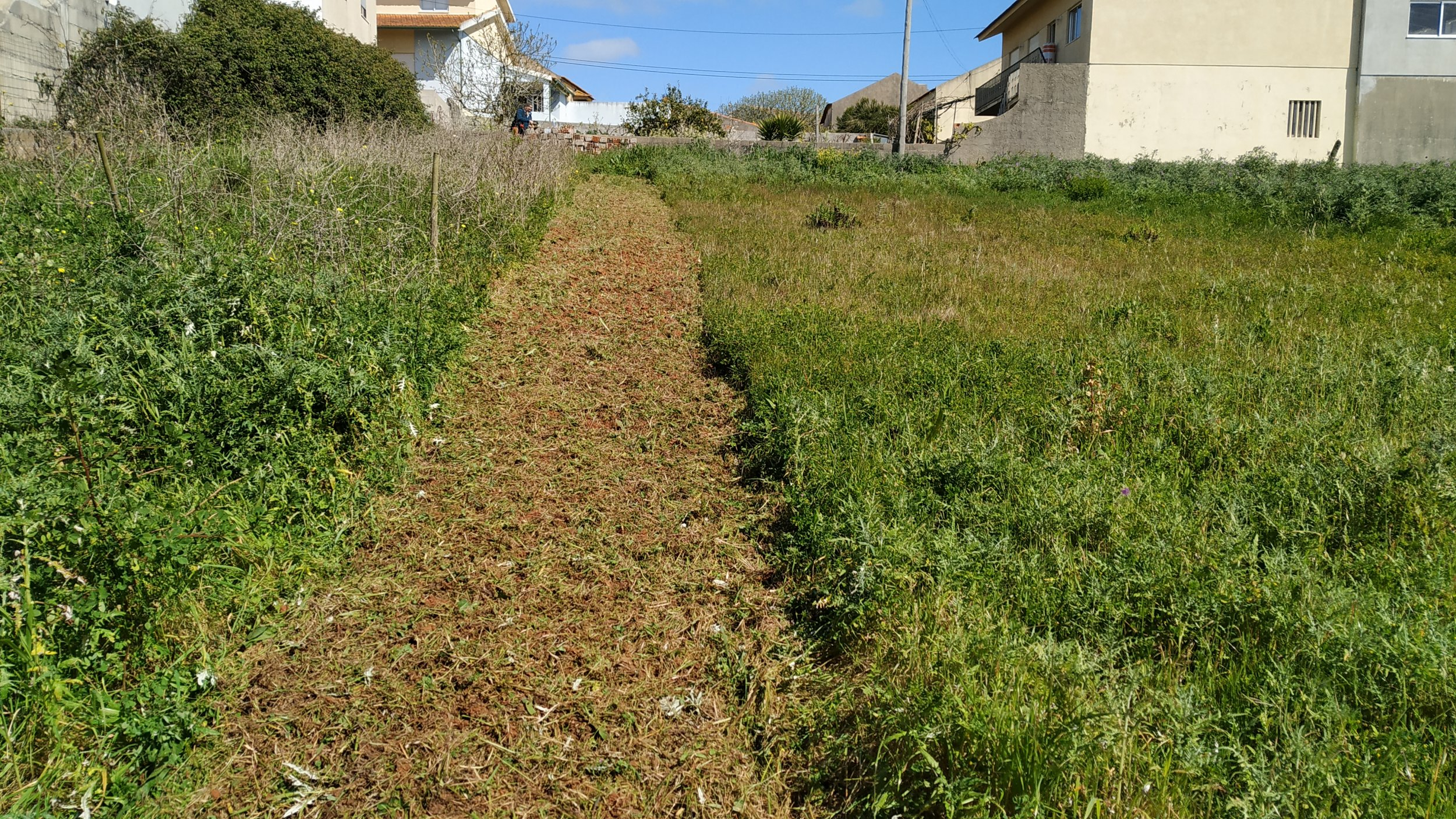

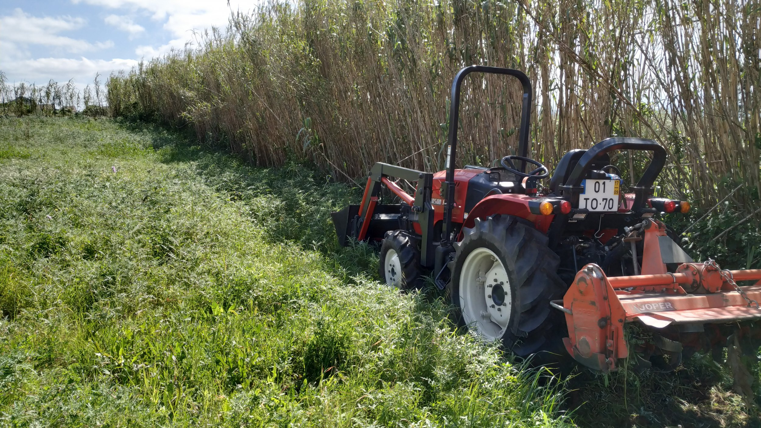

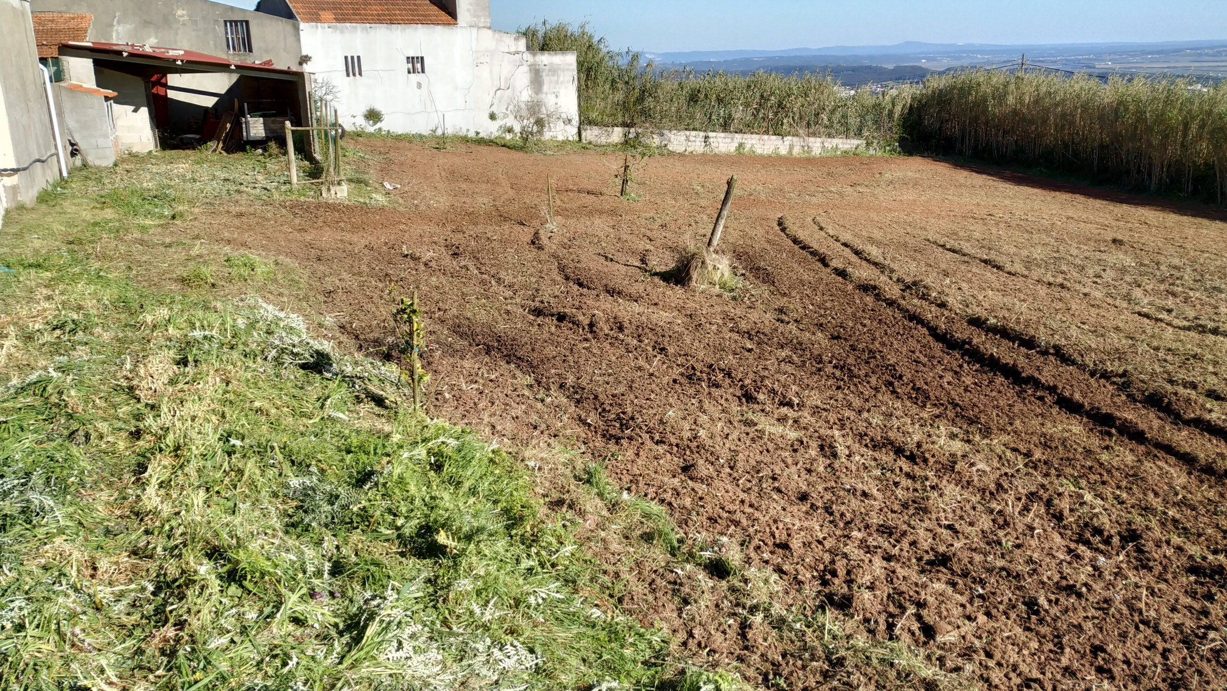

I've tilled ground with grass and even brush just above knee height with some spots above waist height and had absolutely no problems at all. Go slow, give time for the tiller to process the material. Don't start racing over the ground like most mowing and tilling videos on Youtube.
Here is a job I did for someone else early this year. I made 3 passes on the entire ground and I did everything in 540E. Worked great and actually saved a lot of fuel versus running on regular 540.
