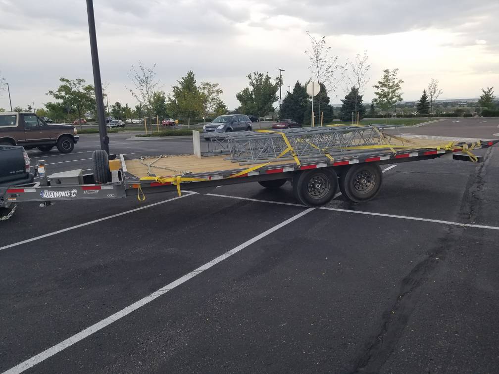

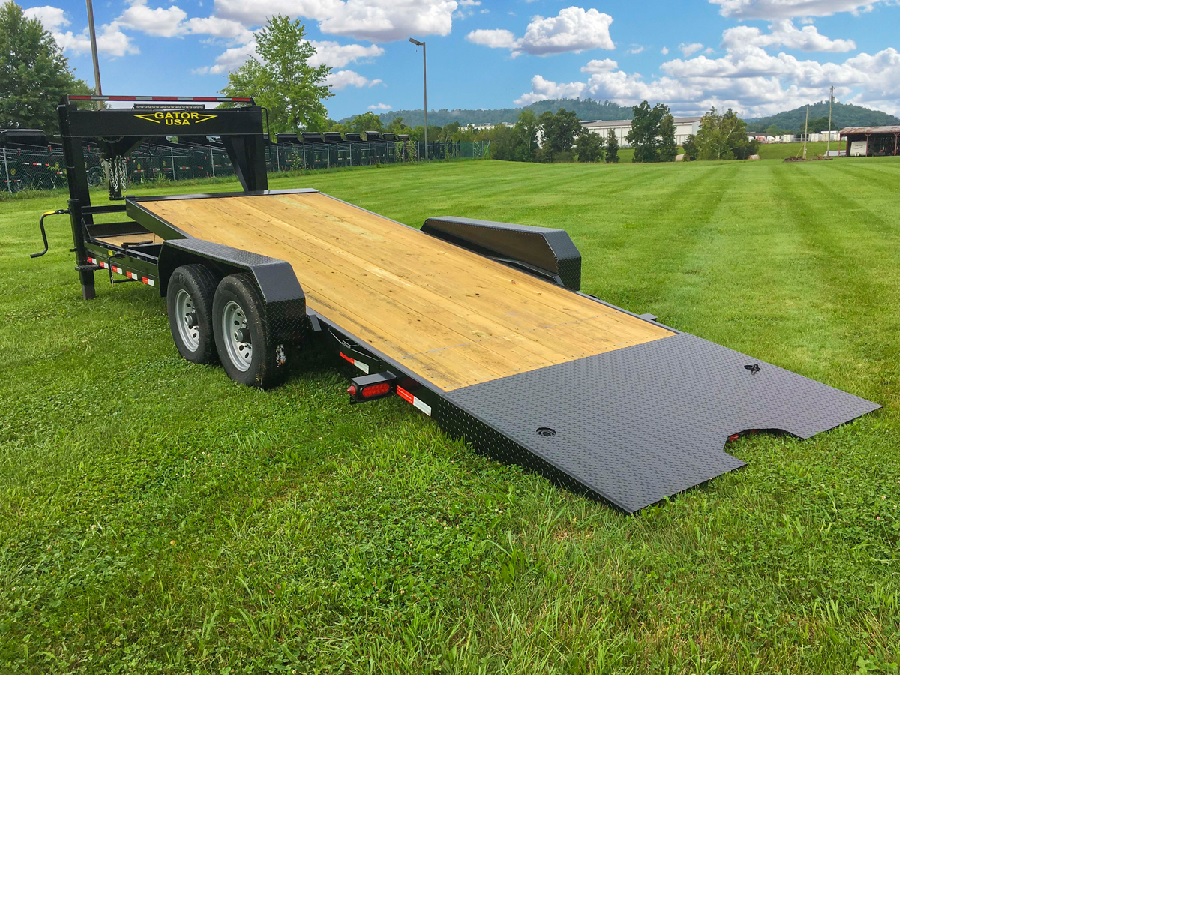

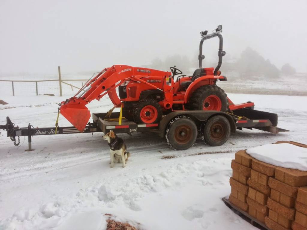

What kind of tilt deck? If it's a gravity tilt, they pivot right "between the rear axles"
Not sure what kind of trailer you have Fallon but my tilt bed trailer has the pivot point about 2 feet behind the rear axle. Mine has an 8 foot fixed deck in front with 15+ foot tilting rear deck.
My old 16' & all the gravity tilts I looked at pivoted dead center between the axles. The ones with a small fixed deck in front of the tilting deck looked like they would balance better, but still had a fair amount of deck behind the axle compared to a standard fixed deck trailer. I looked at Diamond C, Big Tex & several others. Every gravity tilt I saw pivoted between the 2 axles.
I was looking at tilting decks with a small fixed front deck originally to replace the 16'. Lack of fenders & the ability to load non-tractor things from the side sent me to a deckover power tilt.
My 16' was way too short. I'm assuming it was for a skidsteer, but it was even pretty short for that. 14k of axle & a steel deck. The only way I could balance it was with the loader on the thankfully really long tongue.
View attachment 591255View attachment 591256
I have to agree with bitternut, my 20' tilt pivots behind the rear axle. Seems to me, pivoting between the axle's would require the bed to be higher to clear the axle.
