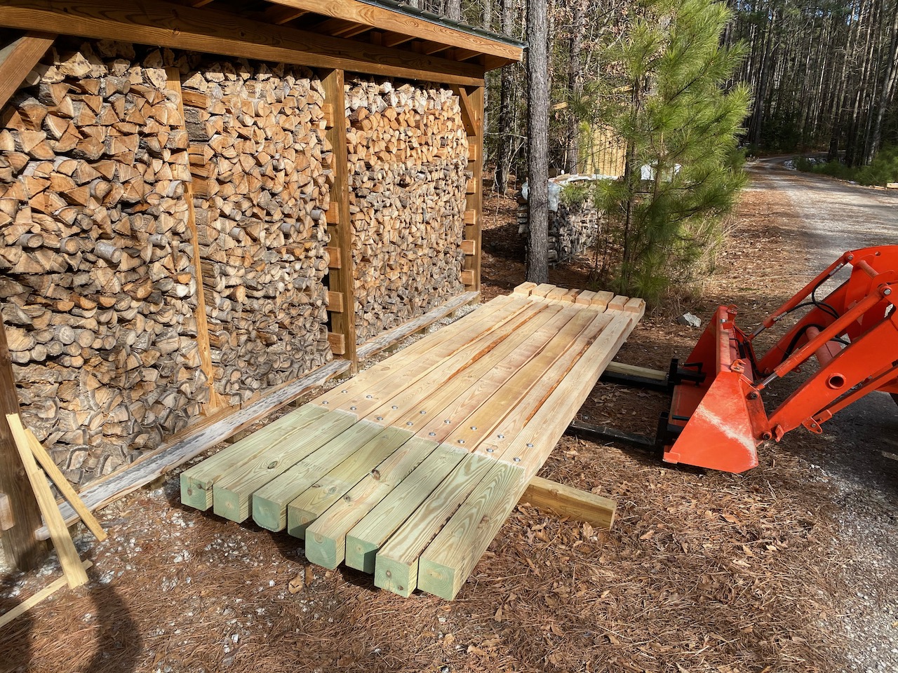

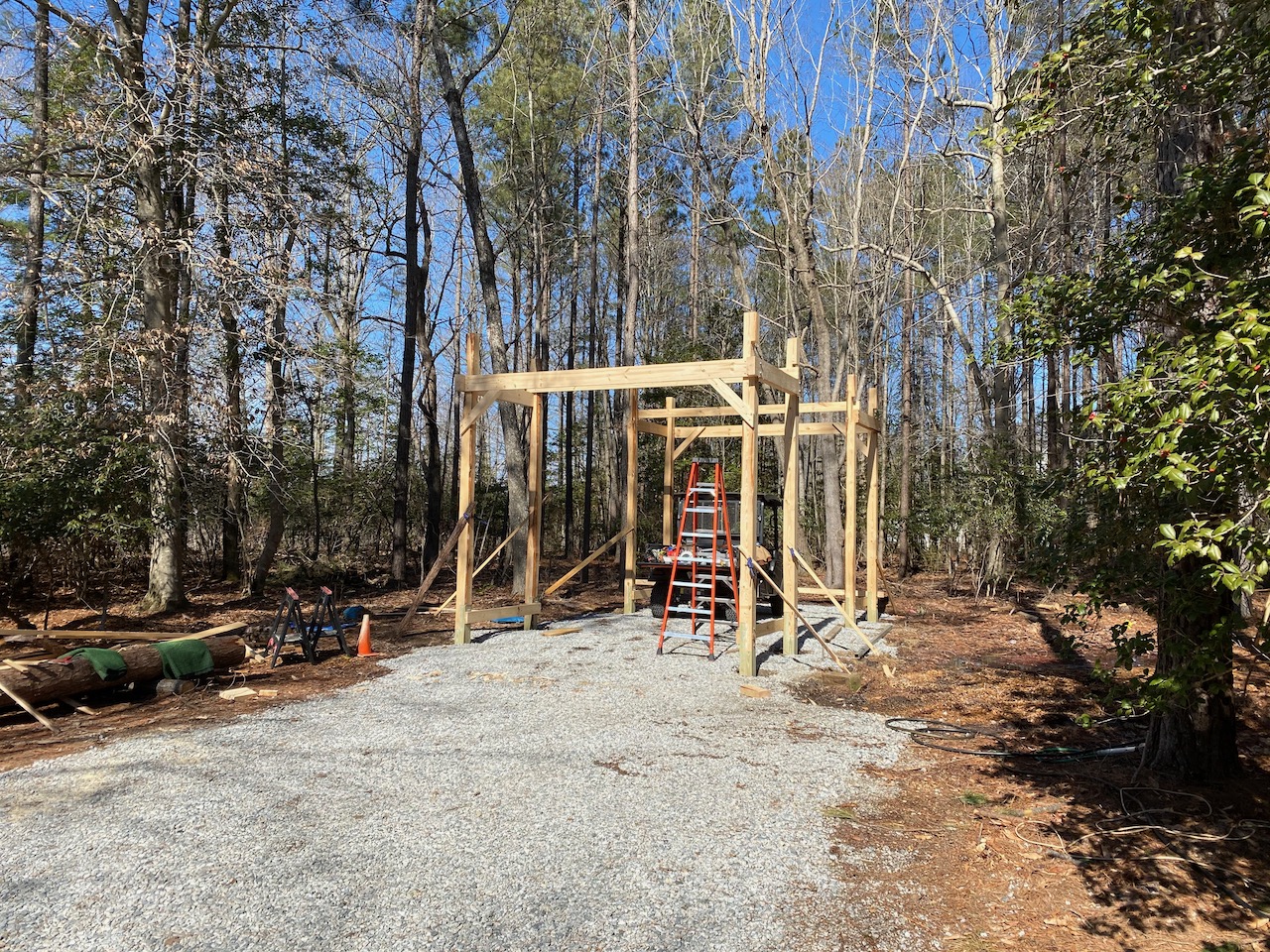

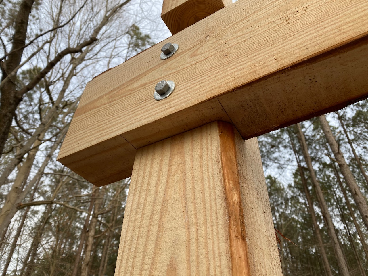

Been picking at this for a few weeks, hampered by a lot of rain and snow, but finally got to the point where I have enough pictures to start a thread. Will be 12'x21', 252 sq. feet, just under the limit to avoid a building permit and allow use of rough-sawn lumber. Posts will provide about 11' of clearance under the roof once the final grade is done. I plan to do a 4/12 or 6/12 roof with 18-24" overhangs all around.

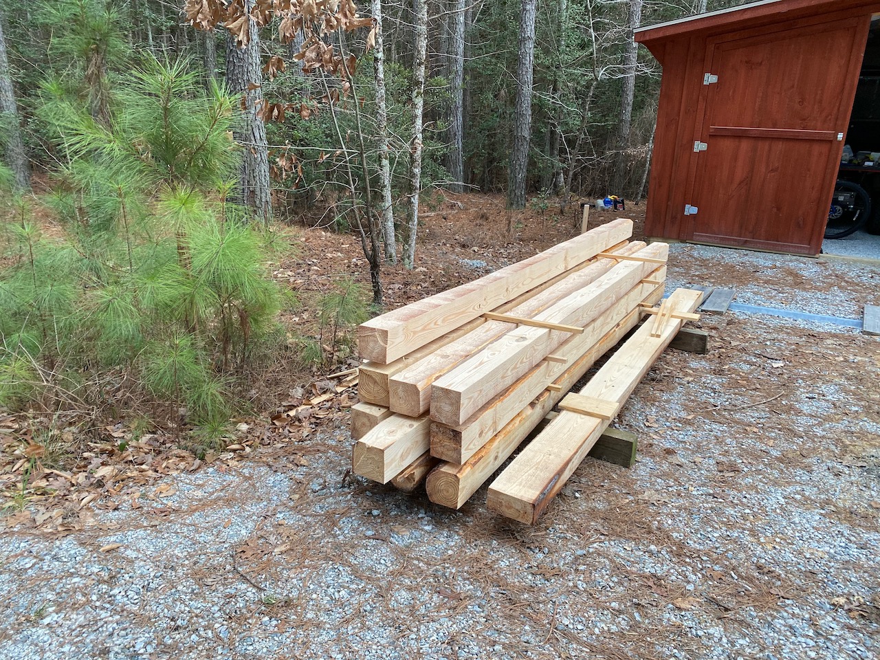

I started by milling a bunch of logs down to make posts and beams:

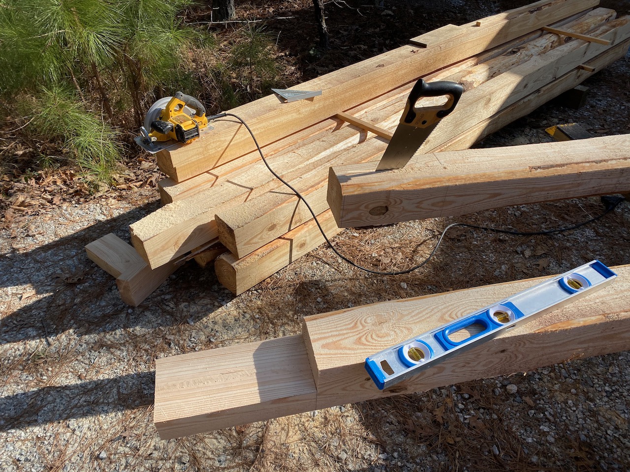

The posts got notched on the bottom and then married with a 4' section of treated 6x6 using bolts and glue. Normally I would put up the posts and then notch them for header beams, but in this case I pre-notched the beam cutouts on each post. This fresh sawn pine is real sappy and hard to cut, and I didn't want to be up on a ladder with a Skil saw this time around.
Here are all the posts ready to go:

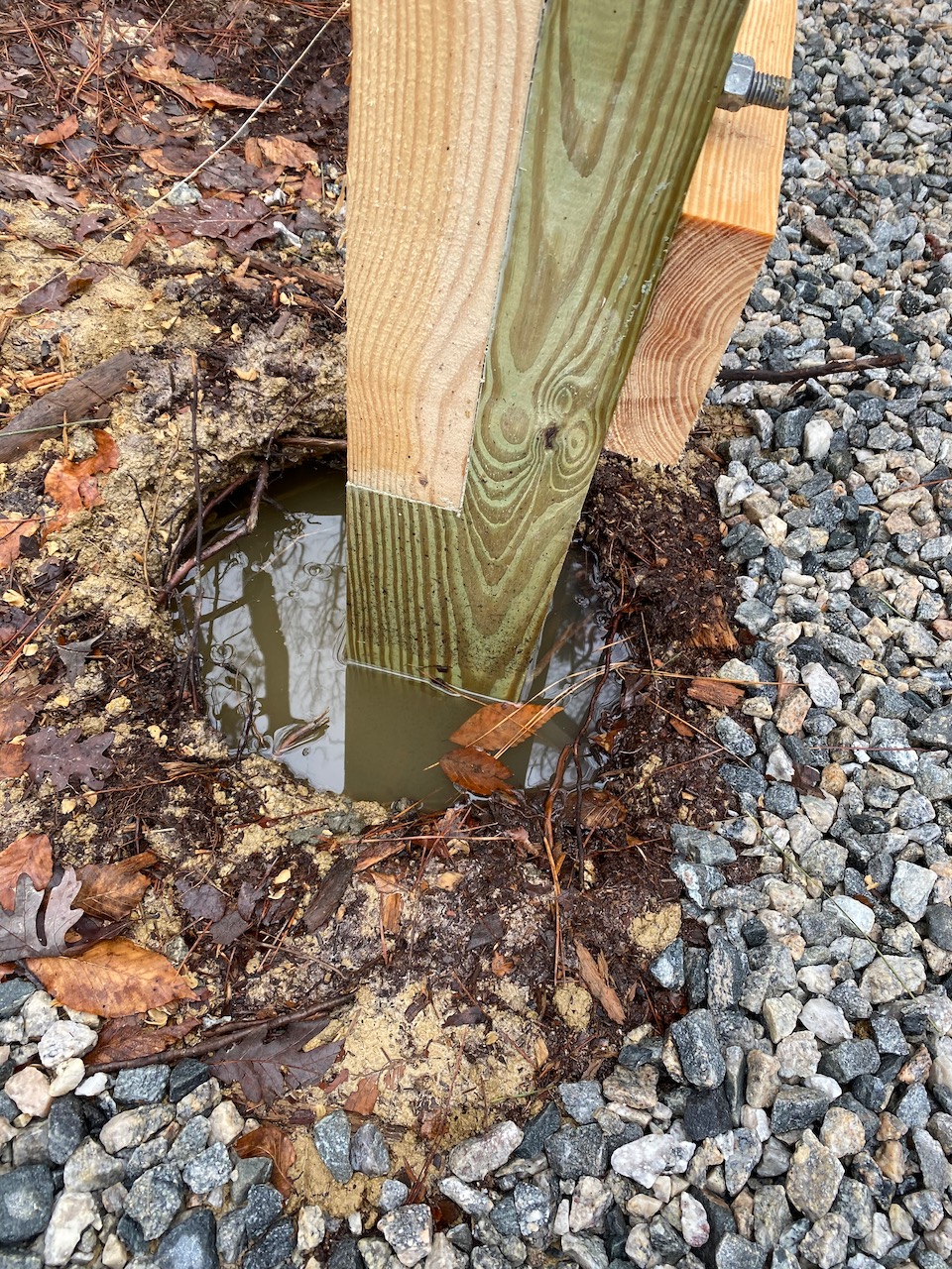

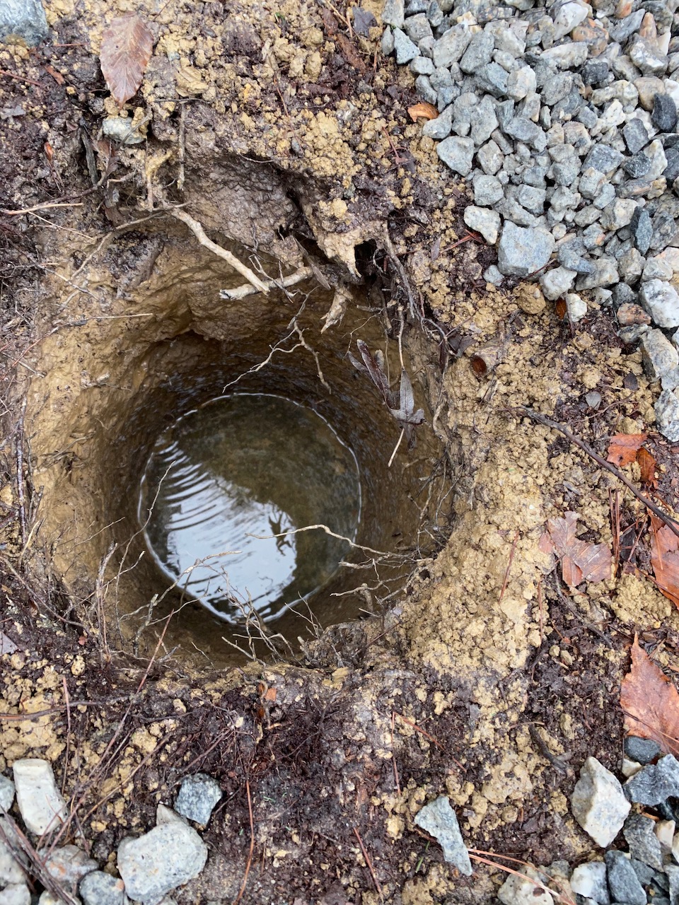

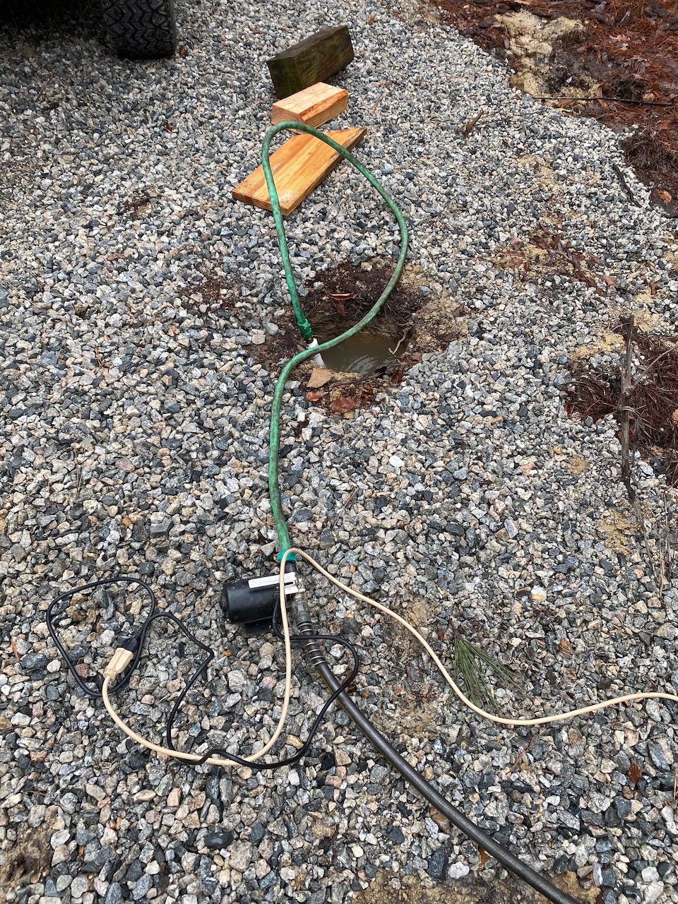

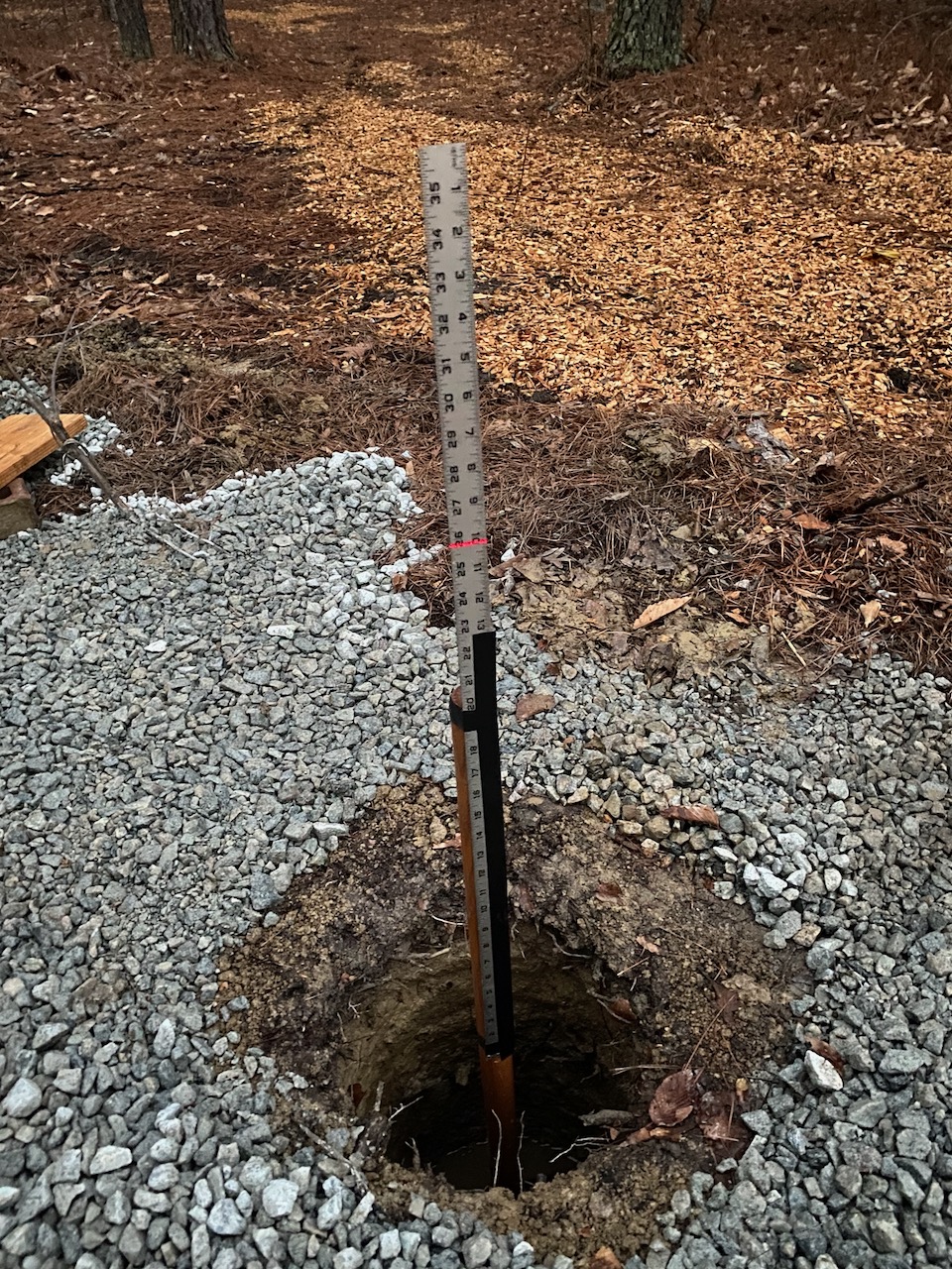

We've had so much rain and snow in the last month that post holes have been a problem. I was able to drill all 8 post holes and pour a concrete footing in each. The concrete cured under water because the post holes started filling in within hours. Before I put posts in, I have to pump out each hole and it will fill in within minutes.

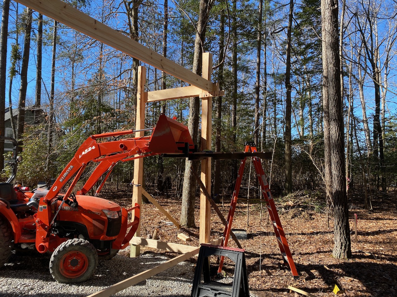

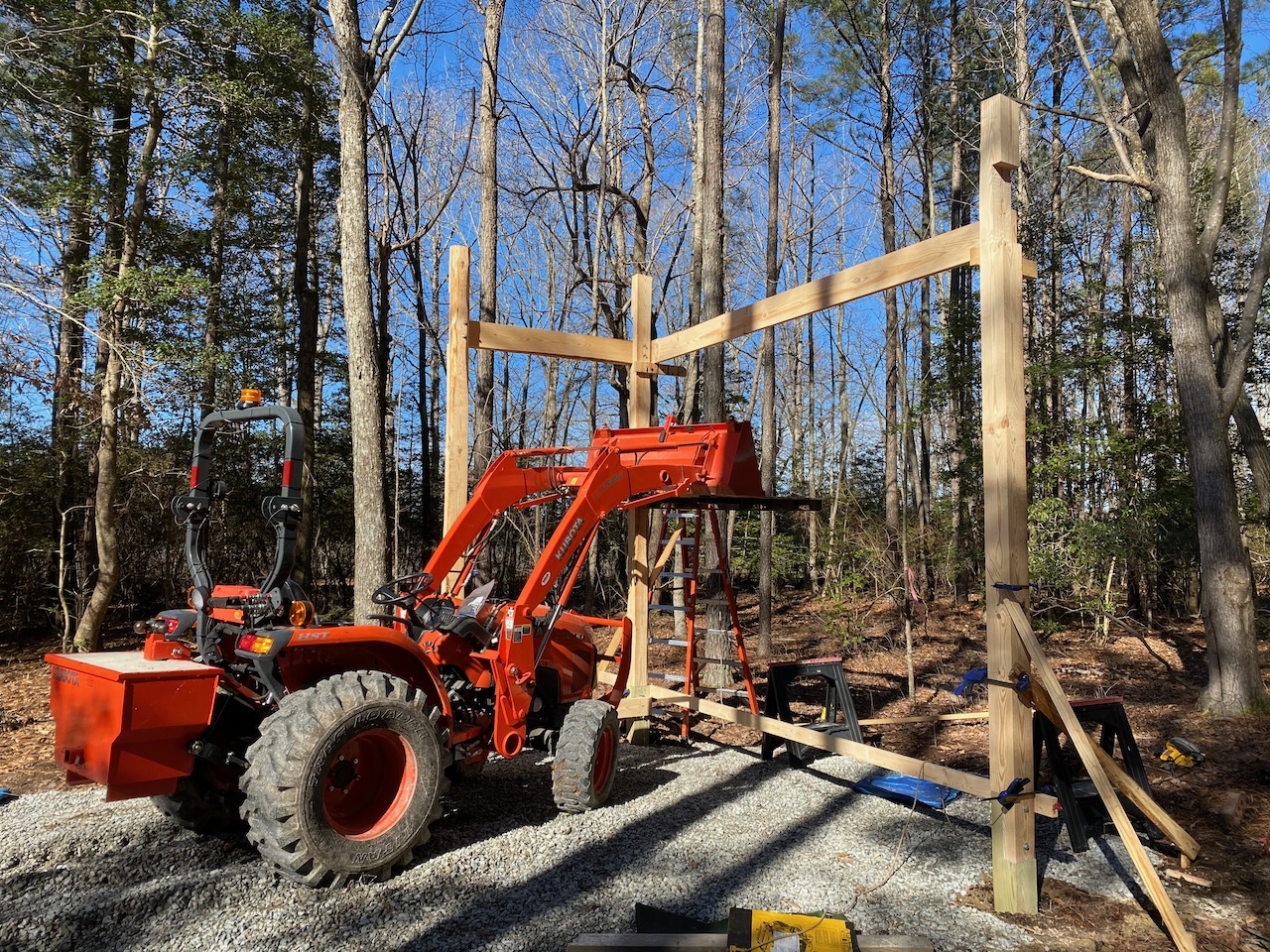

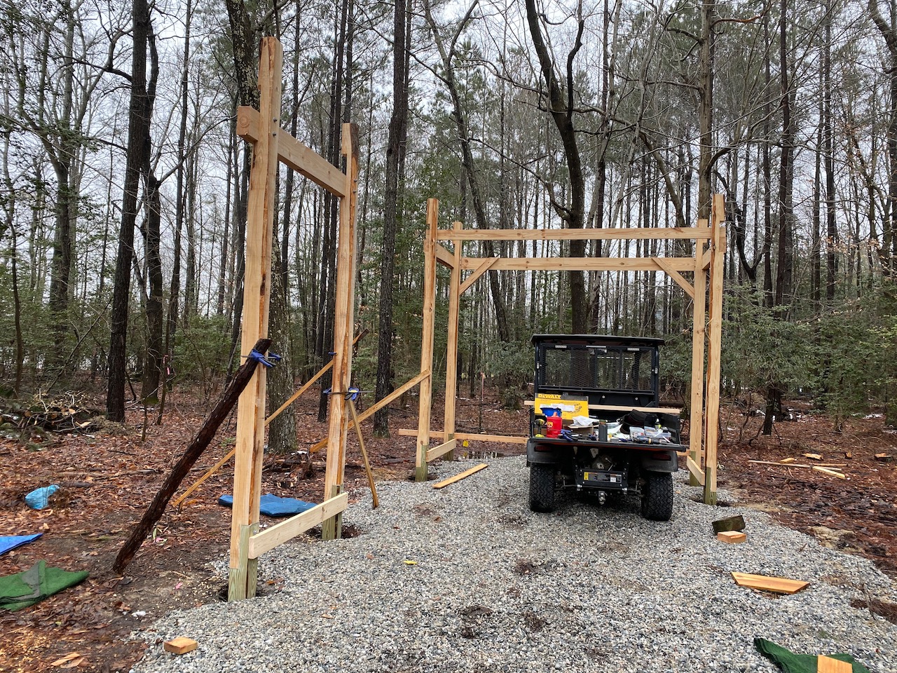

I am assembling the frame tinker-toy style, making two four-post frames that will get joined by the middle beams when complete. This lets me get all the posts square and level little by level. The tractor has been invaluable for standing up the long heavy posts, lifting the header beams, and holding up a working platform (old pallet with some extra slats) to let me reach up to the top.

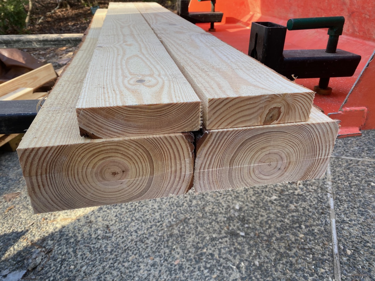

One nice thing about sawing my own lumber is that the quality is good and I can make any length I want. And of course with today's crazy lumber prices, it saves a lot of money.

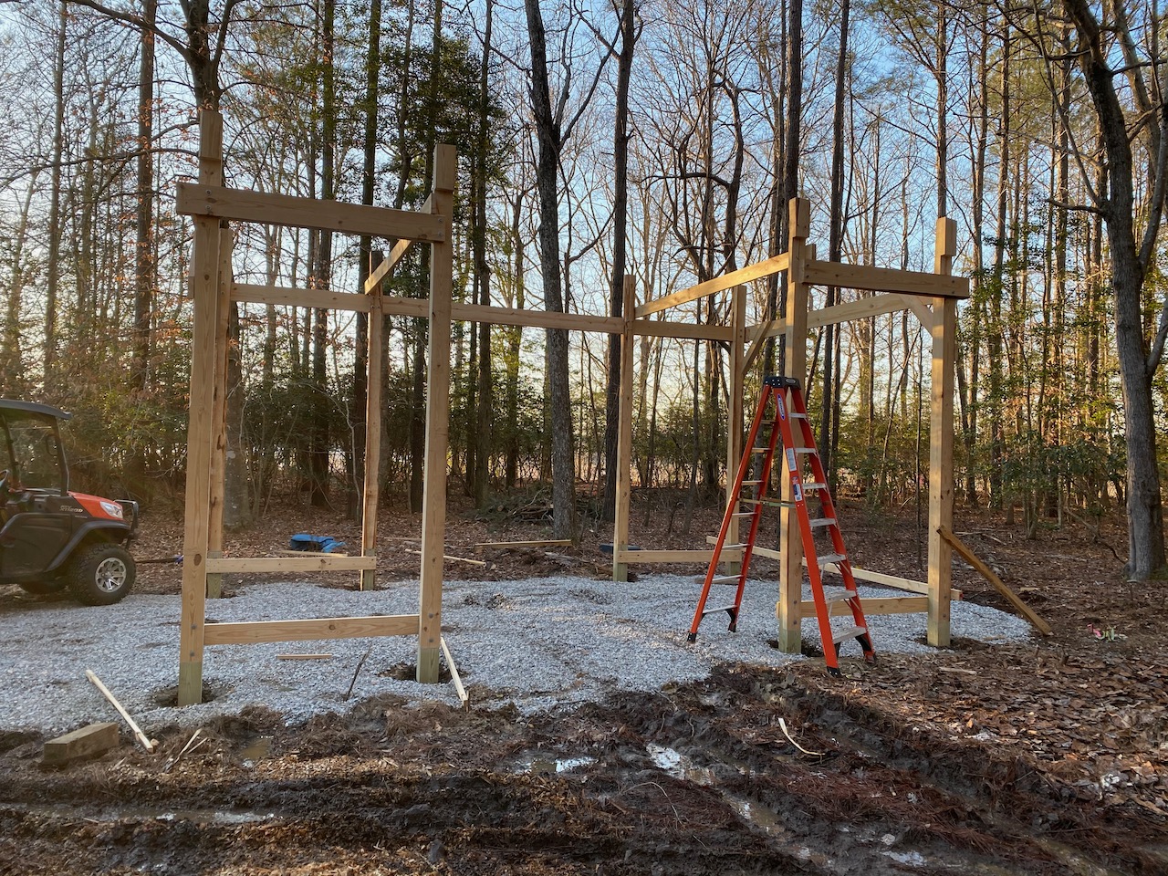

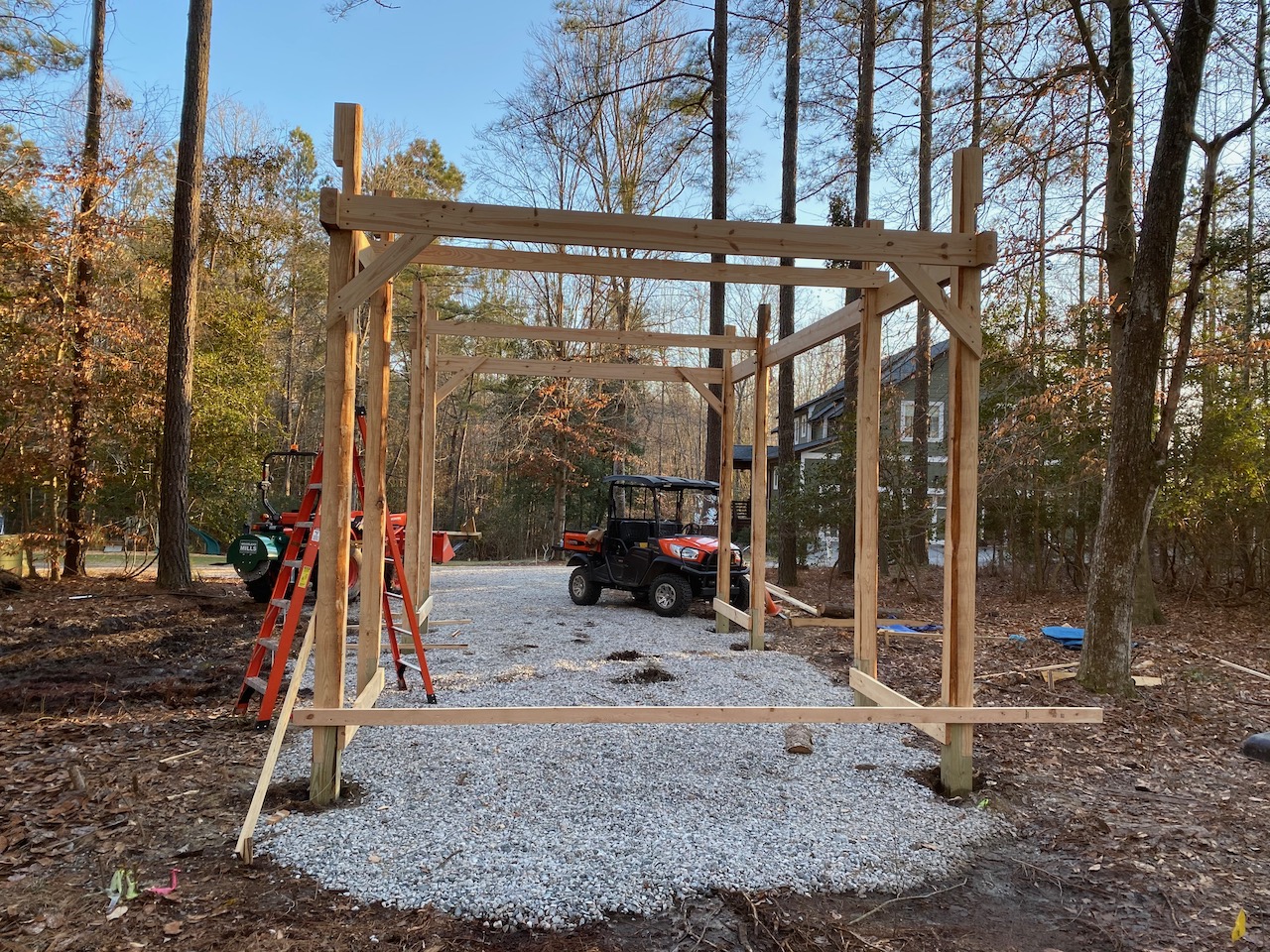

Here's the frame as of last night, before we got more rain and snow for the next couple days.
I hope to get back to it this weekend. I have one more middle beam to put up, then final straightening and squaring of the frame and posts before I backfill all the post holes. After that I'll probably finish grading the pad area with more gravel, then move onto the roof framing. Will update as more progress occurs.

What about shrinkage? If the wood is fresh cut and then milled to final dimension won't it exhibit "diameter" shrink? are you allowing for that?
/ Timber Frame Carport Project
I try to accommodate that as much as possible, but some is inevitable. For thinner lumber there is the additional concern about splitting when the lumber dries and shrinks and is constrained by fasteners. For stuff over 2" thick, splitting is less of a concern. So I mainly make sure that as the lumber shrinks it can still settle under gravity and loads.
A typical practice is to elongate/wallow bolt holes to allow beams to slip down and stay on posts as the beams shrink. I did that when I built my sawmill shed last year. But I notice that the friction of the bolts, nuts, and washers is holding the beams up as they shrink. I'd really need to go loosen all the bolts periodically to let it settle. My thinking is that with a heavy enough snow load, it will settle on its own if it really wants to. Until that point, the lumber will be supported by the friction in the fasteners and 1/2" bolts (which have higher capacity than the load anyhow). So other than aesthetics, it probably won't matter.
I would not want to build a home with green lumber -- I'd let that dry at least 6 months (1 year is best, but most of the drying happens in the first 2-3 months for 2x lumber). Home framing is too complicated to try and think about accommodating shrinkage, not to mention the effect it would have on drywall, trim work, etc.

Since you pre notched your beams how did you make sure that they were all level as the cement set?
/ Timber Frame Carport Project #11
Nice seeing you get so much use out of your saw mill!!!
#12
After the footings cured, I setup a laser level and then stuck a metal ruler (taped to a tamper handle) in each post hole and read the relative heights. That let me work out where to notch each post with about 1/16" accuracy.

For post, i'm thinking of using metal or something stuck in the concrete and set/attach the post above ground.
I've had very good results with just setting the post with crushed rock like S219 has for ground cover. Because it's crushed rock as the pole moves the rock settles in around the post and they get surprisingly tight.
I do like his idea of pouring a footing in the hole and setting the post on top of the cement though. It gives the post a good surface to sit on.
What I like about the crushed rock is that the water can drain away from the post.
/ Timber Frame Carport Project #17
"What I like about the crushed rock is that the water can drain away from the post." . . . this is it exactly mechanic. :thumbsup:
/ Timber Frame Carport Project #18
The reason I do not like crushed rock inside a hole with a post is that it gives water a place to go to. Virgin soil around the hole is harder and then inside the hole. By creating gaps inside the hole with rocks, you provide a place for water to gravitate to, and remain for extended periods of time. If there was no rock in the hole, no water would go into the hole.
/ Timber Frame Carport Project #19
I don't get this theory... maybe I live in a wetter climate, but my experience says that water gets everywhere, it doesn't matter what the texture or content of the materials are. Once the water table rises in the wet season, water is there regardless. At least crushed rock allows better drainage when the water recedes.
/ Timber Frame Carport Project #20
For drainage to work their has to be a path for water to drain. Putting gravel in a hole is just like putting gravel in a bucket. The water just sits there with or without the gravel. But if you fill that bucket with concrete, or compacted soil, then water does not go into the bucket. The gravel just allows the water to remain in a hole longer that it should never have been in there to begin with.
