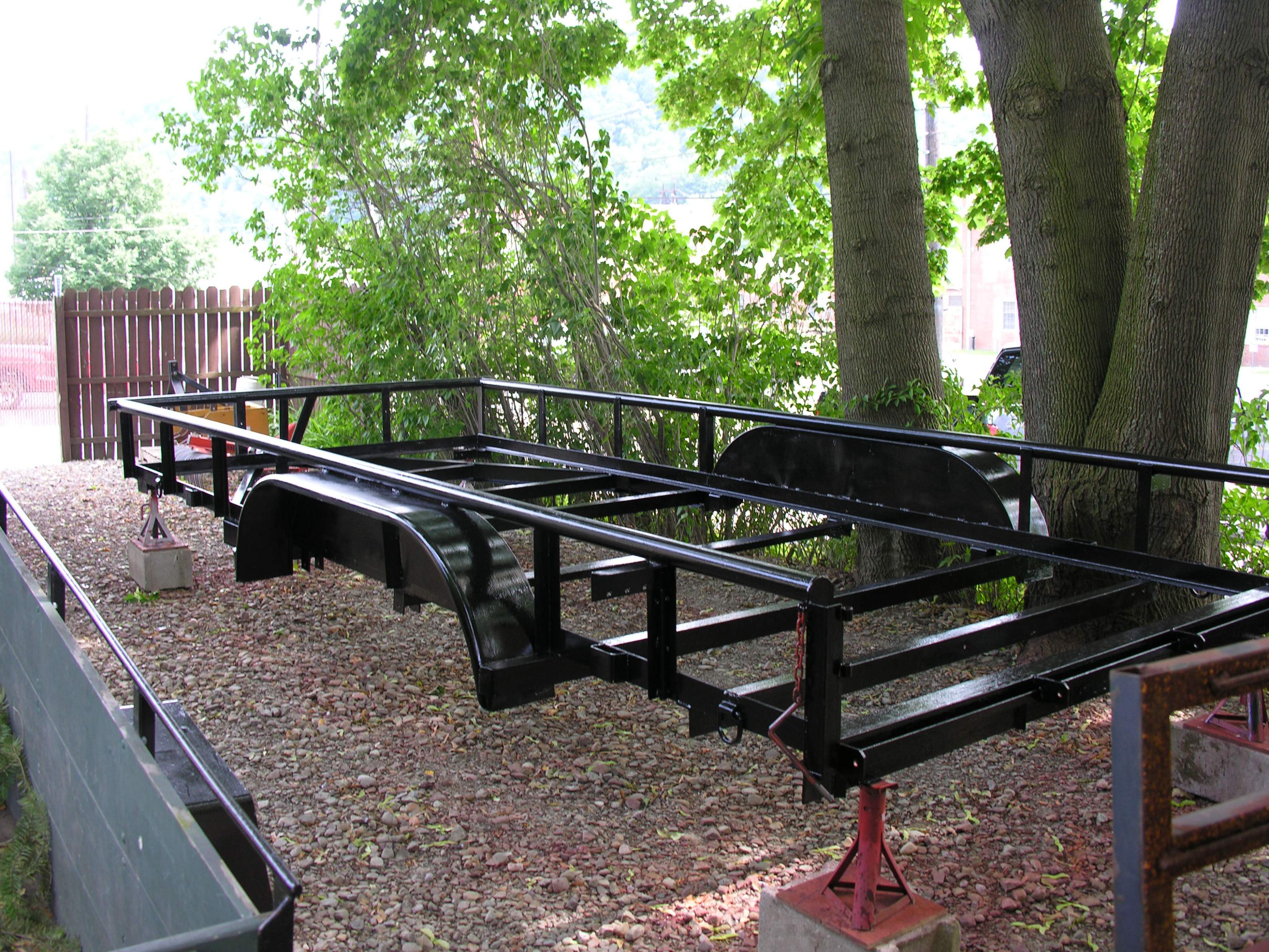

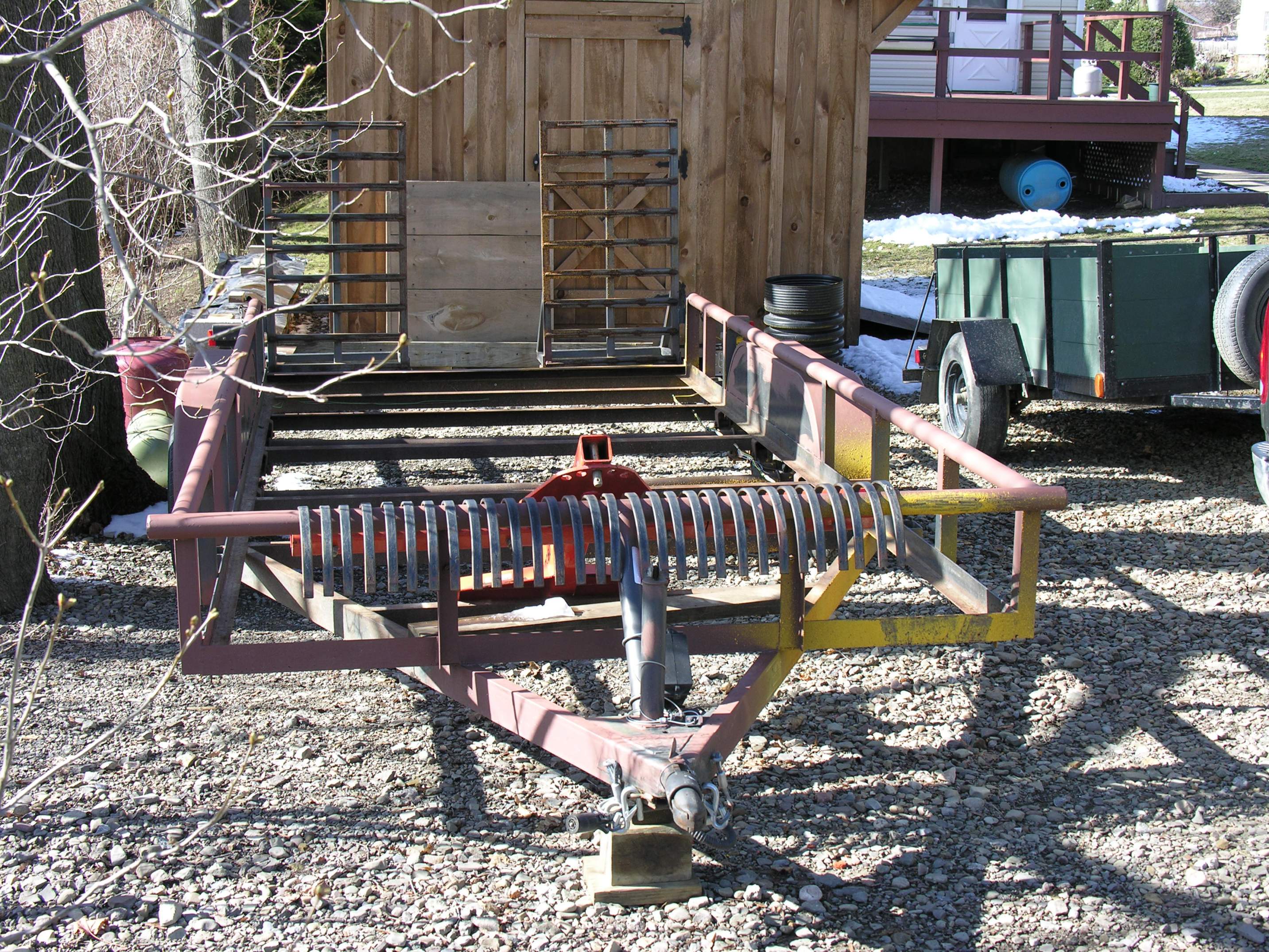

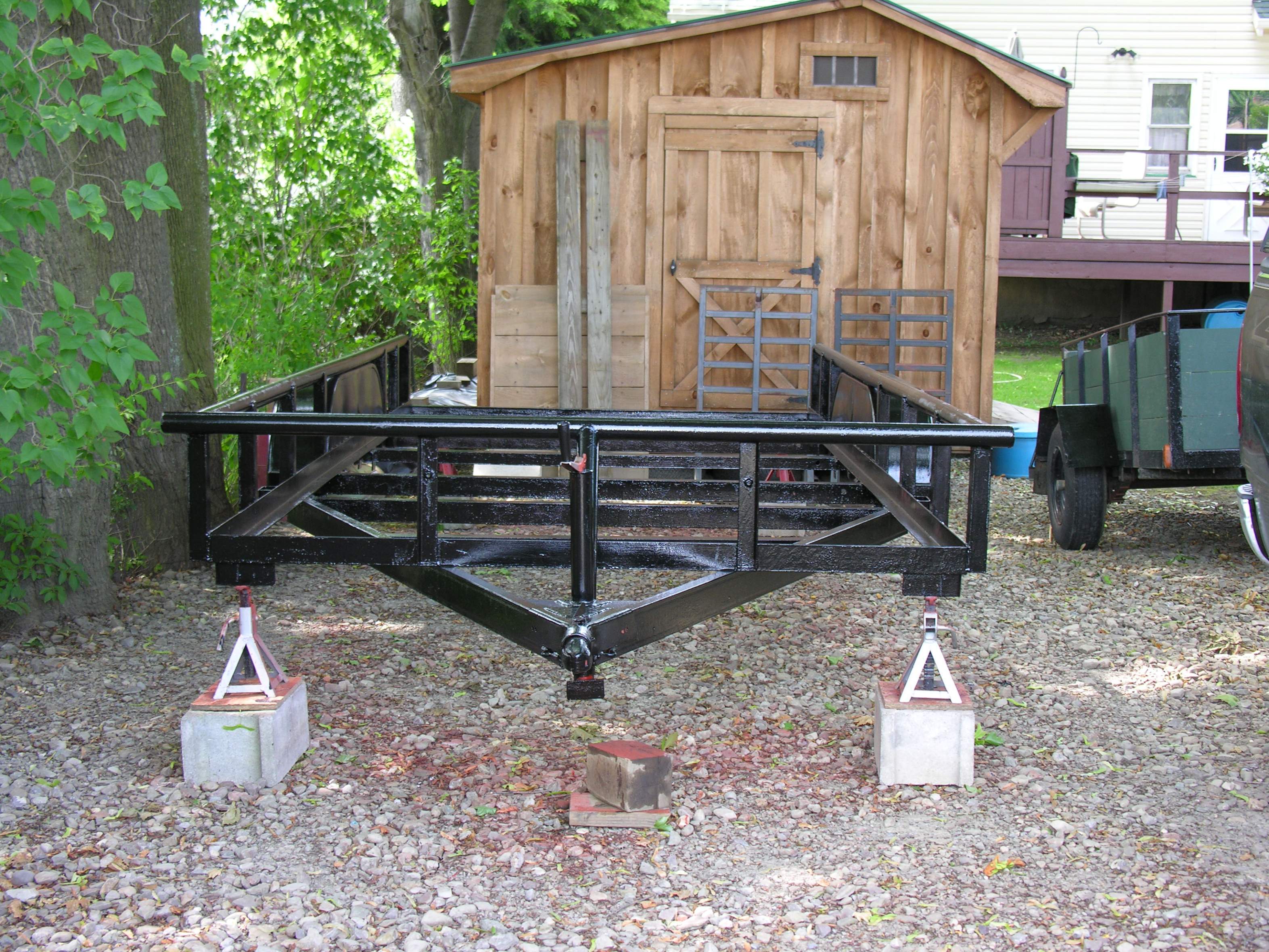

I am in the process re-decking my 16' trailer with white oak. I also took advantage of this time to re-paint the frame and re-build the suspension.
BTW I really have no problem with the deck screws. If they don't come out, they break off and then I grind the surface even.
