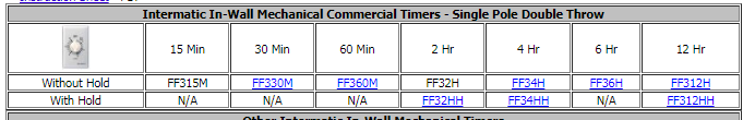

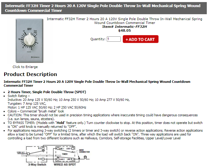

OK found a spring powered timer that has a SPDT (Single Pole Double Throw) switch. In the Jpeg below,it's called a 3-way switch.
Here are the choices as far as set time. You have your choice of a timer with a hold function and timer or just the timer function.
Here is the link to where I found this. You may find other sellers with a search for the timer you want:
You would want to wire the on/off switch on your engine so that one of the wires goes to the timer switch. I have not looked up you engine yet, but it should be clear what wire to use when you see how the on/off switch is wired.
You will want to put the timer in a weather proof box of some sort.
Richard

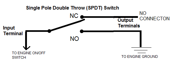

The best way for you to see how this would work is to buy one of these timers and then play with it a bit.
Do you have a volt/ohm meter ? If not, you will need one to see that operation of the switch.

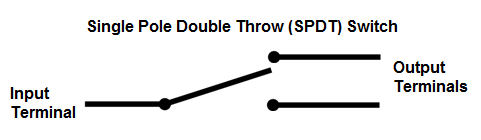

There is no "middle" position. The terminals are NO (normally Open) and NC (Normally Closed) In this illustration above, the input terminal is in contact with the top terminal, so that would be the NC connection.
In your application, you would connect the input terminal to the wire that goes to your engine on/off switch. You can leave the engine on/off switch wired as is, just connect the input terminal to the same wire.
Then the bottom terminal would be connected to the engine ground.
When you set the timer, lets say for an hour, when the hour is up, the contact will switch to the NO terminal and stop the engine.
This should give you and idea on how to wire up the timer.
Richard

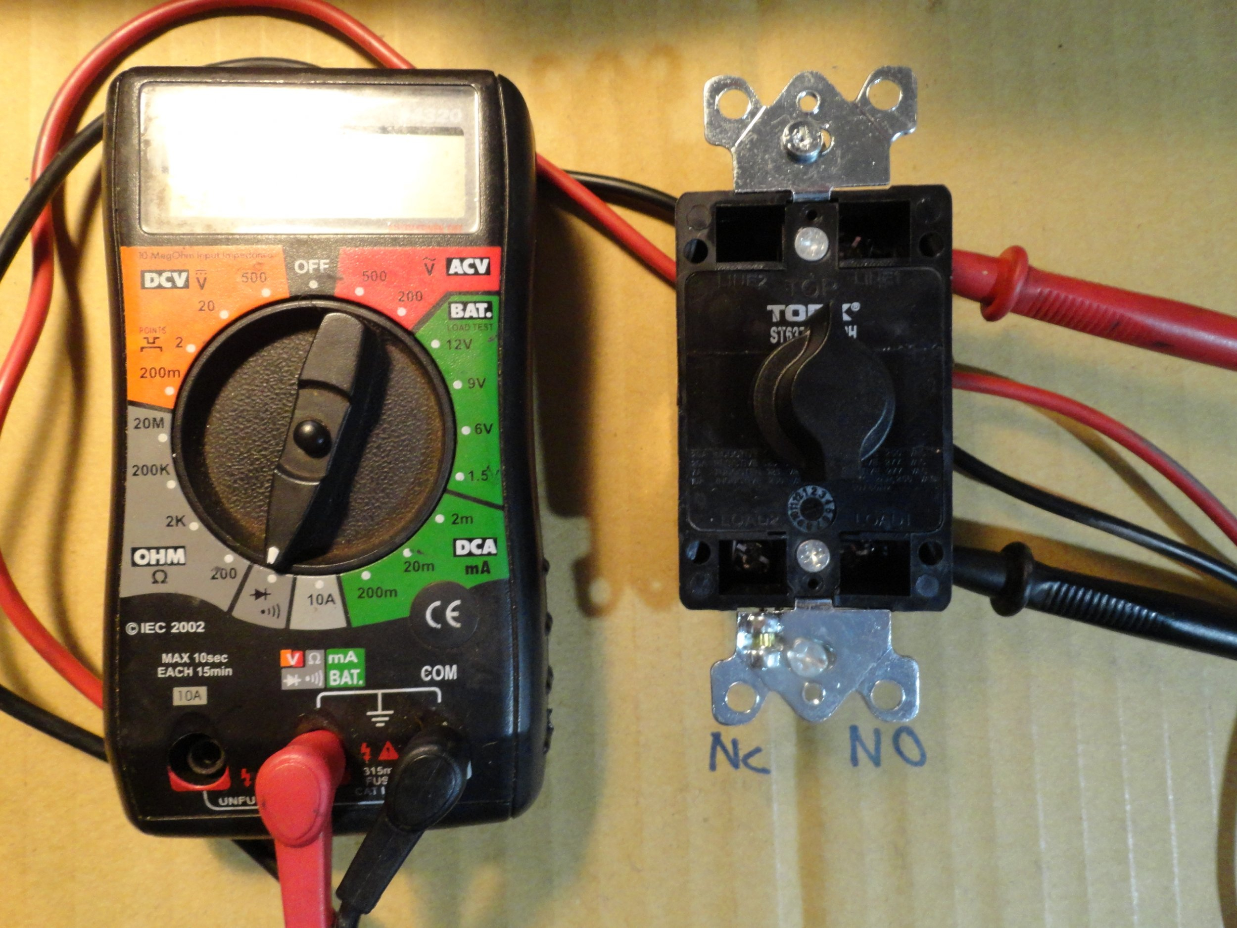

Got a SPDT timer..Might be wiring up wrong , got the V/M on buzzer

Got the SPDT timer ; Might have it wired wrong , have V/M set on buzzer, (Red on line 1) (black on NO ) as shown when timer goes 0 no buzz ? any sugg. thk/u, gus..

OK I'm not sure why you are using the diode test feature of your meter for this experiment.
Set your meter to the ohms position and to the lowest ohm number. On your meter, that would be the 200 position. After switching the meter to the 200 ohm position, short your meter leads together to see what kind of reading you would expect when the switch makes the connection during your test.
I also don't know how you have determined which terminal is NO and NC.
What model switch did you buy?

Model is Tork , (attachment instr.) wired up (instr, are noted NC-NO ) still when timer goes 0 no Ohm reading as noted when shorted ?

Also Why won't buzzer on meter activate on test? thk/u. gus..

Try this, with the timer is at zero time, set your meter to the 200 ohm position, with one meter probe connected to the Line 1 terminal, then touch the other probe to the to the load 1 terminal and then touch the probe to the load 2 terminal. One of those terminals will result in an open condition, i.e. no reading on the meter.
Do you have a friend or a co-worker who can help you with this ?

Yes ,Load 2 has a reading , load 1 no reading- open. thk/u
