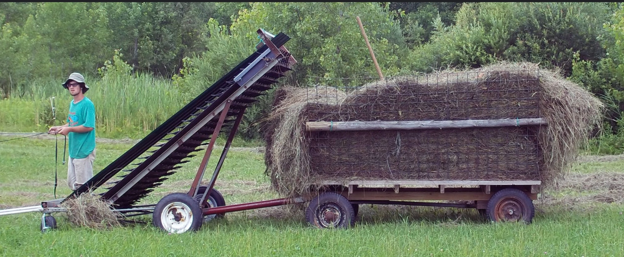

…but back to handling and storage. For more years than not, hay wasn’t baled. Putting a string around it was only because it reduced the amount of time and labor to move it from field to barn. The conversion to round bales handled by diesel power has reduced human labor more.
Look at what some Amish do using 1 or 2 horsepower to get hay to the barn. Found this picture on the internet:
   / Tiny tractor hay. #5
This is how we did it with single cylinder 15hp diesel tractor.
Sickle Bar mower and Hamster collector for grass, hay and straw...
When I was not driving I was firmly attached to fender seat.
Previous to the Hamster it was tractor pulling hay wagon loaded with hay forks!
