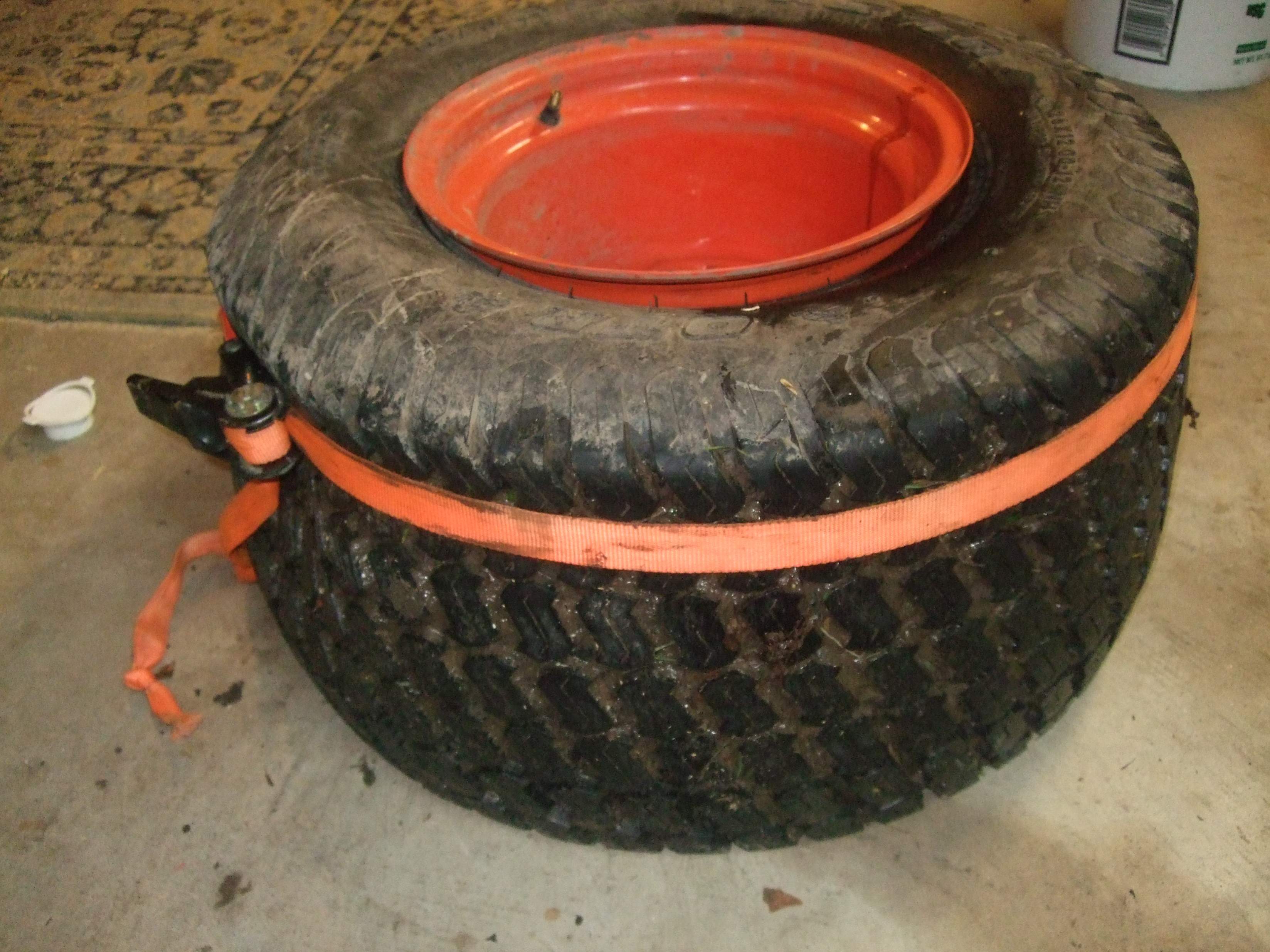

I wanted to resurrect this old thread because I beat myself up last night trying to set the bead on my ATV rear tires. I used the starting fluid method and got one of them but the other is squeezed out of shape and could not get it to go. I tried the strap, my wife as the 3rd hand (that usually no fun). I finally gave up and through it in my truck to see if my local garage could do it for me. Any good tricks for this?

As said Removing the valve stem allows for More air to the tire quicker setting the bead . Also , allthough it Might not work with all air hose Quick connects , on Mine I dont use the Air thing that goes in the end of the hose , But Slip the disconnect directlly over the valve itself It allows the air in there much quicker .
During the winter months I also use a torpedo heater to heat the tire as well as soften the rubber .
I also use a cable come along around the outside of the tire . On a really big tractor tire I,m not sure this would even work , But I haven,t had to change any of them . Its worked for Me for years , on Big truck tires & Medium to small tractors . Bob

I a couple of weeks ago with an flat atv tire and used a small bike tube inflated in the bead to to stem the air flow and it got pushed out when bead started up to seat. and sealed i had tried the ratchet strap trick but it wouldn't move out
of drop center area. I'm too chicken to try the ether trick after braking a hand mounting a trailer tire with air tire 12 years ago.

This is what I have done with all the mounts that won't take with air. I always use soapy water and slop it around bead and rim take the valve out of the stem strap the tire. Give it a full shot of air with out the air chuck (just use the coupler) push it on the air will come out. If that fails I soap it up again and hit it with starting fluid. With the valve out I haven't messed up a tire yet. Oh ya don't put your finger over the stem!!!!! Have the air chuck on and put some air in and than put the valve in. I have had to use starting fluid about 5 times large and small tires. When all else fails this has worked every time. Learned this from someone who has set hundreds of tires this way.
