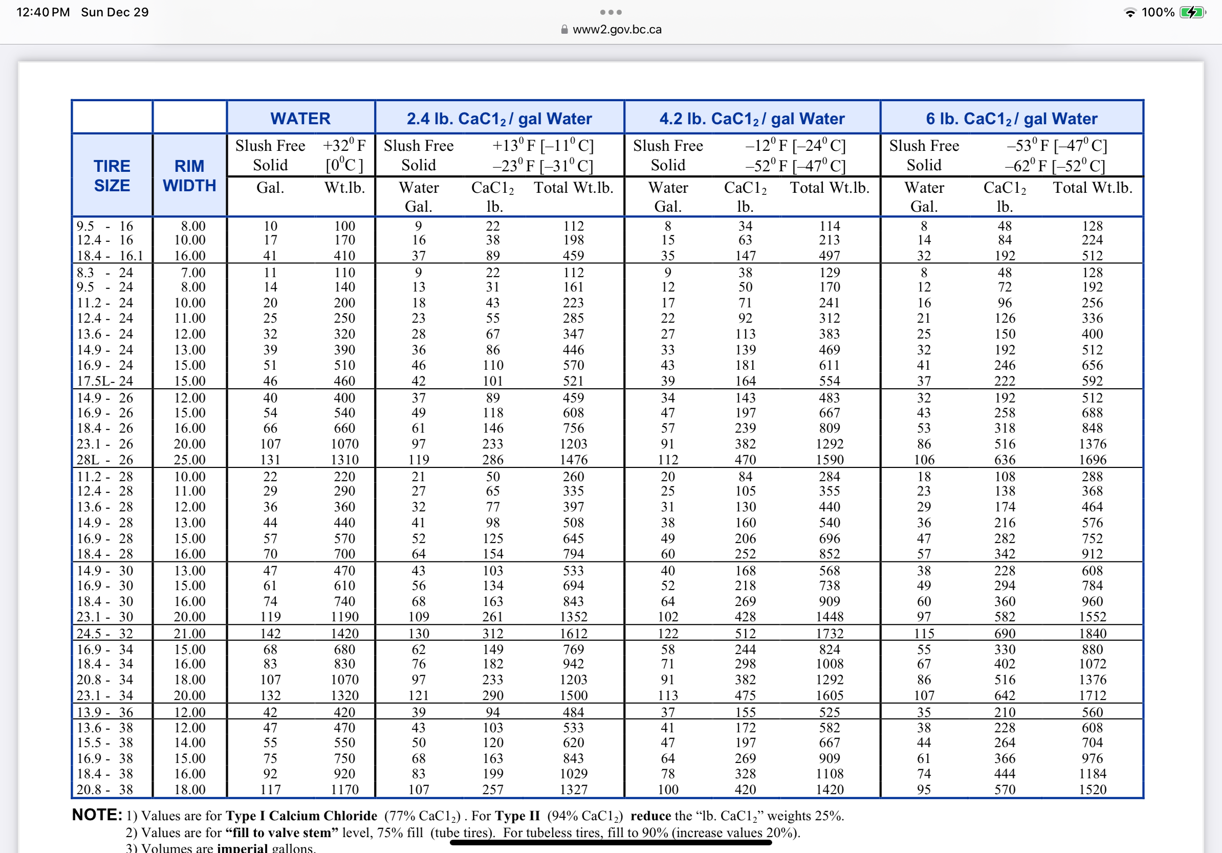

Something isn't right with that chart in your link.
It says 10 gallons of water weighs 100 pounds.
10 gallons of water weighs 83 pounds.
That chart is in imperial gallons.
/ What a Mess! #28
OK, Rimguard weighs 12.84 lbs. per imperial gallon; 10.7 lbs. per U.S.A. gallon.
That makes CC weighing 4 lb.s more than Rimguard according to the Canada chart.
