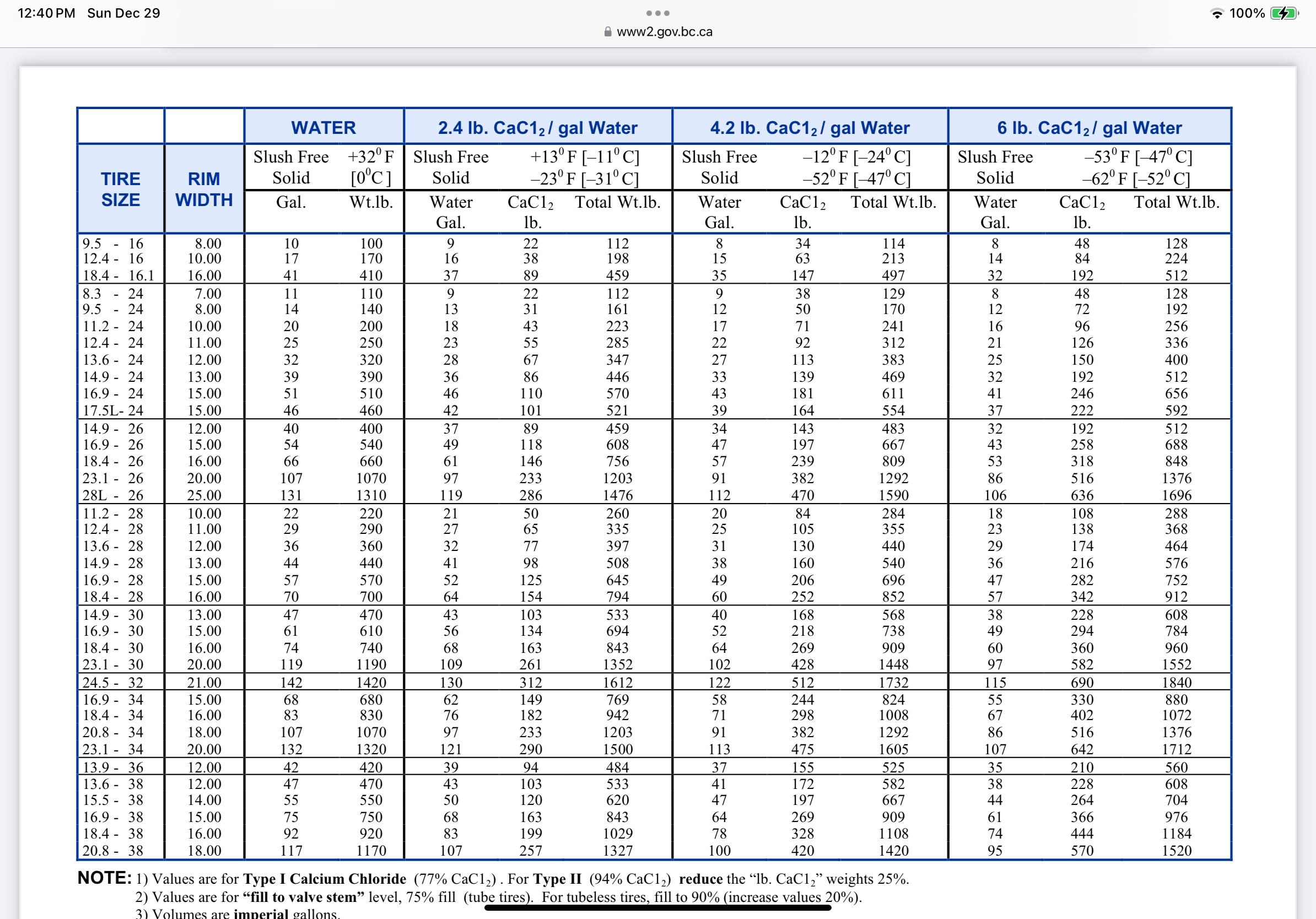

Remember, beet juice is non-toxic vs. antifreeze. If you have livestock or even pets, they can be poisoned by consuming liquid ballast from a tire failure.
I had a rock put a tear in a rear tire. Fortunately I noticed right away and was able to quickly get parked with the hole skyward. I only lost a couple of gallons out of 50. Tire service came out same day. They recovered the fluid into a barrel and performed a repair with the biggest tire patch I've ever seen! Then installed an inner-tube, and pumped the fluid back into the tire.
Anyway, imagine 50 gallons of tasty poison on the ground with curious livestock hoovering about. Just another factor to consider.
