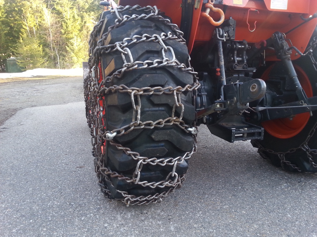

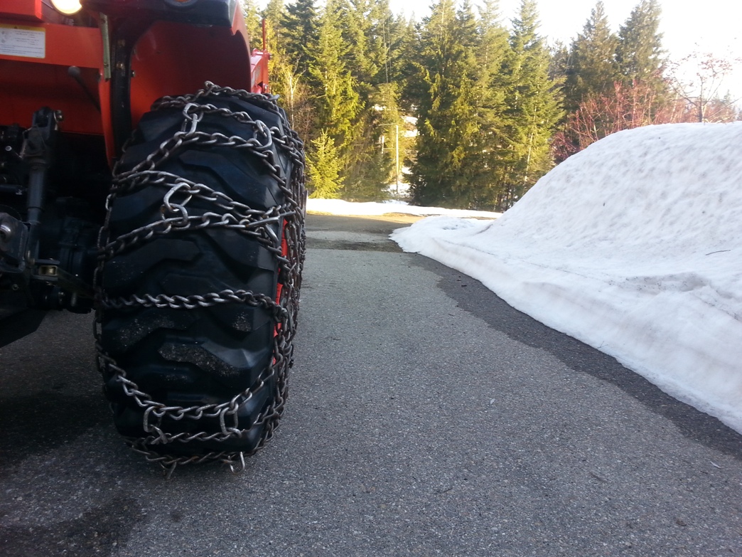

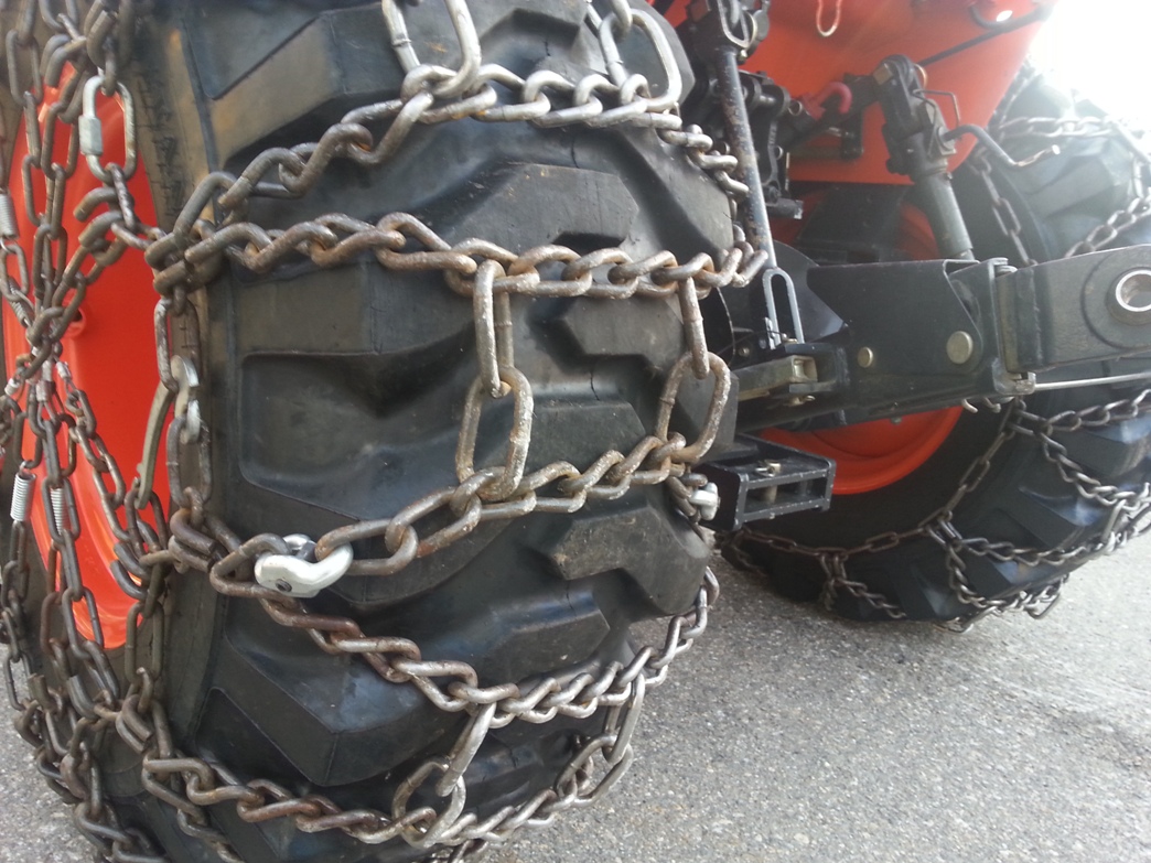

After two years of fiddling (and no spacers), I think I finally have fitted my chains so I can be confident there will be no interference. My first step was to modify the DUO patterns as shown in this thread:
http://www.tractorbynet.com/forums/...ed-modifications-post3207502.html#post3207502
and this year I (think) I eliminated the final problem of chains shifting due to the end gap by adding one more DUO pattern:
Old end gap:
New end gap:

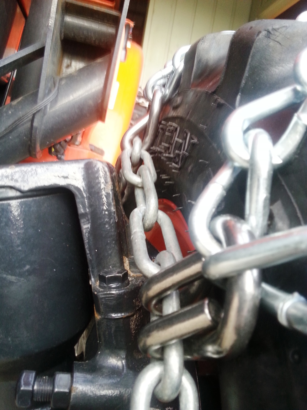

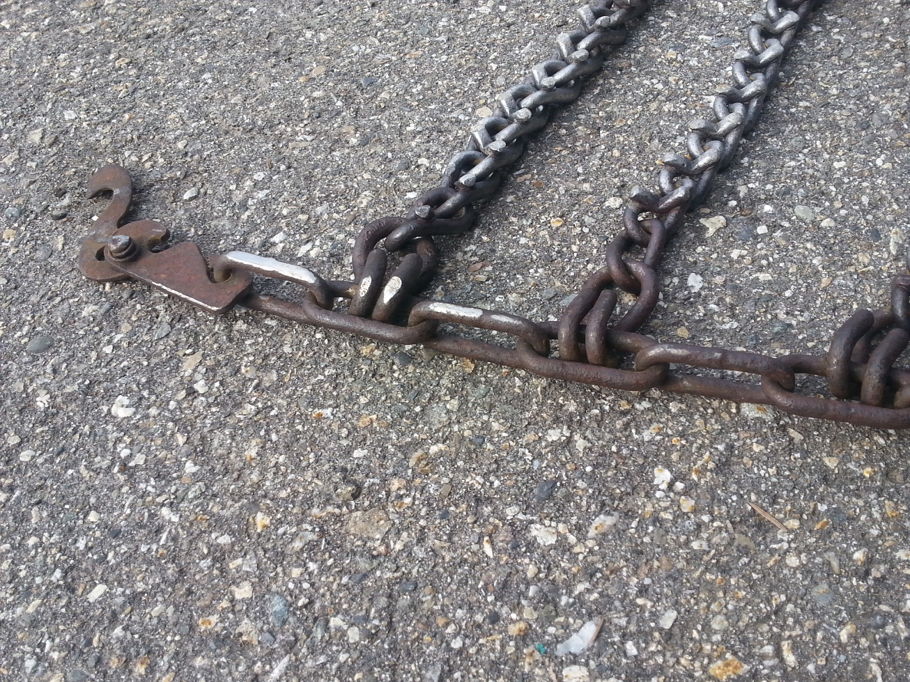

I had trouble with my DK35SE front chains this winter when a bungee tensioner broke, the chain shifted, and I failed to notice until I got home. It wore a couple of links as shown here:
They worked OK since but I resolved to make them fit better. However, some cross chain link welds are starting to separate so I decided to replace them. I got H-pattern(a denser DUO-type pattern) from CanadianChains.com.
H-Pattern Regular Link Heavy Duty - Small Tractor
I thought they might work because they use the same size, 7mm, components as the 2-link ladders I have now. I thought the H-pattern would keep them more centred and higher on the tire. I was mistaken:
A clearance issue arises because the 4-link H-pattern places the side chain closer to the centre of the wheel and the bevel gear housing. The clearance is that tight, but manageable with the 2-link ladders.

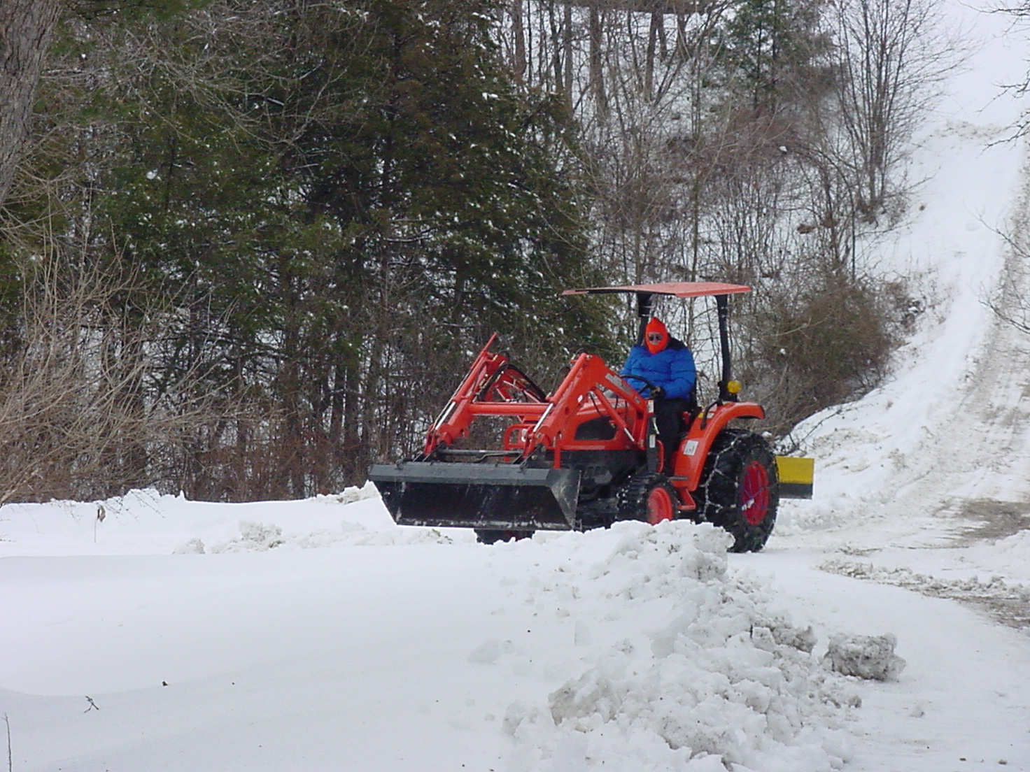

Out plowing snow today, and the inside chain adjuster lever lock do-dad managed to snag the ROPS support and it wadded up the lever lock adjuster. I took the chains off and finished without them. I have got to get some spacers for next year.

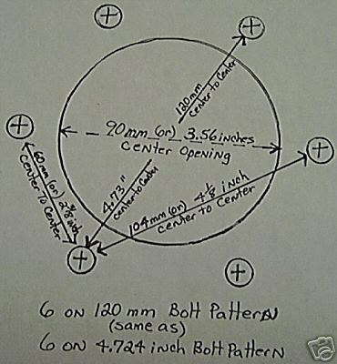

As noted above, the fronts are even more challenging, if not impossible, to safely fit chains without spacers. I ordered 2" front spacers from Bro-tek. They should arrive around March 16. I have heard good things about them and Richard is great to deal with. The 2" front spacers and all bolts/nuts are $290 including shipping. I suppose rear spacers would be in the same ball park.
Richard sent me a smaller CK bolt pattern as a guide to send measurements plus instructions for mounting the spacers when they get here. I've attached those to this post. They may help in your search for spacers.
View attachment KCO 16mm Wheel Spacer Instruction.pdf
As OldPilgrim said MotorSport-tech also has a good reputation. I sent them an email but did not receive a reply. Since Bro-tek also has a good reputation and is in Canada (which avoids shipping/customs/$ exchange complications) I ordered from them. The $ exchange rate might work in your favour.

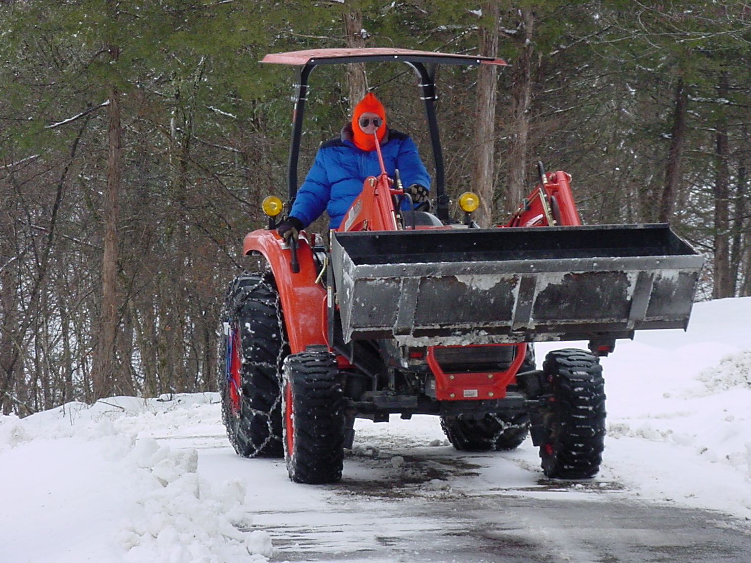

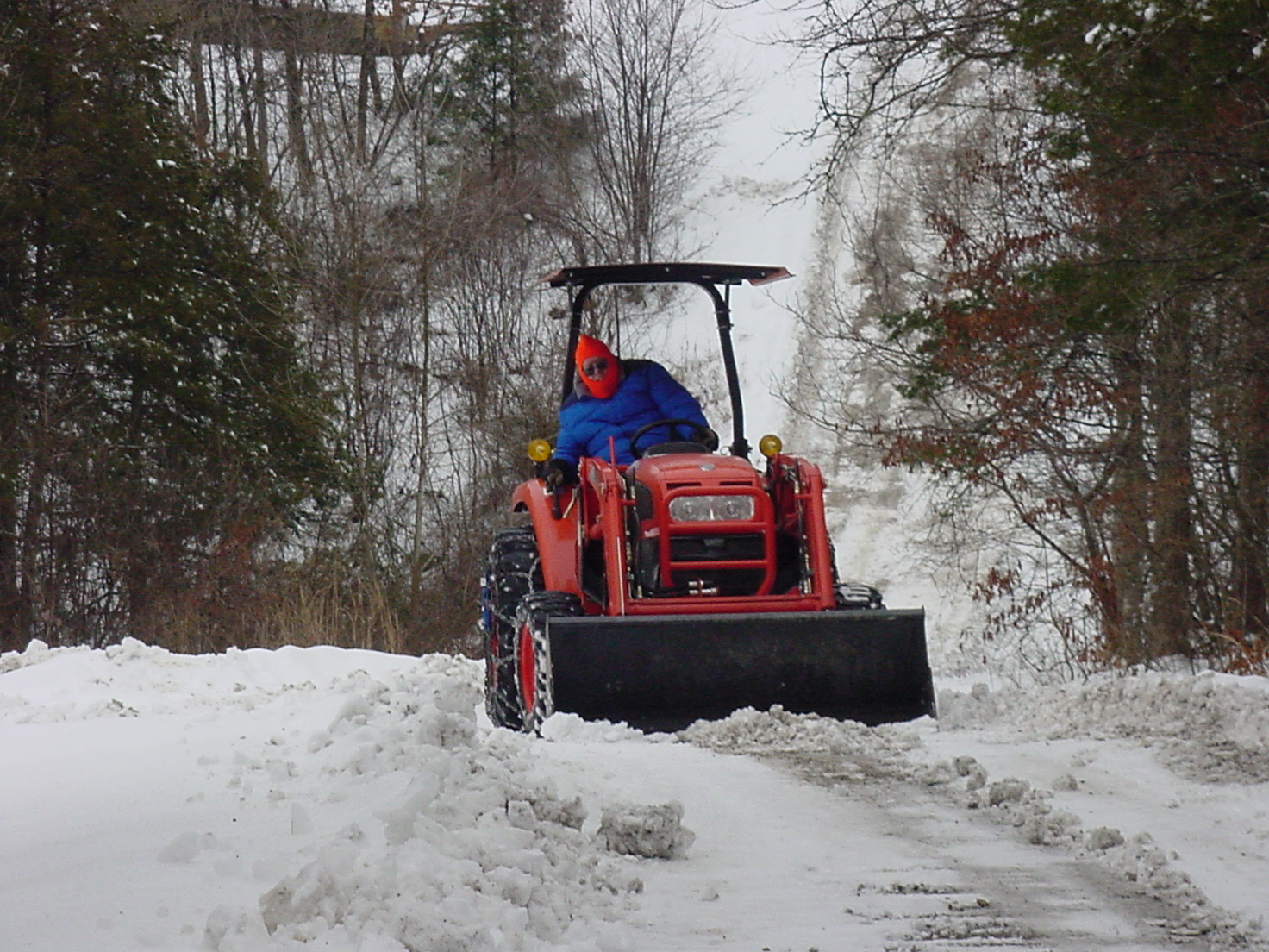

kco, I am really hoping that we are done with the snows this season. and I have until the fall to get the spacers and the chains repaired (shouldn't be hard).. I am not looking forward to putting on rear spacers as the tires are loaded. I think I will groove the front tires before next winter. I have the tool, and I did it to my old Kubota, but I only had one rabbit tracking snow before I traded it off to test it on, so I could not really give it a good test. But others report much improvement. I think I will give it a try.. So with spacers, and the chains back on and grooved fronts,. I will be unstoppable :D
Well with my hills, maybe not unstoppable. Oh, today also the retaining pin fell out of my rear blades kickstand and it got bent up. Just one more dang thing to fix. :mad:

James,
You look cold. I don't miss my open station tractor one bit.

The hardest part is getting out of the house. It isn't all that bad once you get going.. I have boots and gloves with Thinsulate in them, and the coat is lightweight but the insulation does a good job. It was a little cold that day, but not all that bad. I have been worse. You come in and cant feel your legs for a long time.

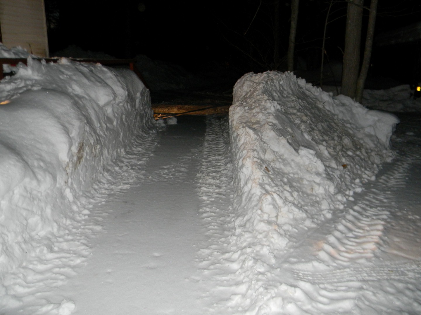

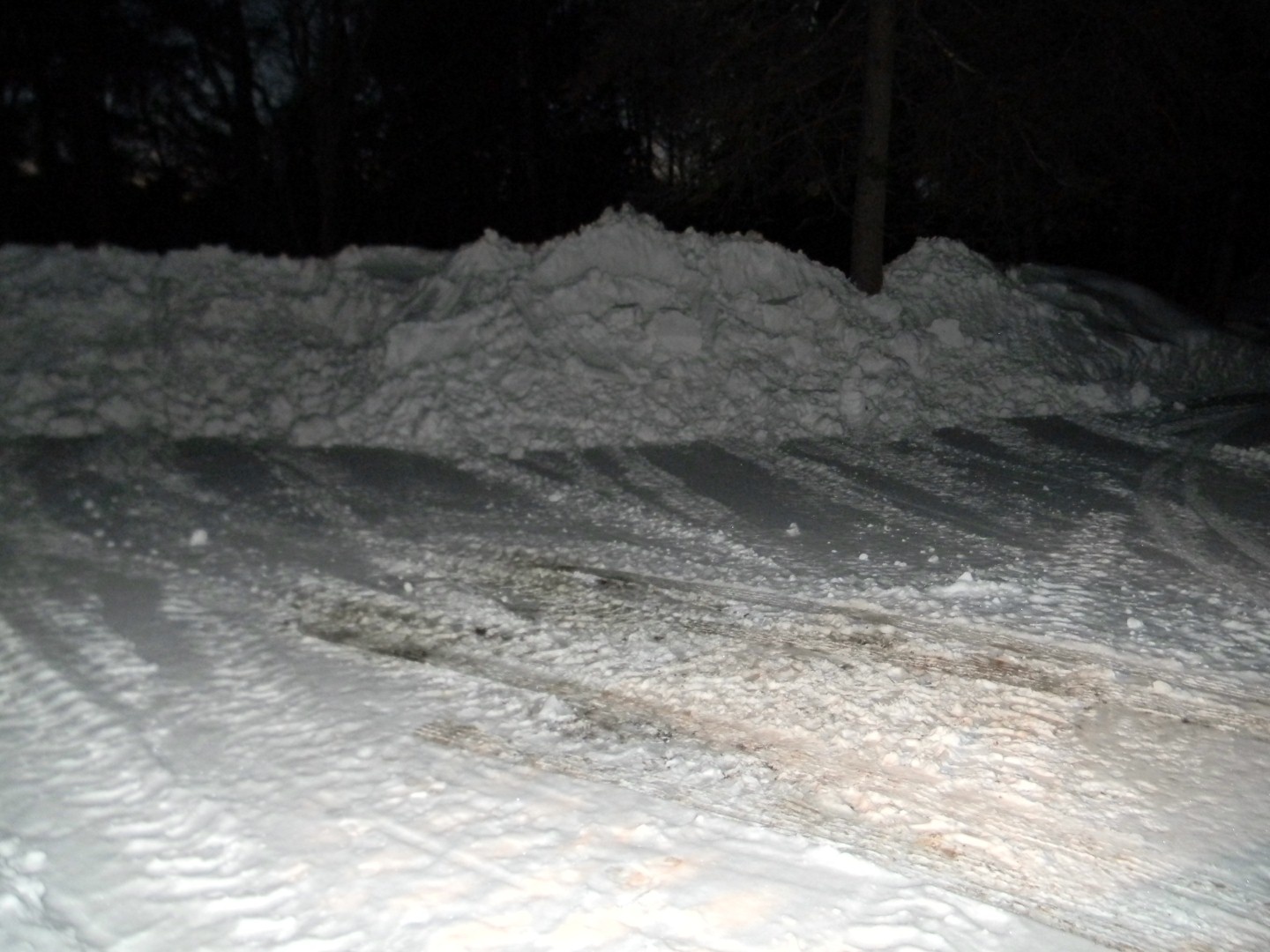

Sorry to hi jack thread but had to post a couple pics of the snow we have here.
I'll be looking to get rear spacers for next season too. I haven't had any issues with chains hitting but they are awful close. Just have to measure my bolt pattern and place the order.
