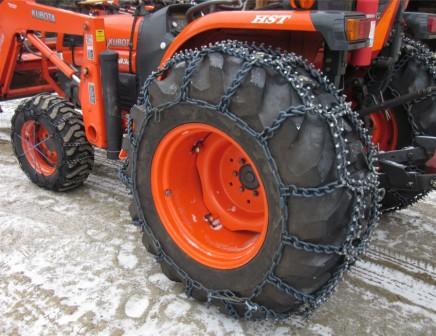

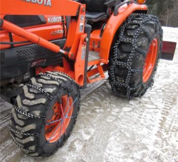

Here are a couple of pictures of my chain setup. This shows why I don't think the fronts are in danger of having more traction than the rears. Turns out you couldn't put anything larger on the fronts anyway, because when the wheels are turned all the way you could just about measure the clearance to the loader arm supports with a feeler gauge. The front chains are borrowed from my pickup, which has 245-75x16 tires, so they don't come very far down the sidewalls here, but with the bungees keeping them tight I think they'll be all right. I'm happy with this combination so far.

I think you are right. Is that enough to help with your steering in snow ?? If it is I would be inclined to do the same thing.
Nice rear chains - heavier than Telefsdal's.

Gordon, since I put the fronts on we had a mild stretch with rain that settled the snow here, but I think that if I get wallowing around in deep snow I'll probably still have to use the independent brakes for tight turns. I really wanted to have them on there to help cope with glare ice situations on an incline, to have something up front to grip as opposed to nothing.
The Trygg website shows that their studded chains come in several different sizes of chain, and I think the ones I got would be considered about medium, 9.5MM. Labonvilles had chains in my size, but I think what they carry is a heavier chain. For $1700 I would think so! That was exactly double what I paid for these, and that hurt plenty. That would be way overkill for me. I really like these. As I mentioned before, one of the neat things about these "Flexi" chains is the ability to shorten the sidechains by way of three removable links evenly spaced around the diameter of the tire, front and back. That lets you snug up the chains without having to use tensioners to pull the slack out of the sidechains.
