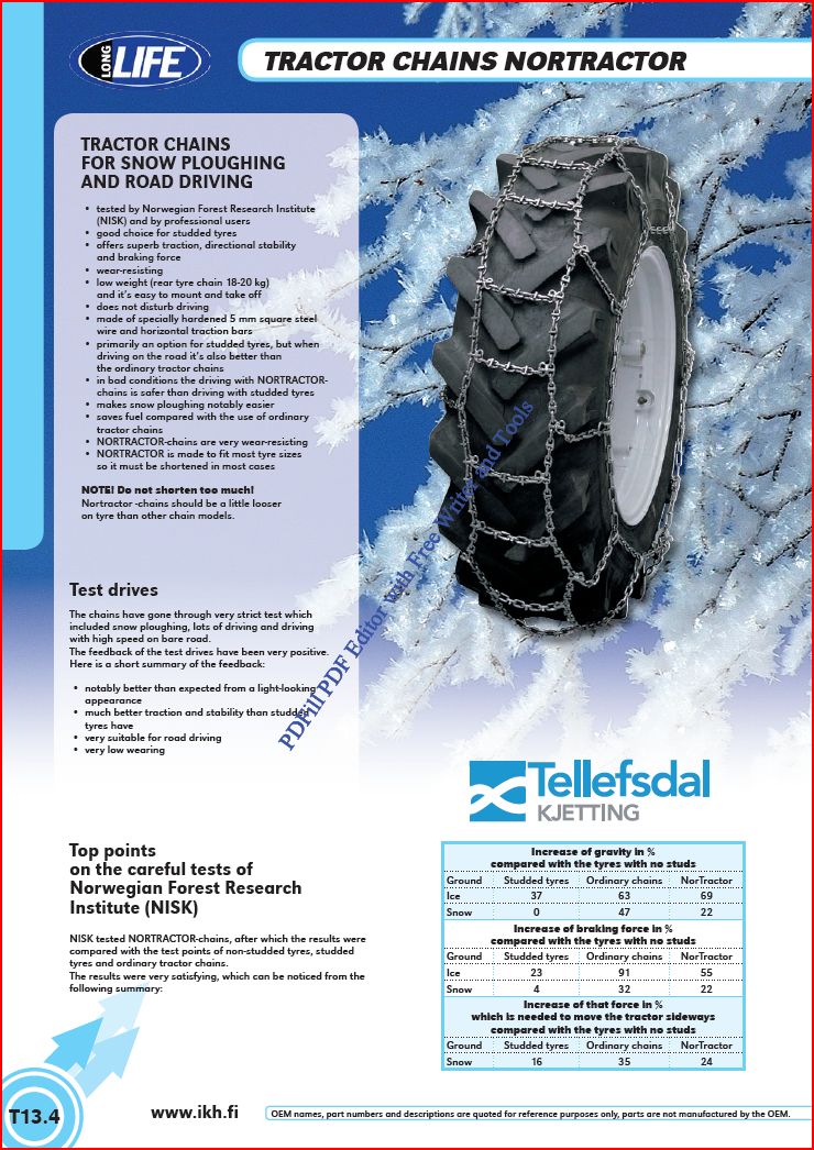

Just for interest:
Attached are a couple of pages from the Long Life Chains catalogue. One shows a zig-zag pattern for truck chains, and the other with test results comparing efectiveness of studs, ordinary chains(4-link ladder?), and Tellesfdal NORTRACTOR chains to no chains.
