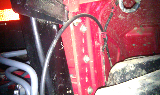

I too am looking to put chains on my low clearance Mahindra. Any idea how much side clearance is required for the MPCs? The local guy told me 2.5 to 3 inches. I'm wondering if he's being conservative.
I am running these chains with 2.5" clearance. It's close. About 1/4" left for clearance. These chains have to be tight and tucked. I safety wire everything that can flop around and catch a fender. These are heavy duty and aggressive chains:

One more thing I forgot. These pics are a couple of years old and every time I post these pics my good friends at TBN tell me turn the hooks around on the chain tensioners so they don't damage my tires. They're turned around now guys. And thanks for the good advice.
   / Tire Chains #33
Those are nice looking chains. Based on your clearances I should be fine now that I've found some spacers.

I was looking at my 3535 and it looks like the fenders have additional holes by which you could actually raise the fenders. Not sure if you could do that with the 4035. Add some wheel spacers and you'd be in business.

I use chain tensioners because the clearance is marginal.
   / Tire Chains #39
Here's an image of what I mean.
I'll have to look. This would be a good option.
