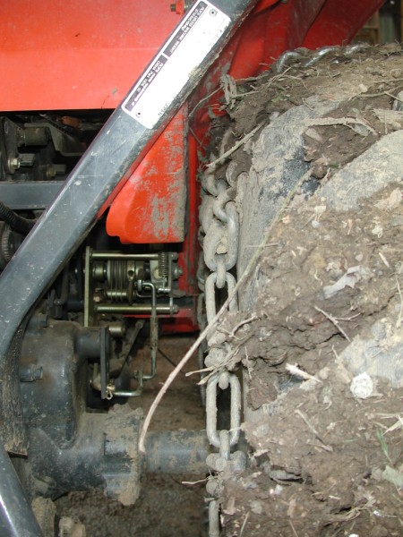

We have always ran 4 link ladders on our tractor and the cross chains always seem to stay across the lugs , Now and then we may have 1 cross chain fall between and hang their but the others stay put .
I know one thing take em off and try to go and you just sit their spinning . Tires are loaded in rear also .....I see so many complaints about the chains falling between lugs , But we use ladders and WVDOH uses ladders on the graders
Try to post a pic here sorry about the qualty tire veiw was caught as camra was being turned passed tractor .....
