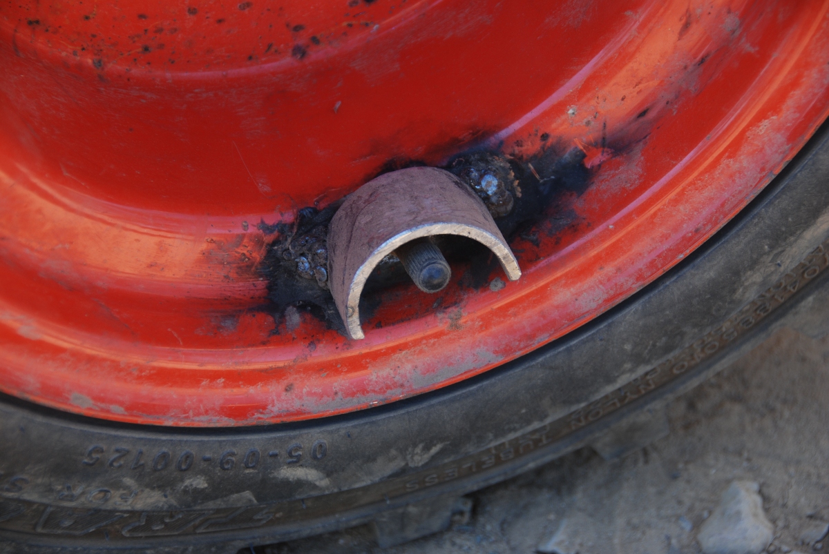

Hey John,
I can hear the air leak at the rim so I know exactly where it is. I can pump it up and hear it pretty easy...and the next day it looks like a "run flat" tire. The reason I said what I did about this tire shop, is because they dismounted and mounted some tires for me...and the machine dug in to the inside of the rim so bad, it chunked out steel where the 4 teeth grabbed the inside diameter of the rim. Then it's the same old argument...."Well...it's just a tractor tire and wheel...you have to expect things like that on a tractor!" and you never win.
I'm gonna try to break the bead tomorrow and look at the tire and rim and then I can tell...hopefully.

I put Green slime in my tires right after I bought the tractor 300+ hours later never had a problem with a low tire.

Slime worked for me also. About a month after I bought the tractor, the left front was always low after one week's time. I couldn't find any cause for the leak so I tried the Slime. It hasn't been low since.

Before I slimed mine, my left front would go down even with no FEL work (FEL not installed) involved. I think I know what you are getting at with the FEL involved, heavy FEL load in a turn will cause the sidewalls to collapse some and could cause the bead to leak?

Yeah, something like that. More a bead roll over stress kinda thing. We see this on other equipment. Remember, just a working theory, but if it is happening on machines with no FEL, than .... aw, heck.
