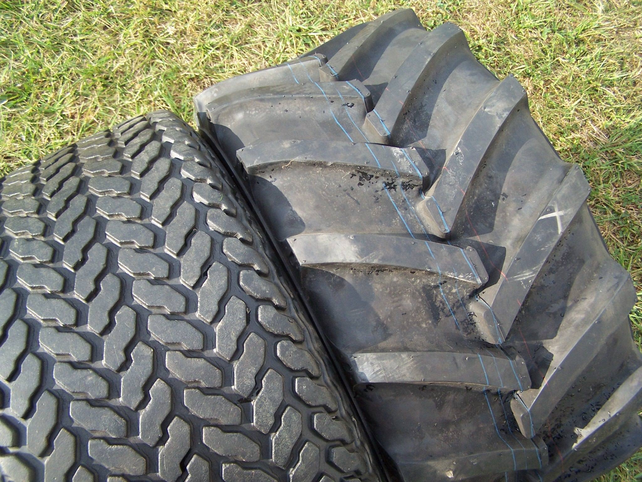

i put wind shield washer fluid in a sears garden tractor tires once when i first bought it, 12 years later i put new tires on it and there was no corrosion on the tubeless wheels at all. i have since upgraded to a ford 1220 tractor and put new ag tires and filled with rated 30 below zero wind shield washer fluid in those as well. and they are tubeless too.
