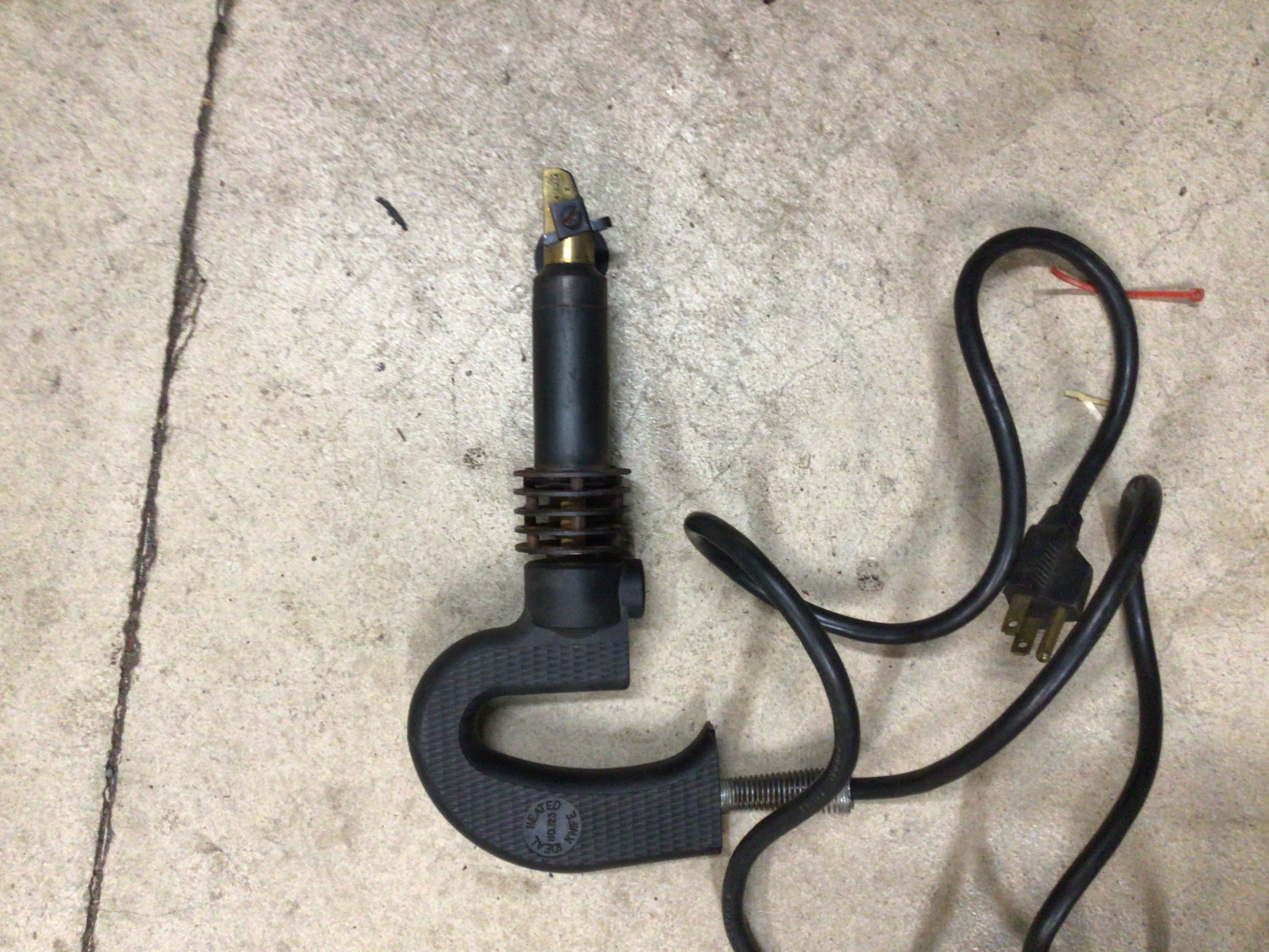

What's a groover look like?

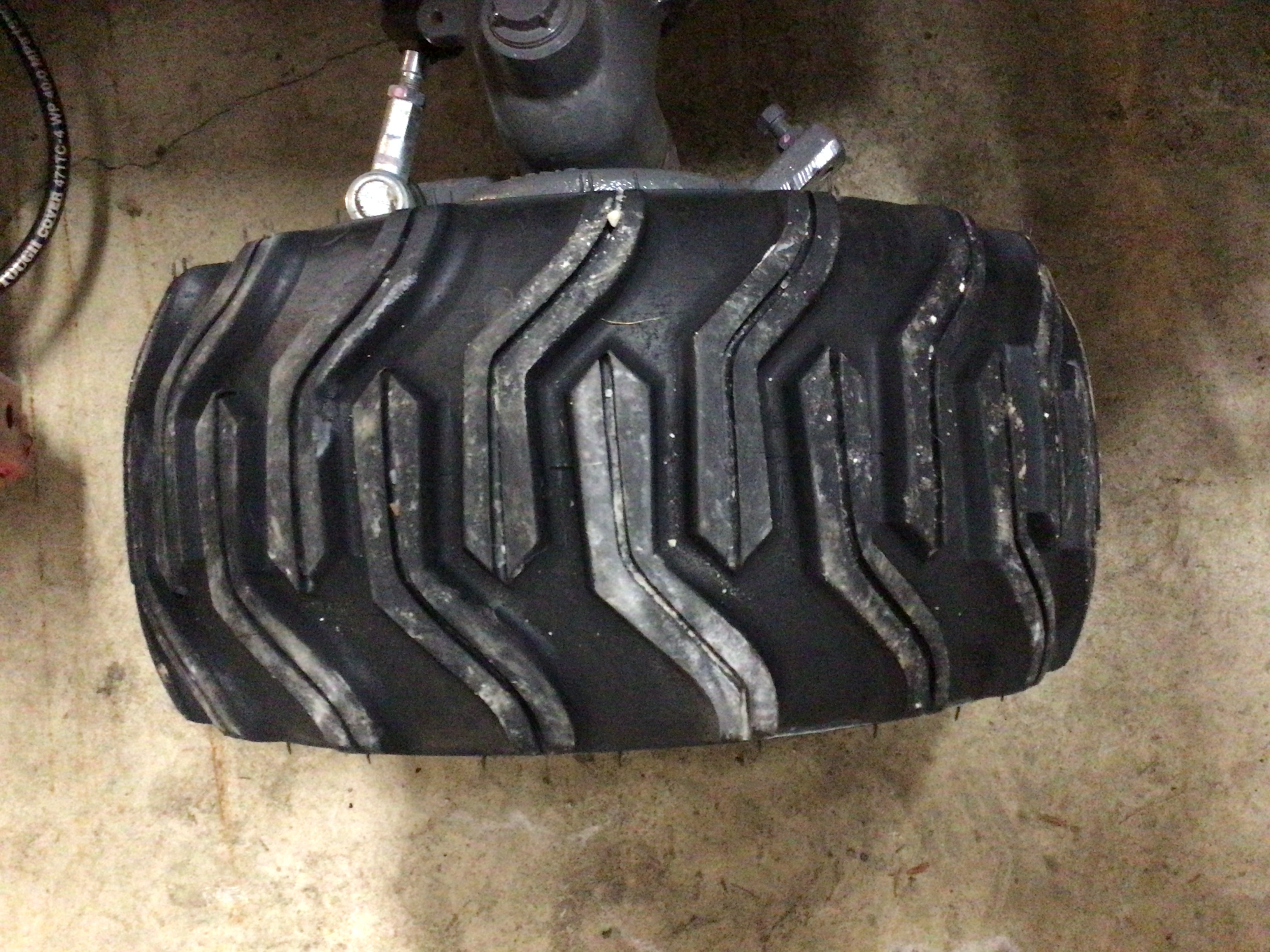

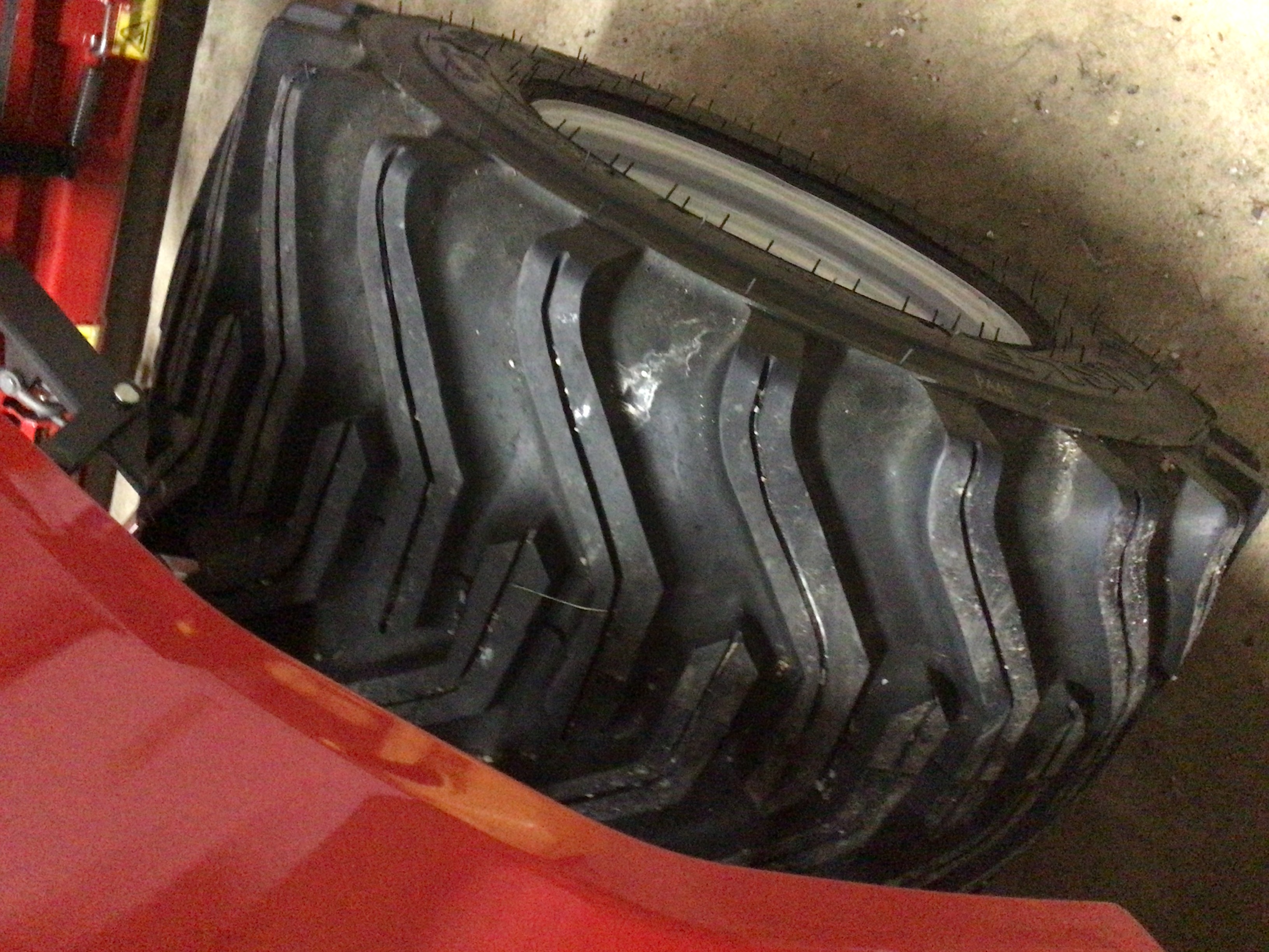

051F96D9-0A81-4B05-8265-FE4FEAD9BA38.jpeg3D49B9D8-59EC-4440-865B-204DFCC24920.jpegC19EAE66-77B4-4065-B1BF-FB3A96C798CA.jpeg
Rear grooved tire, Older Ideal Tire groover and then the front tire grooved.

So it's heated! What, a combination of melting/cutting? Thanks for the pic; I'd never seen one of those before.

that looks awesome, how many blades did you go through? how much of a increase would you say you gained, i did my first snow plowing last night and with 4x4 and diff lock and loaded tires and a backhoe hanging off the back i was still sliding all over the place.
