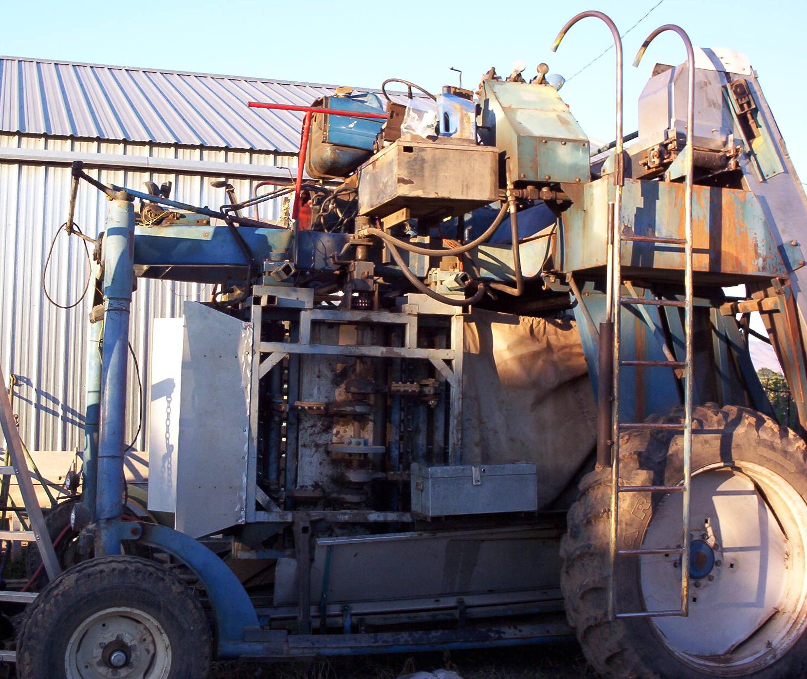

Well, she's picking grapes now.......
Wiring is still 'so-so' but it lights up for night work. Gonna "fix" it to my liking. Been busy..... I'm the fool who drives the semi to deliver.
A lot of the belt roller bearings were changed. Putting the belts were a pain.... especially when time was not a luxtury.
I'll try to get some pics...... of it going....

She "stopped" in the middle of the field. Driver said he heard a noise, but couldn't tell how "regular" it was. Oil & pressure was fine. He thought it was coming from the front, maybe the timing gears. On one row, it died. Plenty of fuel. When I got there, the thing wouldn't turn over..... as far as we can tell, the fly wheel got loose. (Checked out by a NH dealer mechanic and a buddy from work). NOt sure if it got loose then broke the bolts or what..... Don't know if the flywheel was removed when they replaced the tranny (since it was covered in oil). If it wasn't, then I'm (we who put the engine in) is to blame......
No one ever told me to use LockTite on the flywheel bolts! The manual (as far as I can recall) never said to put LockTite.....
I'm hoping it's just that...if not.... something really went wrong w/ the internals....
Having the same place that did the tranny fix the flywheel and check the engine (to make sure it turns freely/correctly).

Yup...confirmed. Flywheel got loose somehow, sheered bolts.
List of damage is ....expensive. Item needing replacment: torque limiting clutch, flywheel, flywheel bolts & engine crank..... yes....the crank.
Will have to coordinate w/ NH to see how long it will take to repair engine if they do it (and if it keeps the warranty in affect). If it's voided right now, I"ll have the shop it's at fix it....they're faster.
Can't do much till Monday (small owner operated places have the luxtury on working Sun....)
I guess putting the engine in myself bit me in the butt...... being the "newbie" will cost me....
