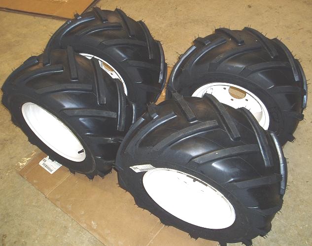

Some other things you might consider, the shortest valve stem you can find, and about a quart of slime in each tire. Bar lugs pointing forward and stem to the outside. good luck
   / tires and rim for the 422/425
#22
Thanks JJ the tires came already mounted and the valve stems seem to be fairly short (only one vale stem in each wheel). I guess all in need to do is add the tire slime and install with them in the right rotation.

Carlisle Tire & Wheel Company Carlisle part number is 1217394266 this info can be found on their site. under wheels. This number is what the rep form Carlisle said fit the PT 422/425
