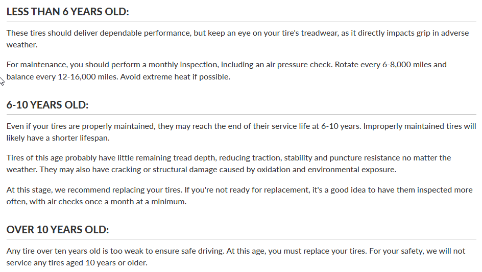

I keep track of tire age on my vehicles and trailers. I tend to err on the side of caution. If it were my truck, it would get new tires. Here is the Discount Tires position, which I where I get my tires. They would not service them. And yes, I have replaced tires based on age that looked brand new, such as spares which never hit the ground.

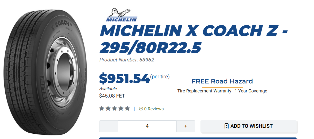

Not sure where you are coming up with that price . . . $500 each should be easy to find ...
I'm talking with potential buyers. I am getting a *LOT* of feedback from truck operators that they won't touch my 11 year old tires with a 10 foot pole. They want me to replace them, or credit them so they can get it done. Some are worried of personal liability if they were hauling a load, blew out an 11-year old tire, and caused an accident.
Still curious-- if I replace them-- is there some other use for them? Kind of hard to sell a "set" of tires to use as a spare, but I'd be OK having one of these as a spare on my truck. Any other ideas?

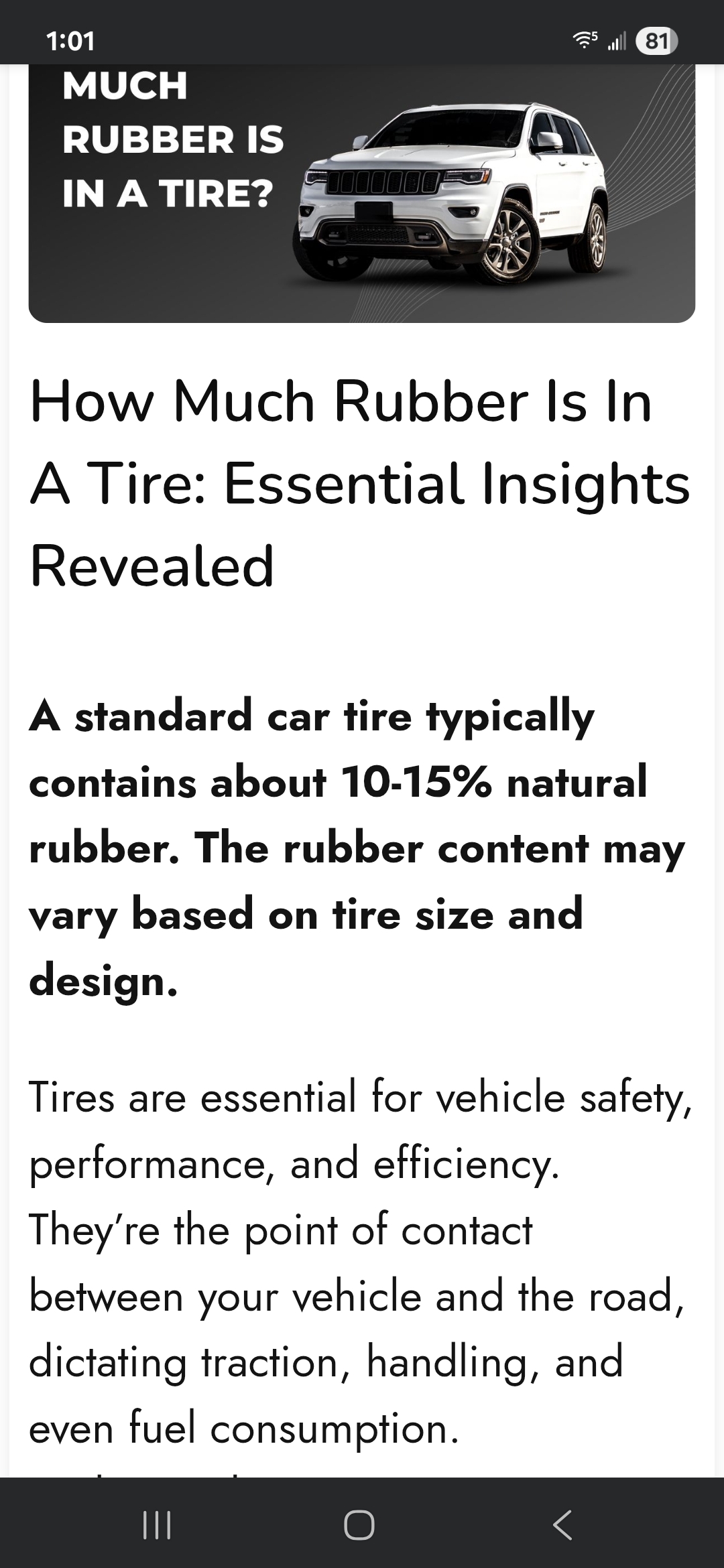

I was curious about the use of rubber in an average automobile tire vs a petroleum product.

You do know that Michelins are a premium price tire, right?
Have you tried Continental, Good Year, etc?
