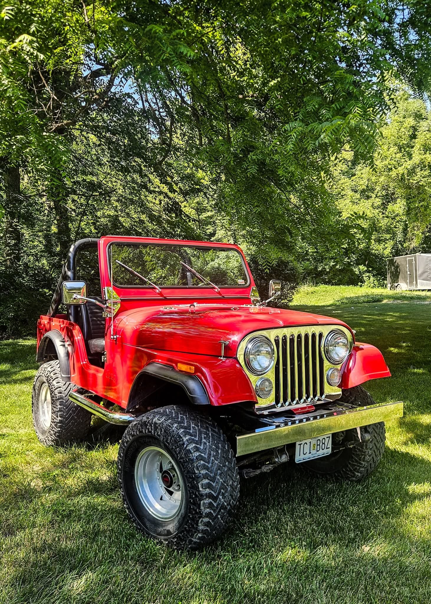

31 years and counting on these Mickey Thompson tires. These were put on in either 1993 or 1994. I think they have less than 5,000 miles on them. I finally knocked the dust of the jeep this year after sitting for the last 3. Took it by the tire shop for a slow leak and we took a look at the inside of them while broken down for any signs of deterioration or cracks. Still look like new inside and out. I don't have a top for it though so it has never been stored outside.
I don’t think I’d want to run those at interstate highway speeds. Trailered for off road use, yeah.

Not a thing wrong with them. Have barely seen the sun. I had all 4 broken down and inspected inside and out this spring.
