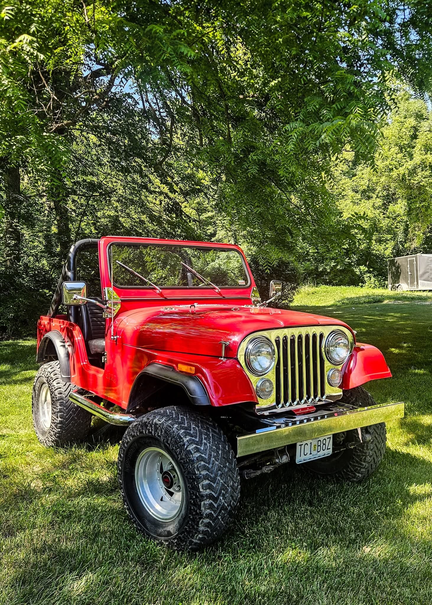

31 years and counting on these Mickey Thompson tires. These were put on in either 1993 or 1994. I think they have less than 5,000 miles on them. I finally knocked the dust of the jeep this year after sitting for the last 3. Took it by the tire shop for a slow leak and we took a look at the inside of them while broken down for any signs of deterioration or cracks. Still look like new inside and out. I don't have a top for it though so it has never been stored outside.
