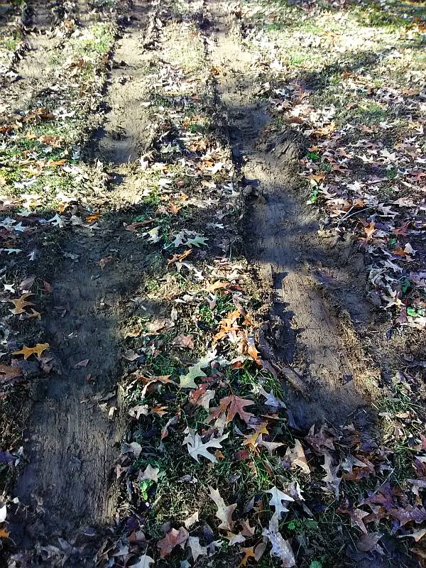

I was wondering where to put this. Thought about the Slippery Slope tread, but that's about mitigating a drainage issue. This isn't really a puncture or strength issue, so it doesn't really go on the Ag vs R4 puncture thread. It isn't really LS specific either so ......
I found out R4s do NOT like my mud. This is on a fairly steep slope, but not my worst. This is in Low, 4WD and DiffLock:
It went most of the way, but I ended up having to back down. Tried another spot adjacent, same issue. Had to move to a different area to get up the hill.
To be fair, this mud is so slick it's hard to walk on safely. Some sort of clay/soil mix that gets slicker'n snail snot as the saying goes. Also, this area was worked a few weeks back to move some dirt around while practicing with the hoe and loader, so it is not fully stabilized and they really isn't much turf established. Also, I had both the FEL and BH on as well as the MMM.
Not in a position to afford a spare set of R1s on wheels and I'm not even sure they would work in this case.
Any thoughts on chains?
Hopefully by next Winter I'll have better turf here and it won't be as much of an issue. But who knows.

That same area is still muddy, but only a damp mud, no longer the shiny slick mud it was. I can now run up and down over it with no problems.

^^ While the R1s may have helped me get uphill on the slicker mud, they would likely have dug in and made deeper ruts that would be harder to repair next Spring.
   / Tires?? #15
That's one of the two main reasons I don't have R1 tires on my tractor: they can cut themselves a pretty good trench. I try to avoid going on my trails in conditions like that, but sometimes I don't have a choice. The other is that R4s are generally tougher and stand up to grinding around in my rocky woods better. (Yes, I know I could shop around and find other styles with higher ply ratings, but I could also find an R4 with a higher ply rating if I were going that way.) I do agree that for field work, it's hard to beat R1 tires.
