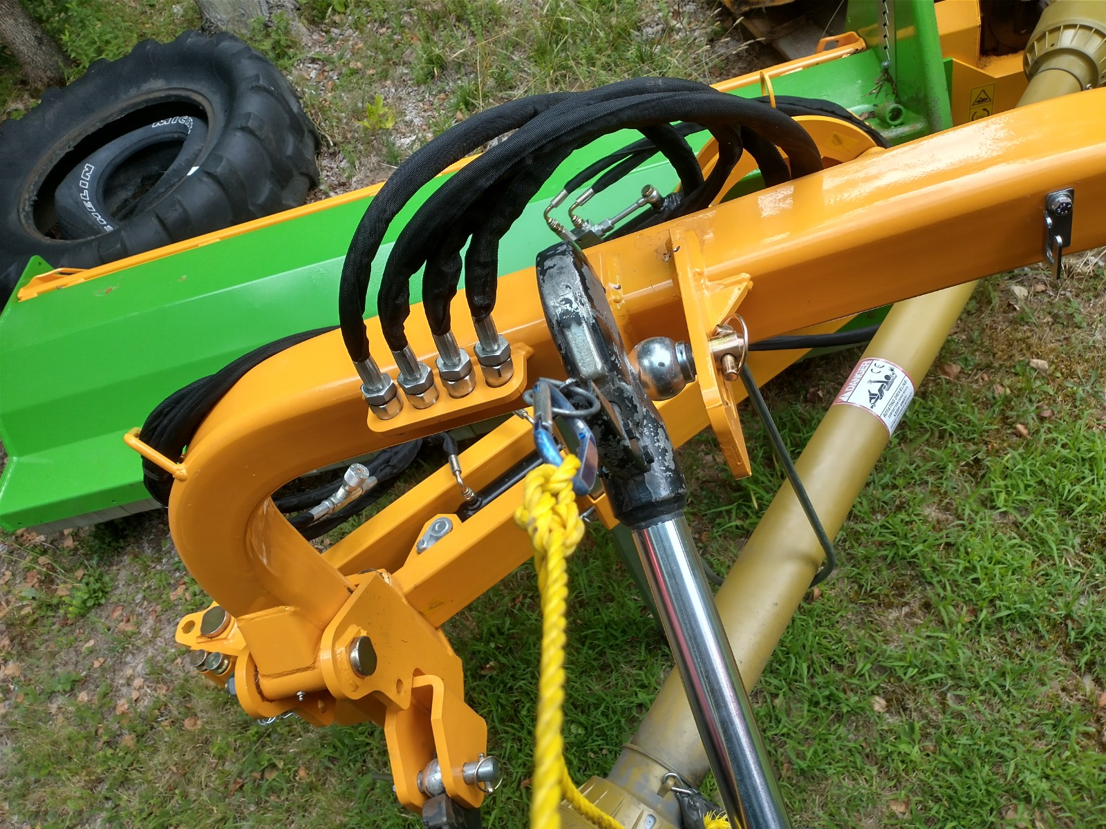

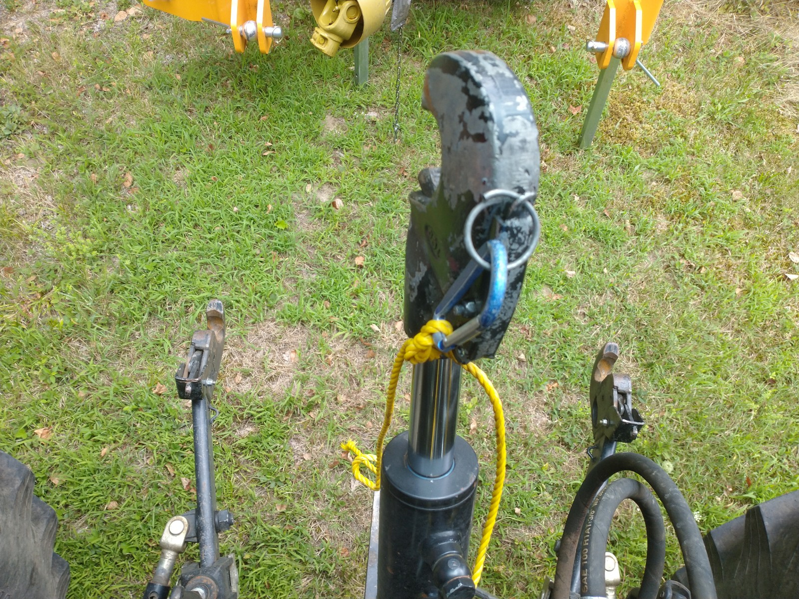

I'm fortunate that my tractor has the Euro hooks on it from the factory;
looking down from the cab, you can see the tractor hooks and the balls on the implement,

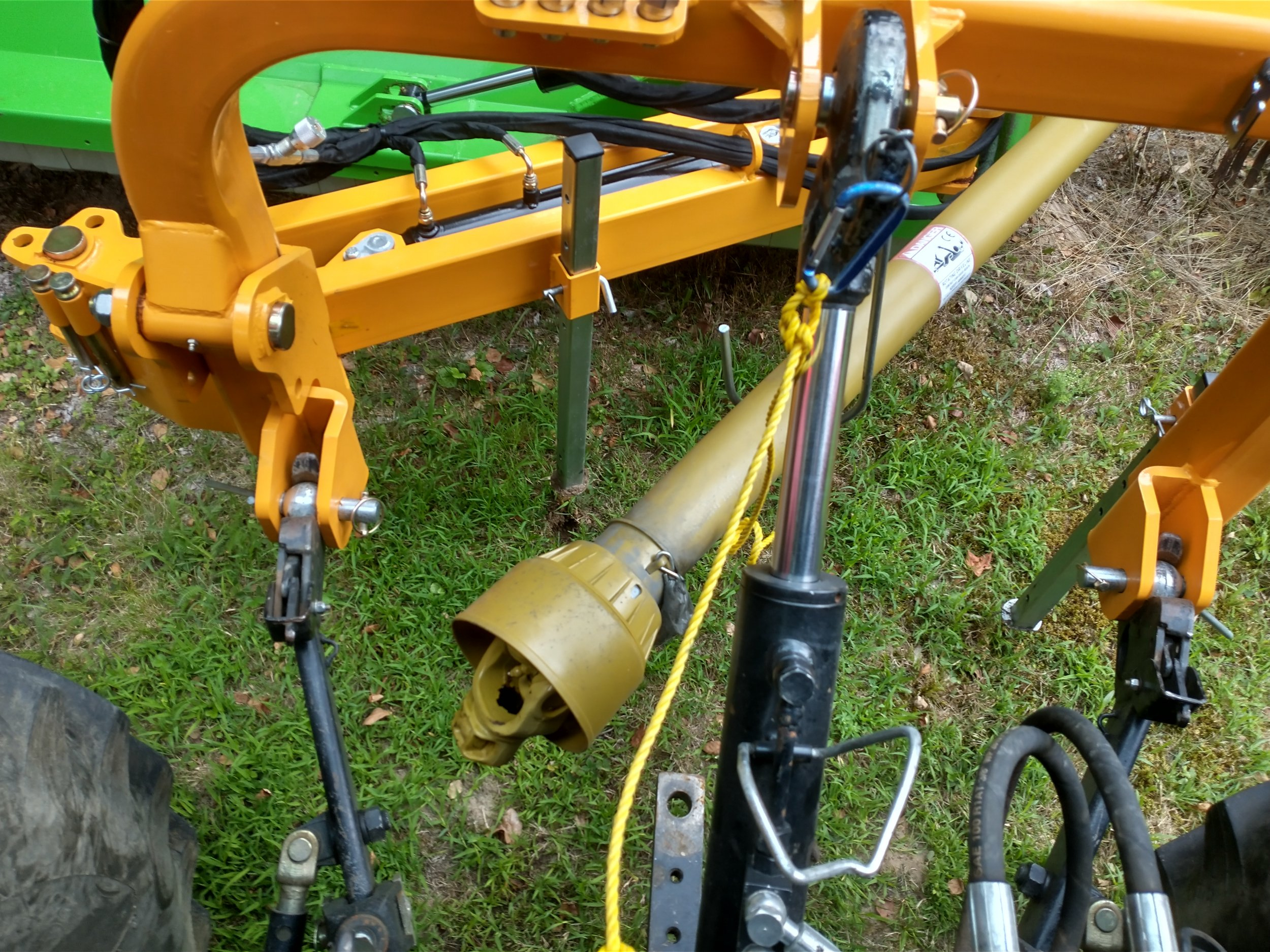

After backing in to the implement, you can see that I'm not perfectly level,
I've lifted the lift arms and taken the load off the parking stands,

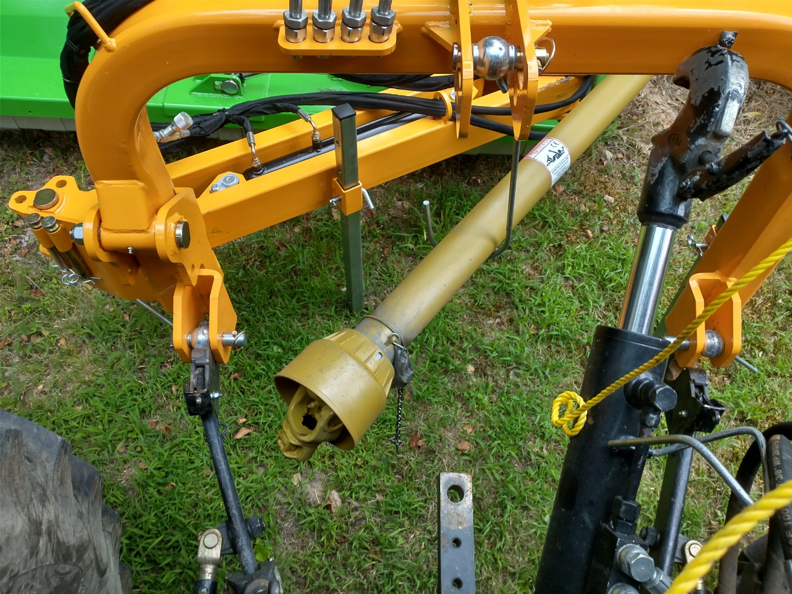

And now I'm lowering my toplink with the rope and adjusting the length to catch,

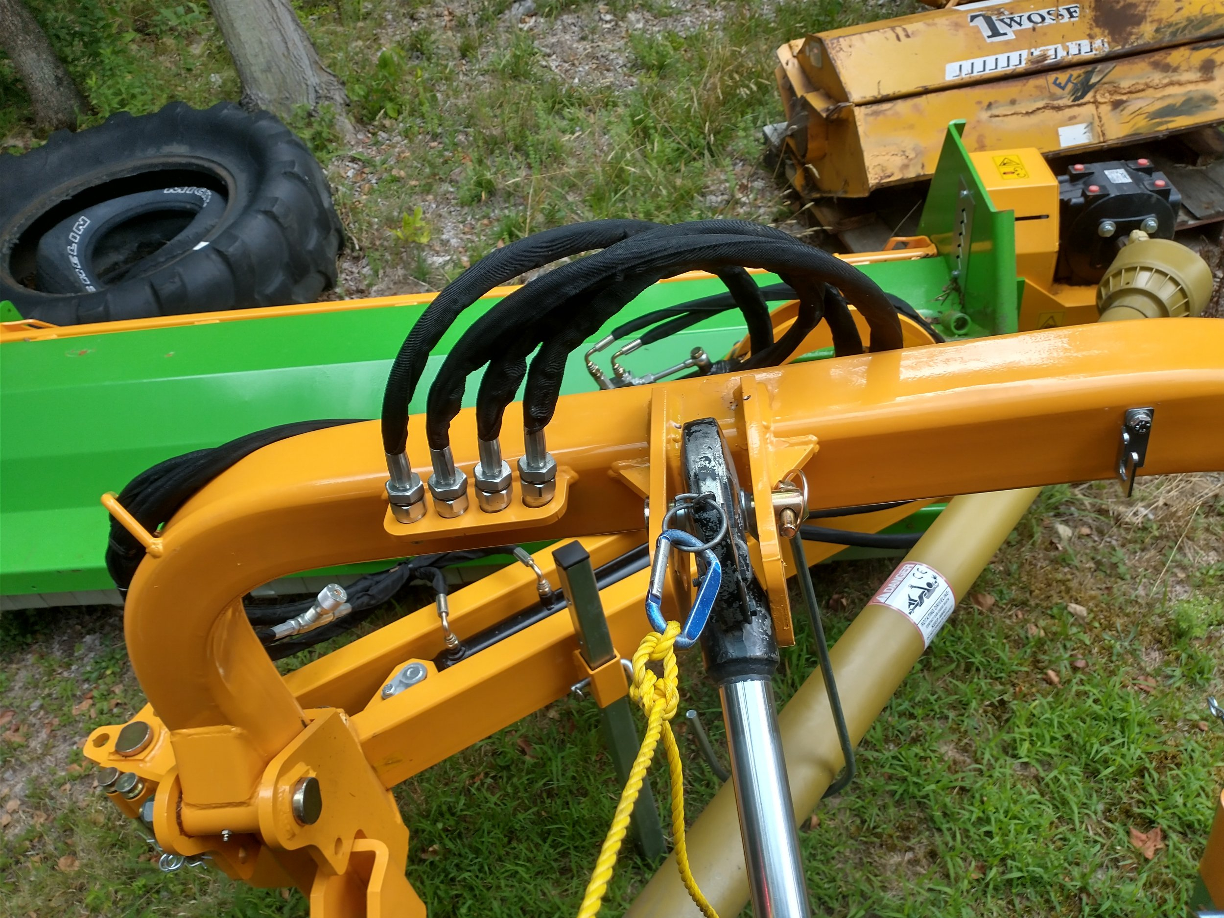

My implement is completly on my 3 point, I'll close the latches when I lift the parking stands and connect the pto and hydraulics,
No fuss no muss. The hydraulic toplink is not factory.

Nice, simple and just works. No frame in the way either.
Most hooks will actually latch it self once the ball sits in the hook, but I've noticed some brands are a bit more stubborn and need to be manually locked. Still no big deal at all.
The top link with the hook makes for the complete combo. How have you been like it so far, Lou?

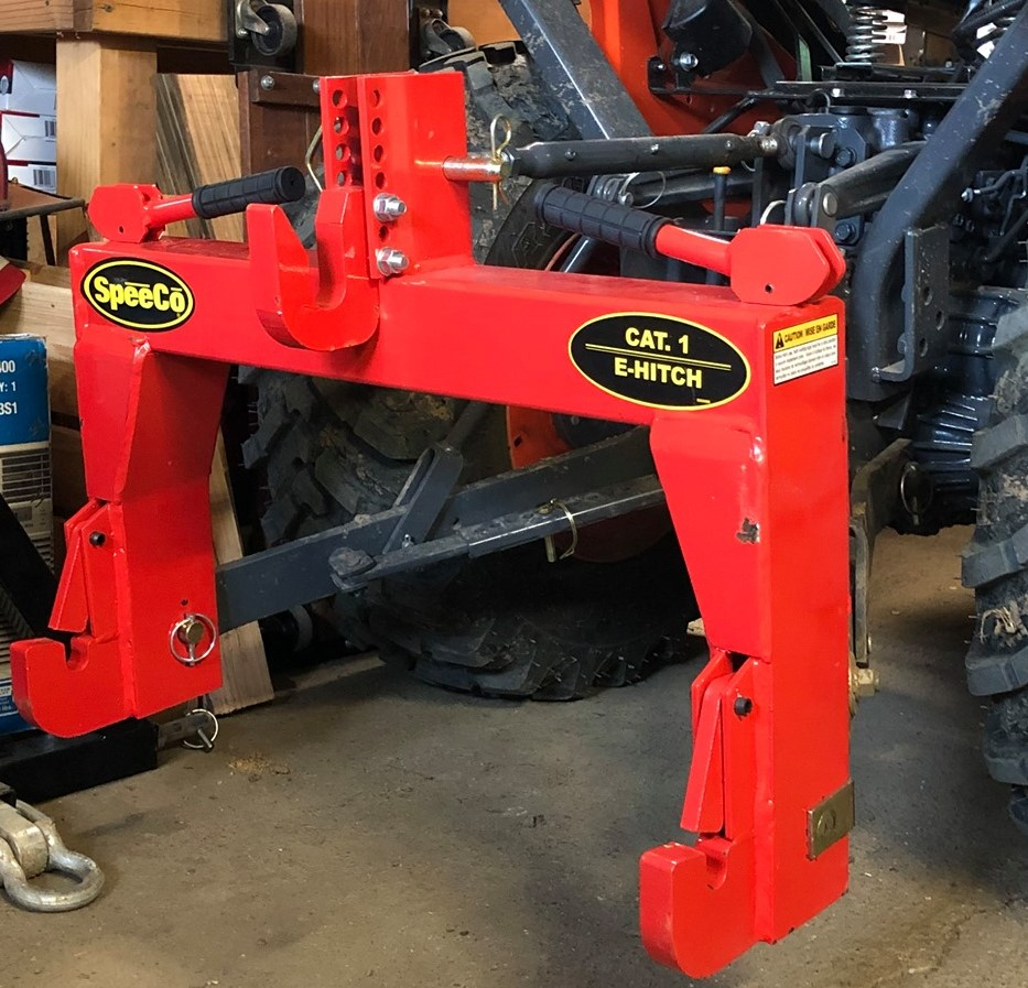

We use the Land Pride QH15 it’s easy to use and has none of these issues the cheap ones have
   / Titan Attachments Quick Hitch Initial Review #15
And yet it is a deviation from the "standard" which makes it with its own set of problems....
To my knowledge, Speeco pretty much pioneered the traditional quick hitch, and I've never heard of it being any sort of deviation. It fits the same as their traditional quick hitch, which requires bushings, only the E Hitch does not require bushings.
