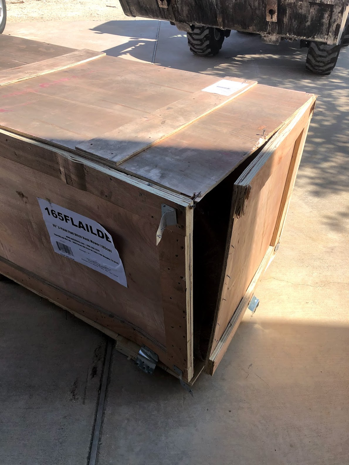

Shipment arrived to my house in less than a week from Titan. Shipping crate was not in the best shape, but the contents were all intact. Two minor issues upon arrival. 1. Paint rubbed off from parts rubbing together in shipping. 2. Burr inside bushing damaged threads on pin during assembly. Both are fixed and Titan has been working with me along the way.

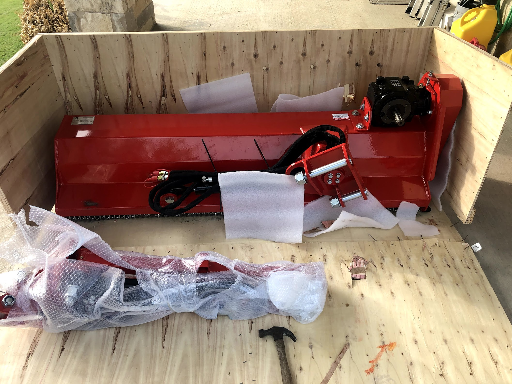

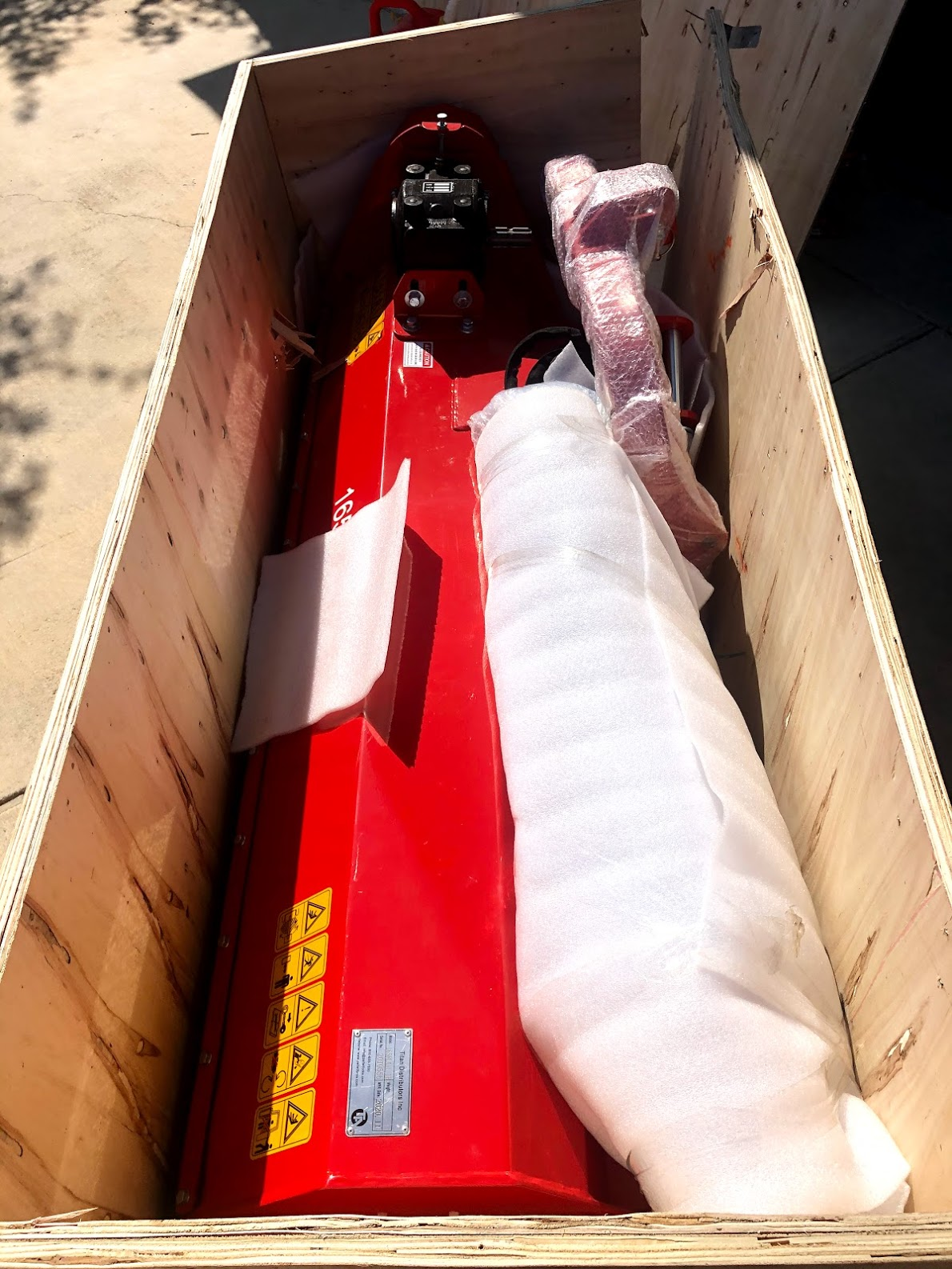

Unboxing the unit and assembly takes some time. It's very heavy and robust. There is no cheapness anywhere that I can detect with the product.
   / Titan Flail Mower
Having someone to help with the assembly is a plus. The swing arm and 3 point assemblies are heavy and awkward to move around.
   / Titan Flail Mower
Assembly, greasing zirks and putting oil in gearbox is probably a good solid 1-2 hour job if you do not run into issues. Mine was closer to four due to a slight defect that caused me to damage some threads on a large bolt.

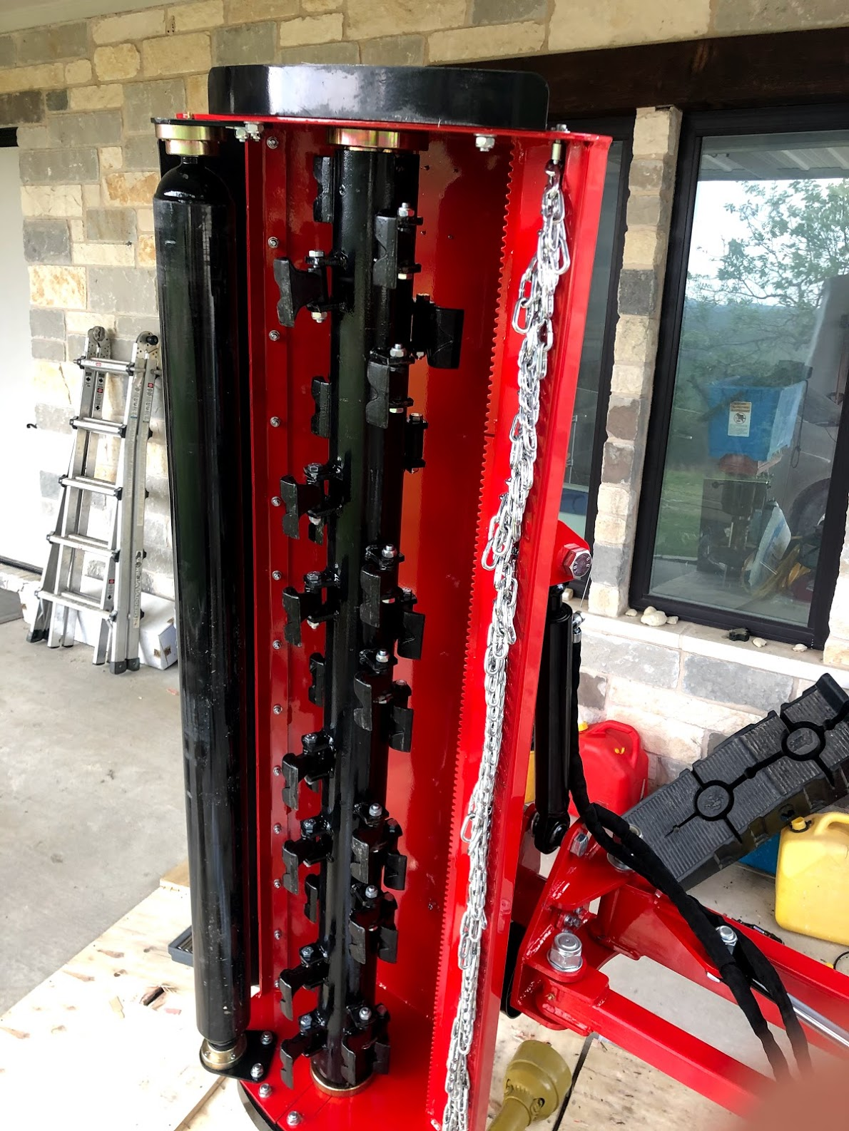

A quick test around the yard yielded good results. Initial impressions are to take it slow, there are lots of things to be watching and monitoring at the same time. I am also going to need to find a way to slow down the rear remotes, moving the hydraulics with engine RPMS at right level to run the implement are way to fast and jerky. I need to find a source for orifice disks or flow limiters online to order.
   / Titan Flail Mower #7
I have the same issue with my Peruzzo ditch and bank mower with the movements being too fast and jerky, even though it came with orifices to limit flow. After exploring options, I ended up doing nothing and kind of getting used to it.
I like the chain front guards. My Peruzzo has a stiff rubber belt guard, which knocks down tough stemmy weeds so they aren't cut, then pop up in a short time. The only way I've found to solve that is to remove it, which isn't a great solution. I was just thinking today that a chain guard should work better.

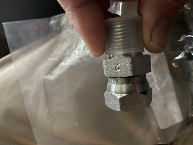

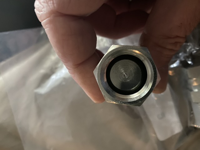

My rear tires are loaded with ballast, so I have that covered. My dealer recommended 1/2 swivel adapters with an orifice to restrict flow. The were only 5 bucks each so order 4 to try out. If they don't work out I will visit a hydraulic shop for alternatives. I'll pay a little more attention to leveling the lifter arms next time I hook up.

2. Installing swivel orifice adapters with a .031 hole were perfect to slow down the rear remotes to a very nice speed.
