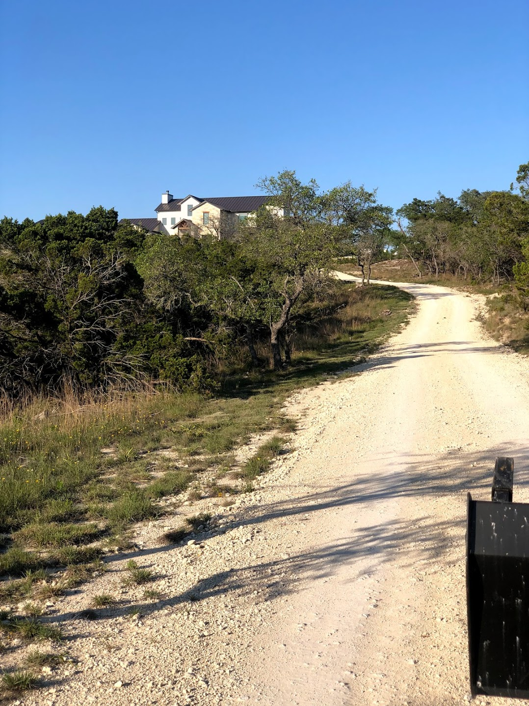

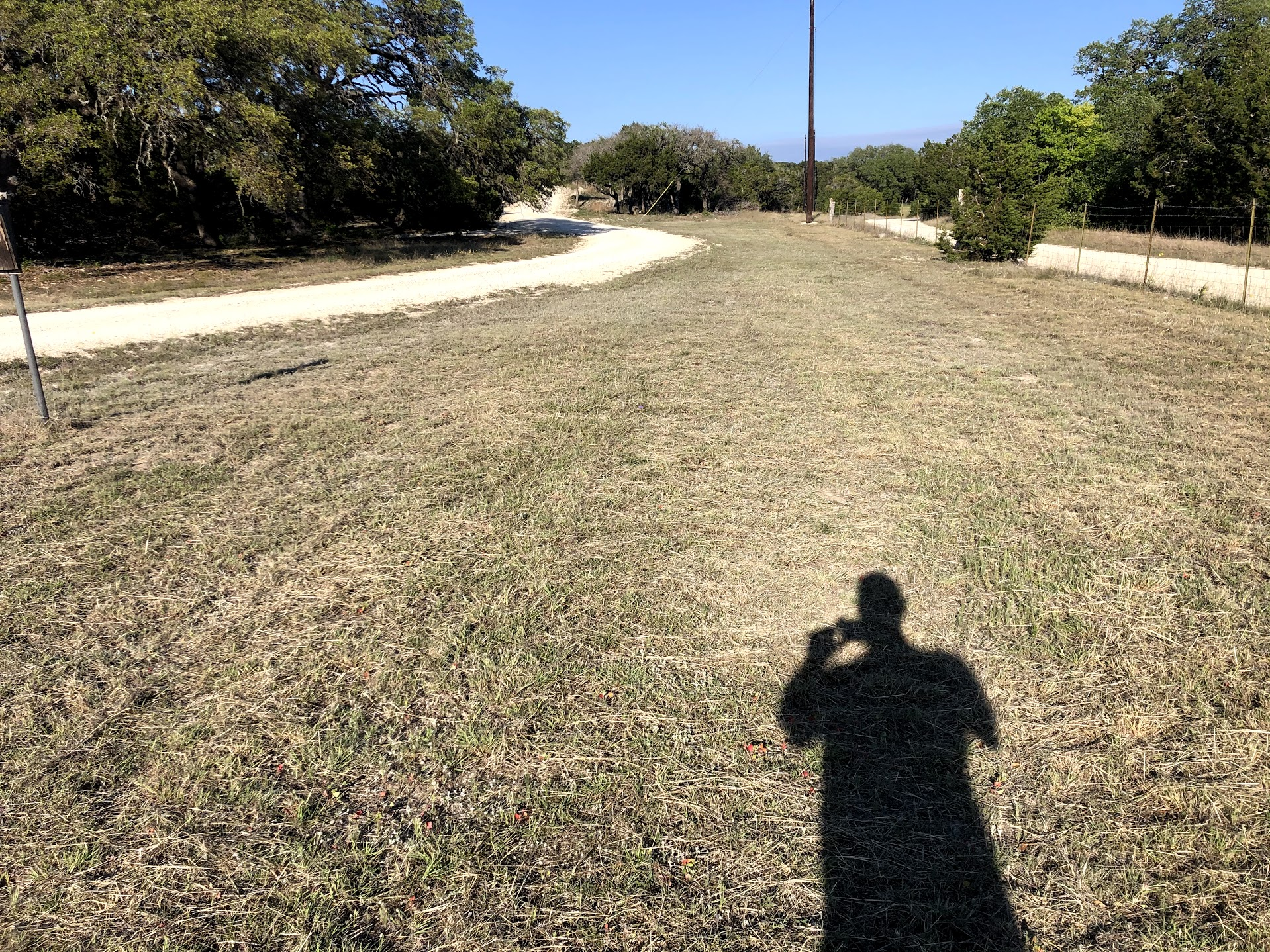

Thanks for all the tips, I was able to get it setup much better last evening. Setting the 3pt just so the roller touched the ground and extending the top link much longer I was able to get the height I wanted. Also having that top link in the middle of the slot created a good float when mowing.
Finished up one of my fields and took a run at a section of driveway edge.

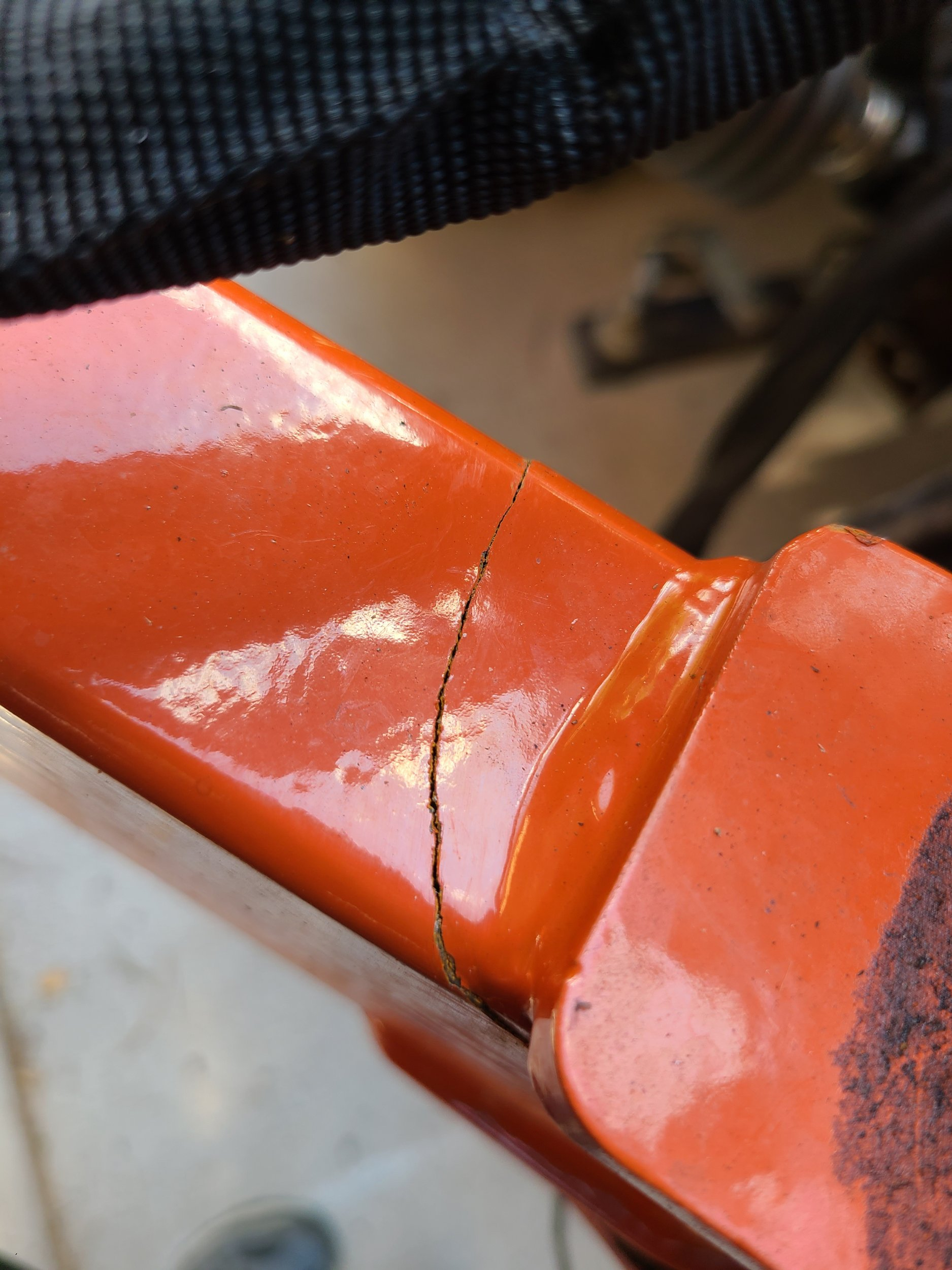

I bought the same flail mower. The first one arrived without the swing arm. I had to return it. They were very quick with getting me another one. I used it for about 25 hours and noticed a crack in the large swing arm tube. They're going to warranty it but can't tell me when I'll receive it. I'm going to get it fixed and strengthened. See the picture.

Looks as if it has been spitting over time. Rust in the crack. Did you happen to hit anything or just normal use?
