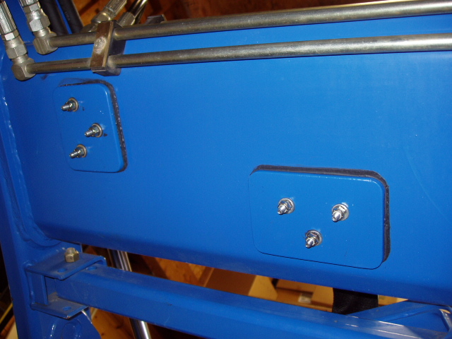

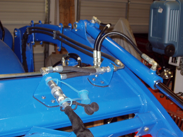

Here is a picture of the other end of the hard lines. As you can see, the ones with the red plugs don't have anything connected. That's why I'm asking for advice. I take you point about single hoses running from the hard line directly to the rear remotes. I don't remove the loader all that often so I'll take you're advice and do it that way. I'll just make sure it's clamped in a way that's easy to remove when I need to remove the loader.
Next question: Do I need to bleed the air out of the lines and cylinder after I get everything connected?
Thanks again
I don't remove my loader very often either, but it sure is nice have mid-mount quick connects when I do. I got my quick connects from TSC (~$25 for a set needed 2 sets=$50) and part store charged $5 to cut and add ends. So your talking around $70.00 and you don't have to re-run yours hoses.

Steel lines kit for the loader with the mid disconnects run back to the 3rd function kit on the rear. Done right factory kits and looks factory. The only way to fly!
   / Titan Grapple - It's killing me #23
Or, save the $70+ bucks plus cost of hard lines and just run a single pair of lines secured with zip ties from back to front. Removal takes two minutes longer than with split system and reinstallation takes ten minutes and new zip ties.
Works just as well. Might look more country but who are we trying to impress?

This is my hard line kit I did, only cost was about $150 since I had steel lines already, if you want more pics I can get some I would keep the flat face cause all skidsteer attachments are flat, I use all attachments though out all of the skidsteers and my tractor, I borrow a lot of attachments from my dad

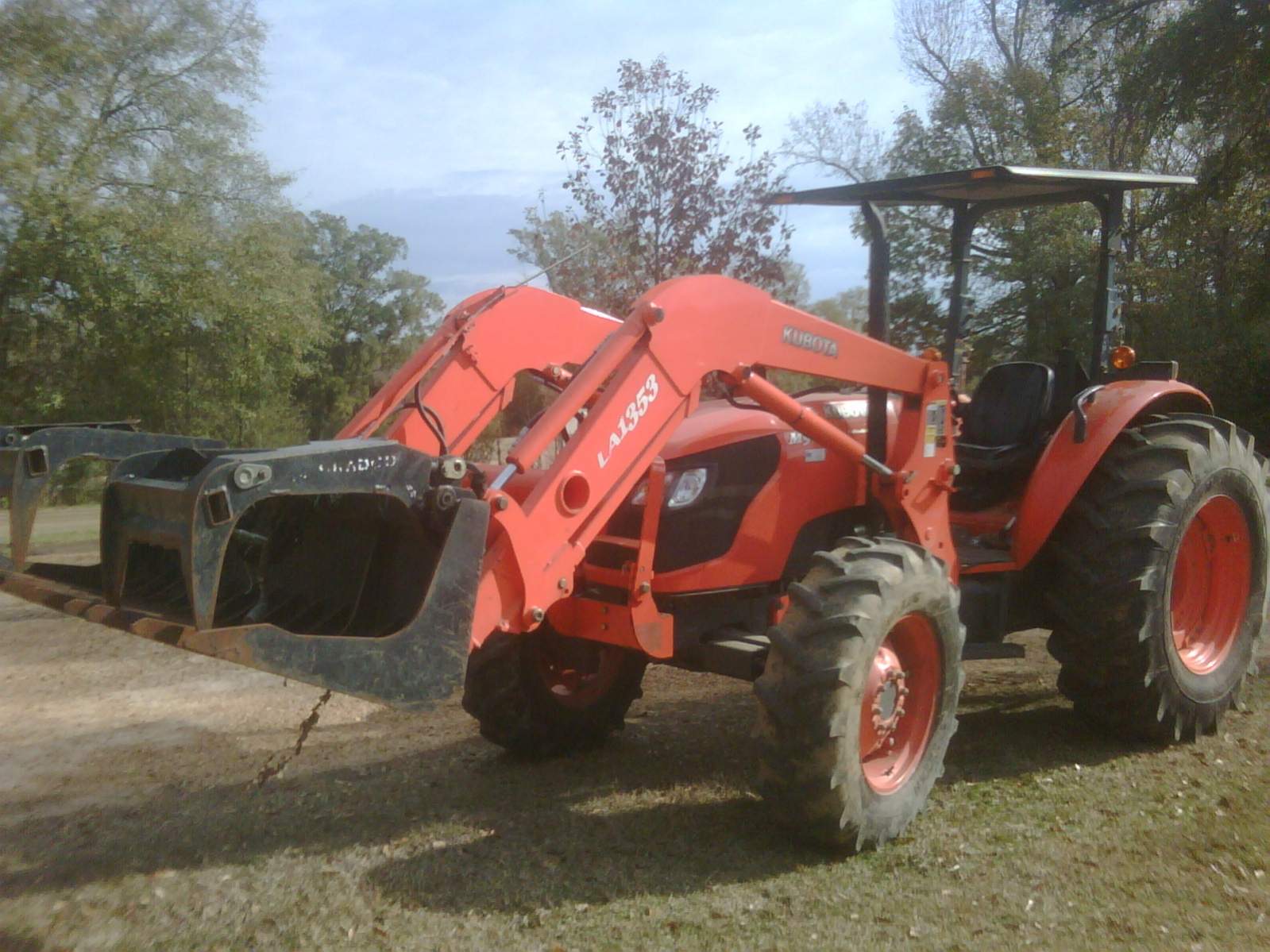

I finally got replacement hoses and got everything hooked up and the leaks fixed. Here are two picture of the first test run.
