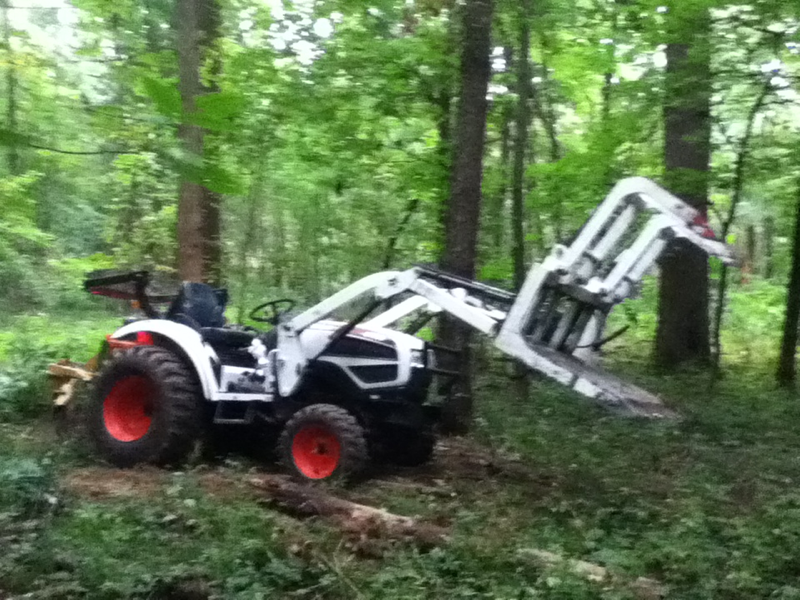

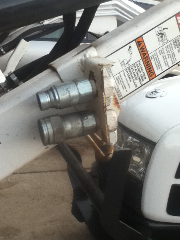

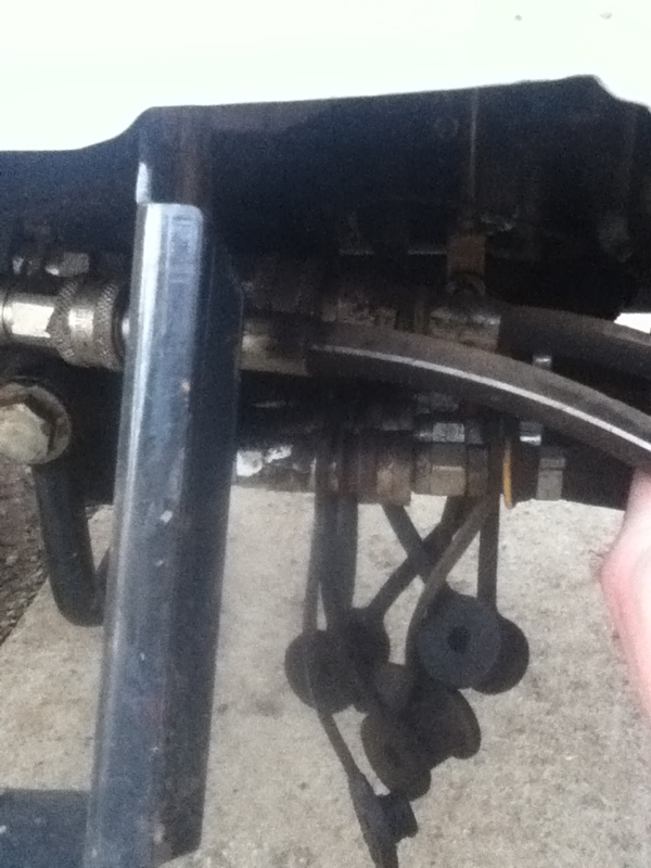

This is my hard line kit I did, only cost was about $150 since I had steel lines already, if you want more pics I can get some I would keep the flat face cause all skidsteer attachments are flat, I use all attachments though out all of the skidsteers and my tractor, I borrow a lot of attachments from my dad

That's the first albino grapple I've seen. Rare!
   / Titan Grapple - It's killing me #27

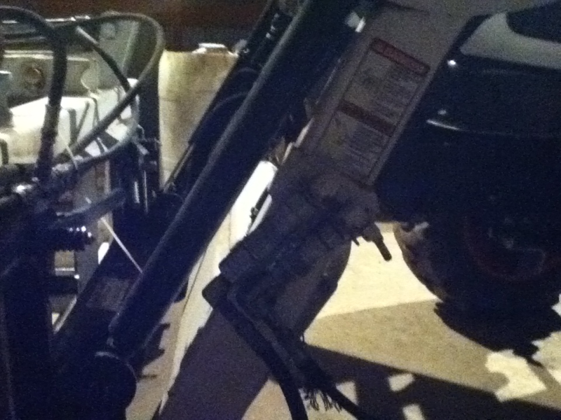

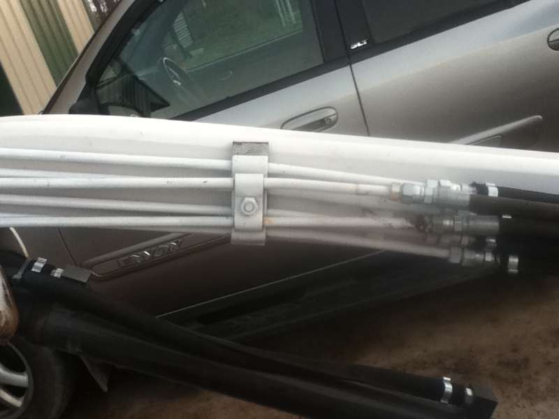

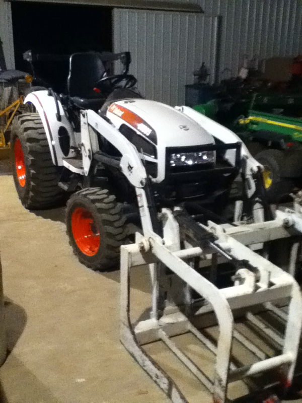

Got some more photos of the aux front lines, yes the grapple is homemade to clean and finish land clearing jobs and prep for seeding, I use it alot with the tractor for new snowmobile trails, got a plow for it I'll get pictures of that tomorrow, and it's nice to have all the coupling the same.
