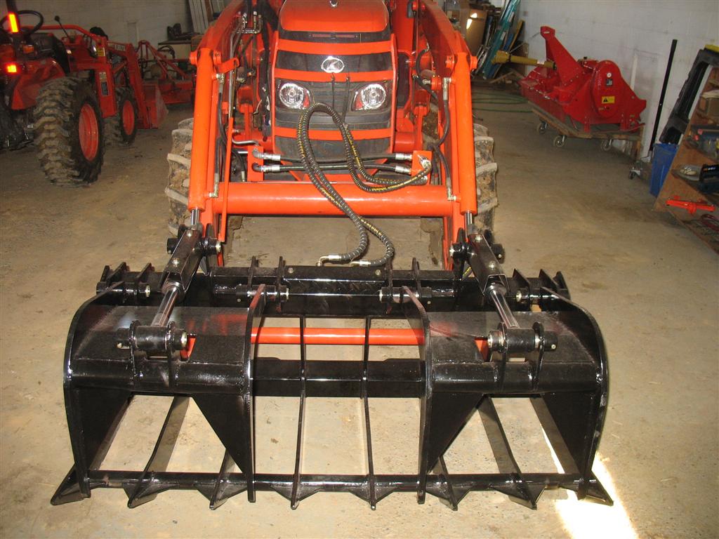

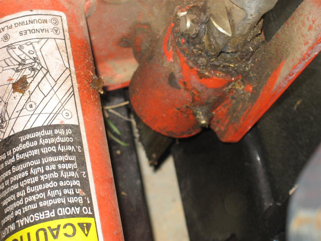

I just got my Titan HD 60" grapple. Hoses and connectors are fine. Works great for the 30 minutes I used it today. Picks up spoiled hay like a charm. Only problem is like I've read about the Wildkat grapple: the space at the pin (see pic). I have emailed photos to see if they will send a modified bracket.
I went with Titan over Wildkat econo models for several reasons (and in spite of all the recommendations on TBN to get the 48" econo.) The wildkat pics I had seen did not have greasable pins at the pivot points. It looks like it pivots on a simple bolt. I also had read about all the issues with the locking bracket and the QA plate not being sufficient. I didn't want to build the plate mod that others were doing. I don't know how to weld. Unlike the econo Wildkat, I have two grapple cylinders and heavier steel. The 48" is too narrow for my applications. The 66" is only about 100 lbs lighter than mine at 600 lbs. Anyway, hope I don't have buyer's remorse. I like it so far. Thanks to all the discussants regarding grapples. I really value everyone's talent and input.
From my experience that is a non issue. My five year old Millonzi grapple has non greasable pins. In fact the "pins" are just big ole bolts. All the threads on the wear surface have worn off but after hundreds of hours of use I still haven't needed to change the bolts. When I do I'll spend a few bucks at Tractor Supply and get new ones. An advantage of this simple system is that instead of machined pivot pins and bushings there is just a plain old steel hinge to maintain. I haven't needed to do a thing so far but if I ever need to build up any worn point I'll just whip out the welder and build up the worn part. Nothing precision about it.
