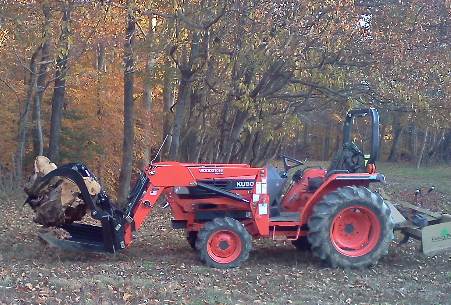

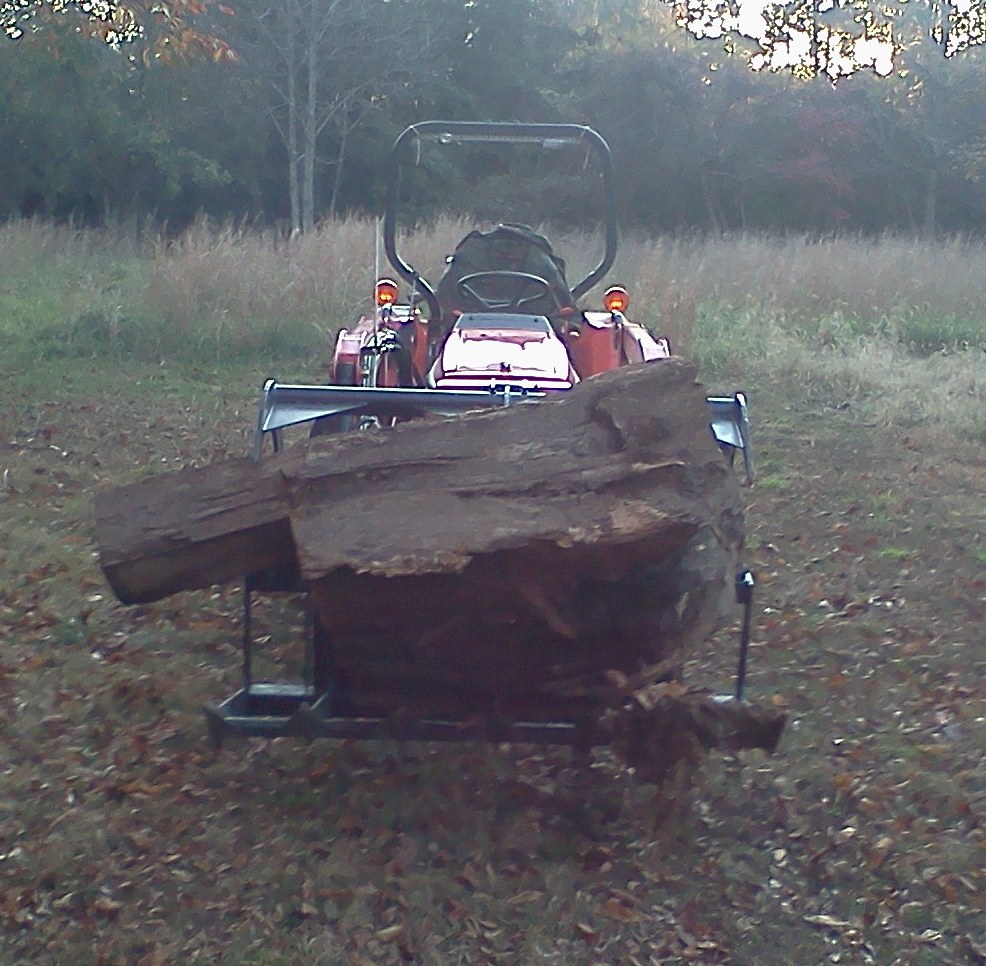

I finally got replacement hoses and got everything hooked up and the leaks fixed. Here are two picture of the first test run.

For anyone researching the Titan grapple, the pictures on their website aren't totally accurate. They have added a third tine on the top grapple (see picture in the first post). It is centered to protect the cylinder instead of a horizontal plate. The site also states that the end plates are 1/2" when they are 3/8" like the rest of the tines. I don't see that being a problem on a CUT.

More like lack of attention to detail and reflecting the lack of a well regimented production facility. I think a lot of these small grapple manufacturers operate out of garages or just barely larger production sites. Sloppy rather than intentionally false advertising would be my guess.
Most grapples of this size have all 3/8 inch tines so it really is fine. I know people sometimes specify the outside tines as 1/2 inch with the notion that thicker will be better but I don't recall anyone who has bent 3/8 tines with a CUT. My 3/8" grapple is on it's sixth year and the bottom tines are all pretty much just like new minus paint. That includes four years on a DK40se with 2700 lb capacity loader. I certainly wouldn't worry about the 3/8.
