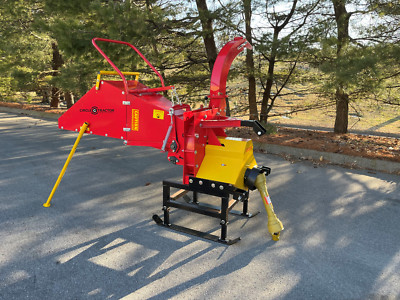

I used to have a chipper and it was a pain to use. I found a better way called a burn pile.
/ TMG chipper #42
I would agree and say that is good unless the state you live in does not allow you to burn like the one I live in. Then either renting or buying a chipper for your needs becomes a reality or hiring it out which can get pretty expensive.
/ TMG chipper #43
OP, much like you I had been on the fence for years about getting a chipper. Like so many others my only experience was with the small 3" self powered units which left me completely frustrated. I never actively looked for a unit but would see deals come and go from time to time but never the right combination of good deal, free time, and close location. That is until a few months ago. I stumbled upon a poorly worded ad on craigslist for a "used", really like new 6" Wallenstein hydraulic feed chipper. All the used market here migrated to FB marketplace a couple years and craigslist is pretty dead, combination of that and a very non descriptive ad let the thing set forsale for a couple of months before I noticed it. Gentleman was going to pull the ad and have the dealer he bought it from put it up for sale on the day I called. Sometimes we just get lucky I guess. New retail on the current model is almost $11k, I paid the going rate for a used Woodmaxx in this area.
I can't say the hydraulic feed is must have but it certainly is a nice to have in my limited experience. In my case I have 2 sons who are both learning and like to help. The controlled feed slows things down which helps. Doesn't mean that all the same safety precautions don't need to be taken though.
Pros/cons of each have been covered pretty well already, only comment is 6" plus units do seem to be much more accommodating in what will feed easily. In the end I don't think a chipper is for everybody but only one way to find out is to try one. Personally I don't think I will be a long term owner, much like the original owner I bought from. In his case and mine all of our ash trees are dying and chipping at least a portion of the wood that is to small for firewood is a nice option to add along side leaving them to rot in the woods. I would keep passively watching for the right deal to come along and pick one up. If you buy smart you can always resell for +- a few hundred dollars.
/ TMG chipper #44
Because my tractor is on the lower end for recommended PTO horse power (47hp), I don't attempt to feed it 8" logs because I'm sure it may bog down. However, I've had no issues with 6" material or less. The reviews of other users speak for themselves on this product – over 260 reviews, and they're all 5 stars. I couldn't agree more!
If you heat by wood, anything 6" or greater is firewood.
My Woodmaxx has 8" capacity. My previous tractor, a Deere 4520, had the PTO HP to run 8"...don't think the 4052 does, but it will take 6" with no problems
/ TMG chipper #45
In my experience, it takes about 10 hp per inch of wood diameter for efficient chipping. For me, anything over 3" is firewood, so I can use my little 33hp JD970. I tried a 4" dry pine log and it put the fire out:) I was using my 4320 but it was a pain switching from the chipper to the grader blade. I hope to just keep the 970 attached and be the dedicated power source, plus it is only 4x2 so that part works fine for chipping. Note the gnarly limbs I have to deal with, shaggy bark juniper. They for sure need two powered infeed rollers, one just spins on the wood/limb.
/ TMG chipper #46
Have had two chippers, only way I would ever have another one is if I could not burn at all. I found that anything that takes a shock, stump grinder or chipper, spells maintenance and broken parts. Plus the down time can easily out weigh the work time. I would prefer piling and burning, 6 times over chipping anything.
