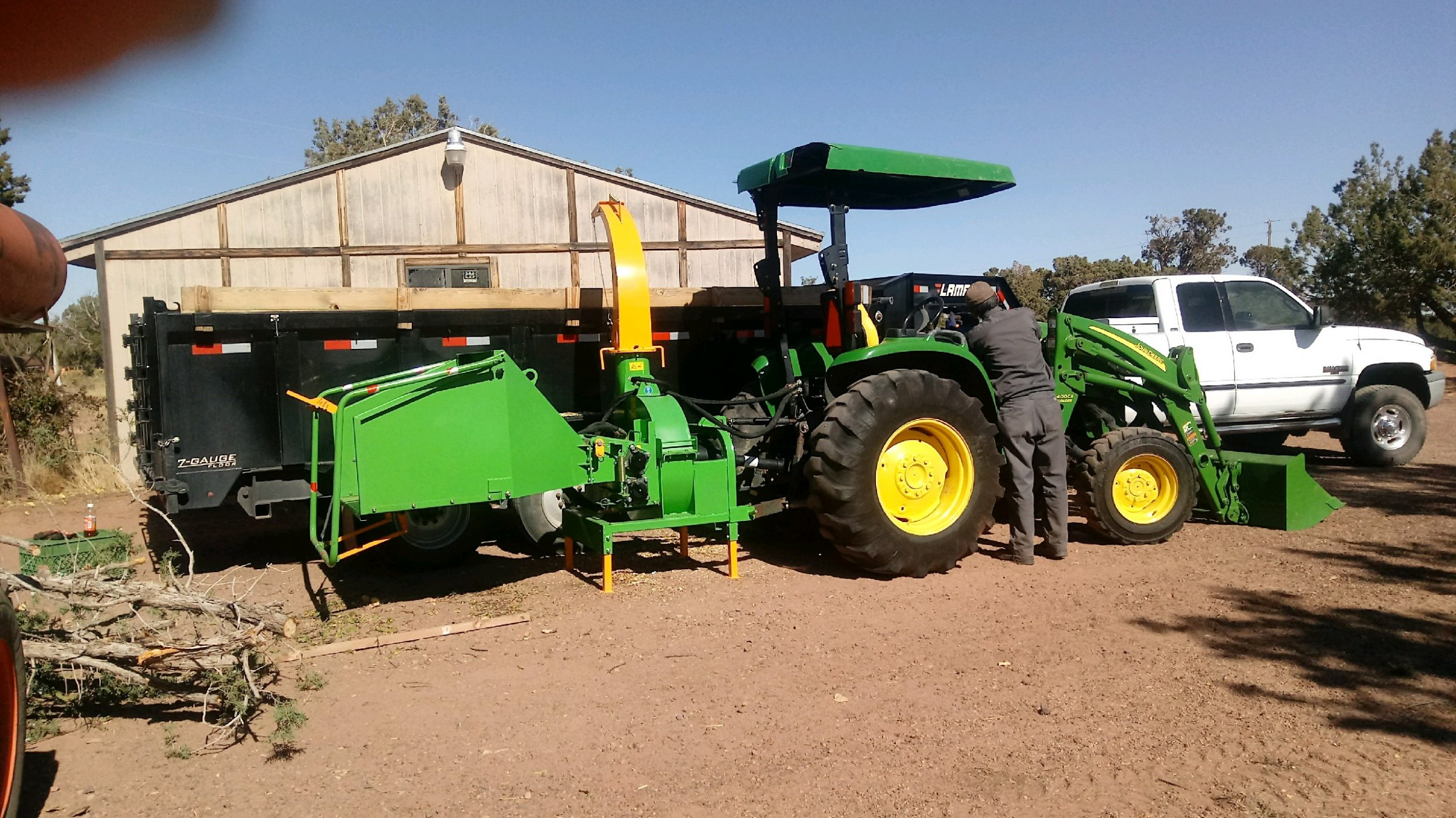

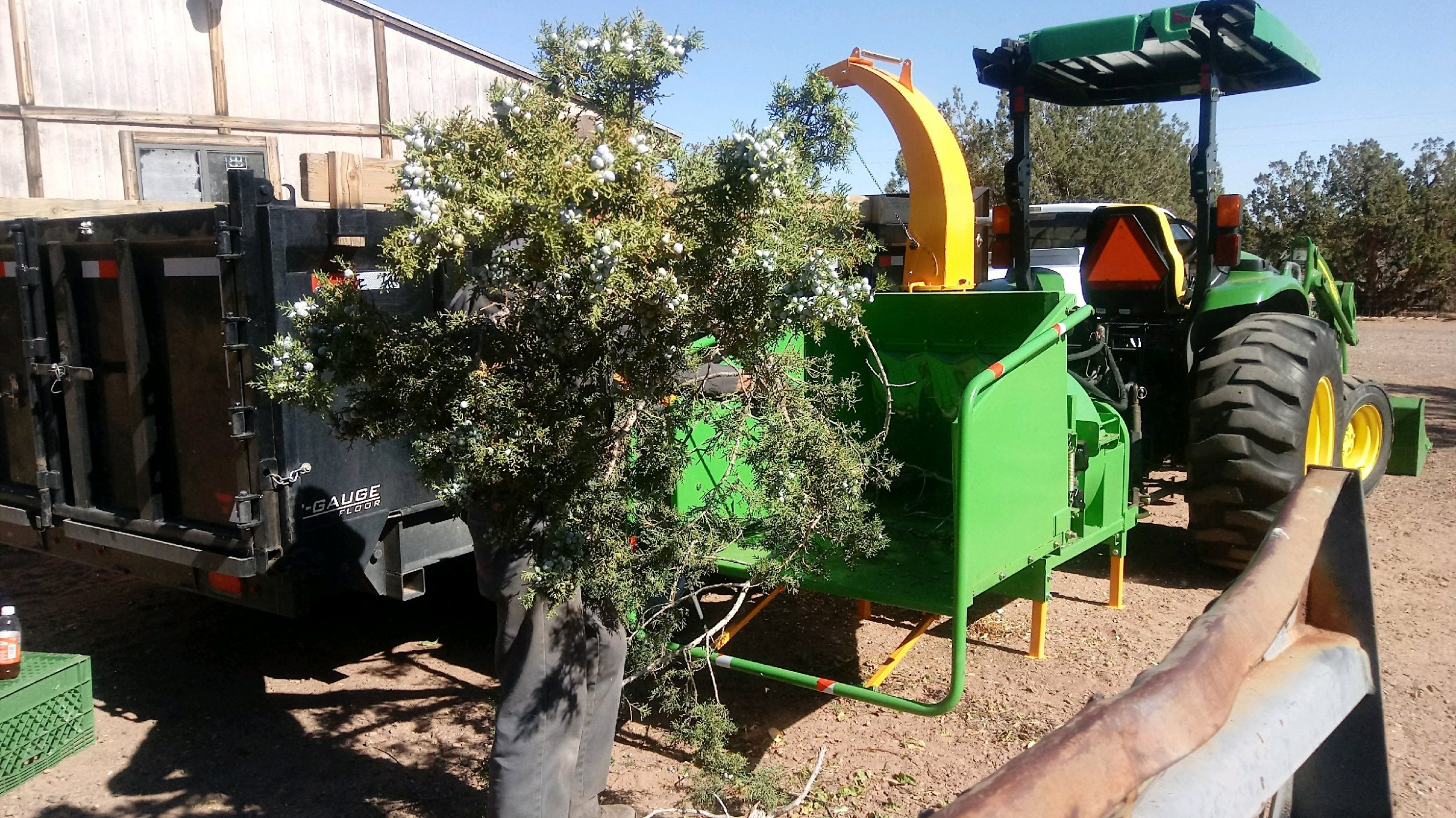

In my experience, it takes about 10 hp per inch of wood diameter for efficient chipping. For me, anything over 3" is firewood, so I can use my little 33hp JD970. I tried a 4" dry pine log and it put the fire out:) I was using my 4320 but it was a pain switching from the chipper to the grader blade. I hope to just keep the 970 attached and be the dedicated power source, plus it is only 4x2 so that part works fine for chipping. Note the gnarly limbs I have to deal with, shaggy bark juniper. They for sure need two powered infeed rollers, one just spins on the wood/limb.
