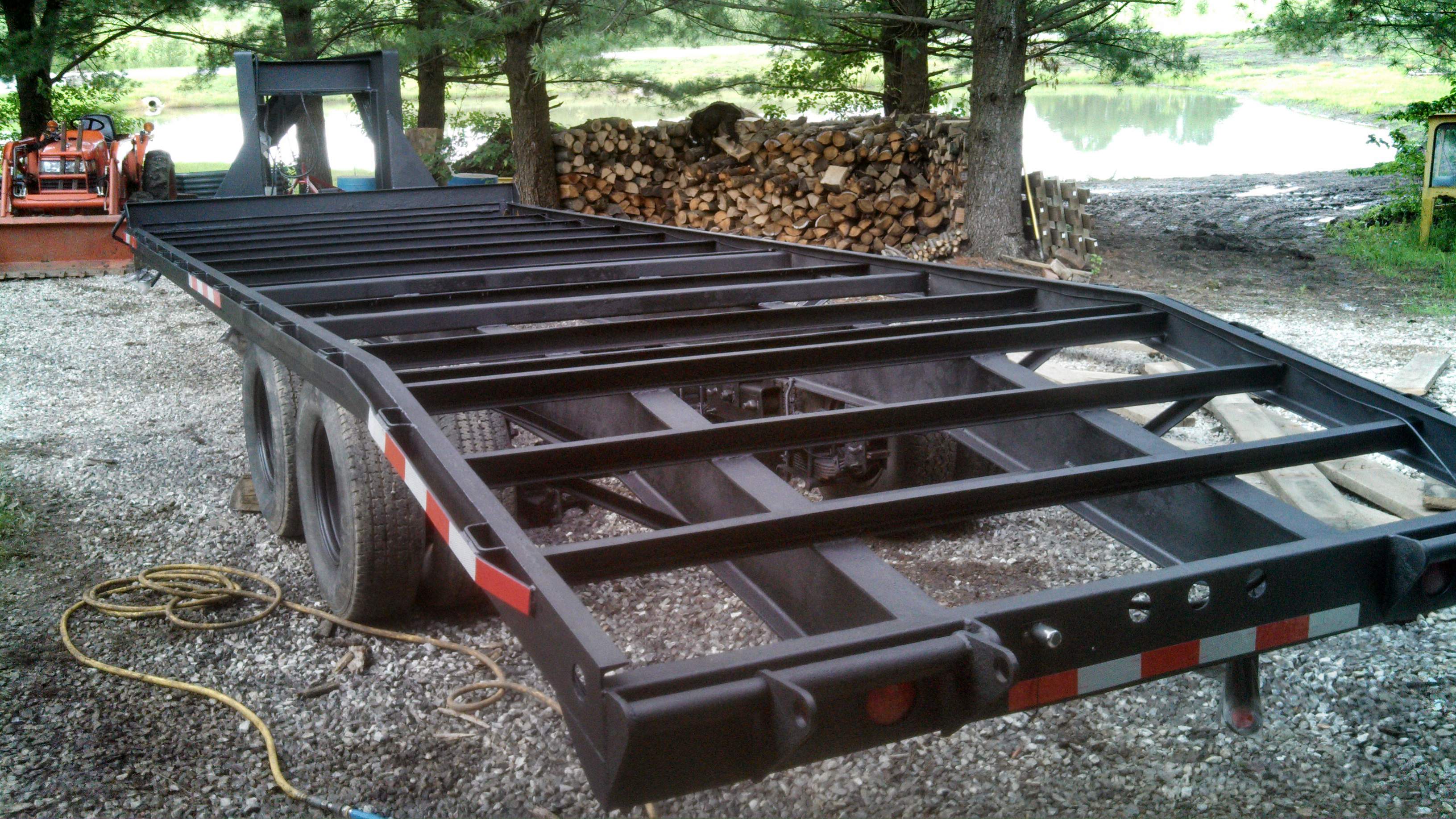

Well I got it all painted now. Had to wait on the rain to stop today:mur: And yep, it was like tar.
Boy what a mess it was spraying it. I had it all over me and that stuff is STICKY. Had to take a shower with mineral spirits:confused2:

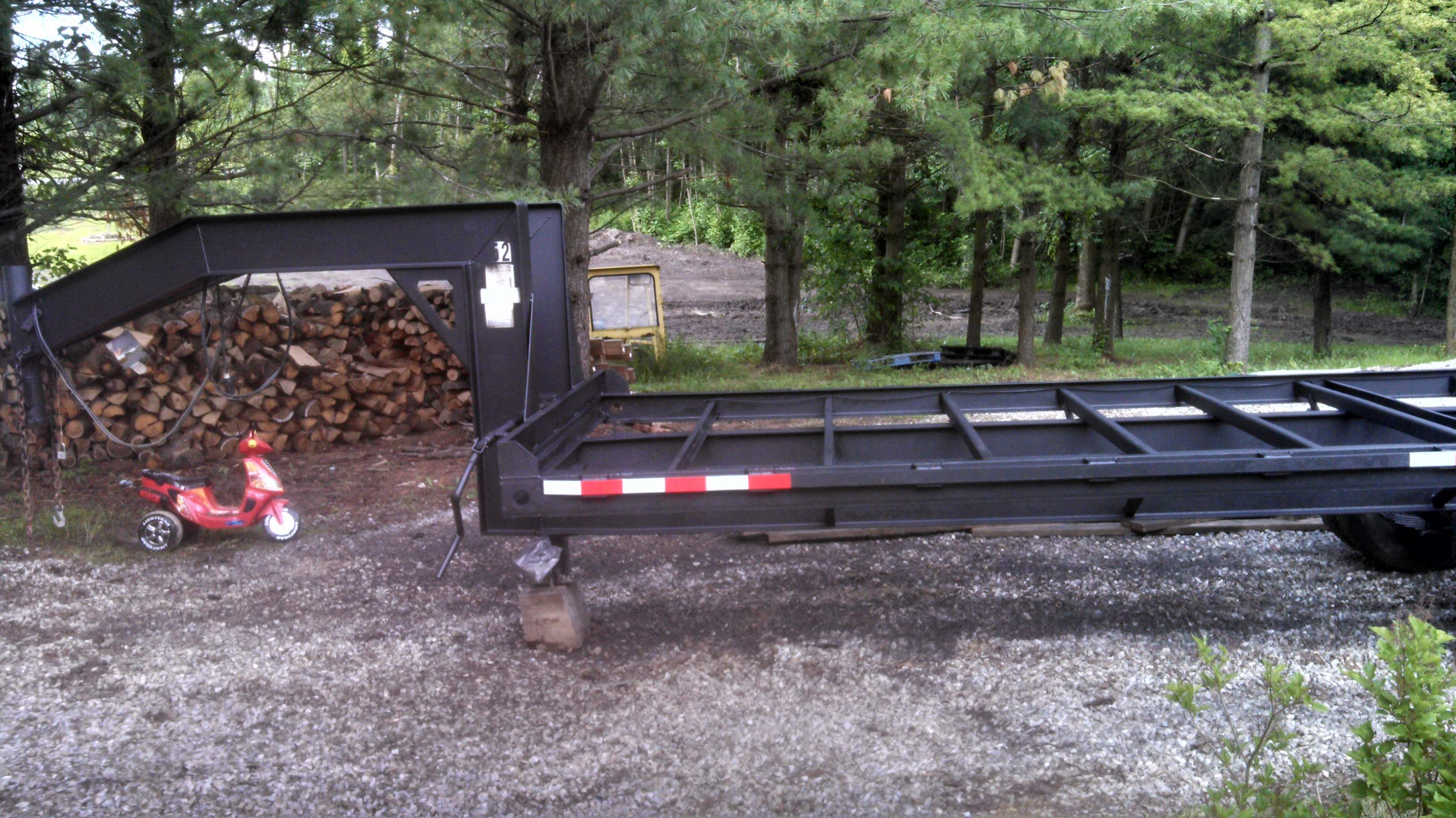

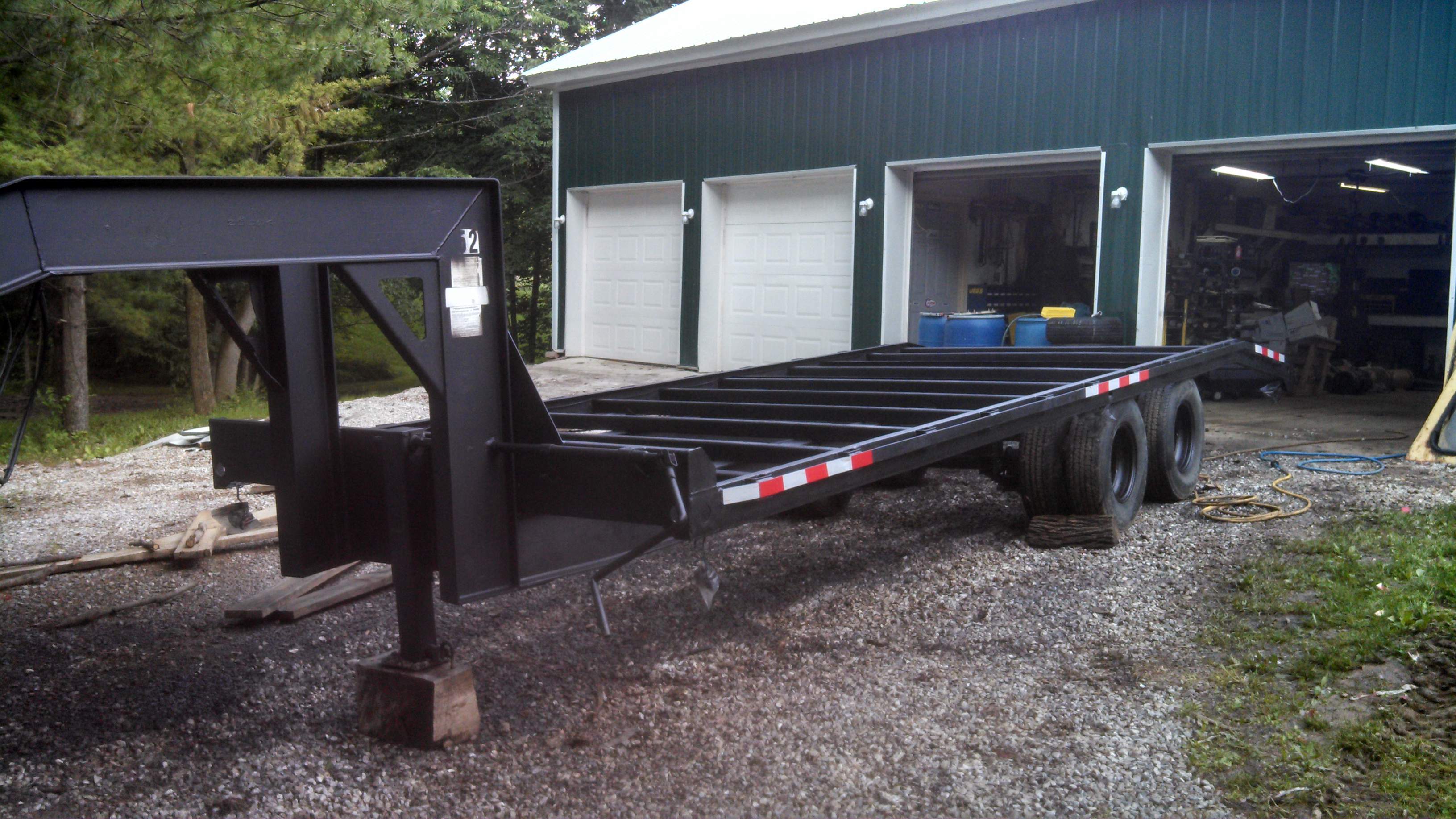

Heres some after shots of the paint
   / To paint or not to Paint the trailer. #36
<img src="http://www.tractorbynet.com/forums/attachment.php?attachmentid=322153"/><img src="http://www.tractorbynet.com/forums/attachment.php?attachmentid=322154"/><img src="http://www.tractorbynet.com/forums/attachment.php?attachmentid=322155"/>
Looks good

TSC has the refective red and white tape your looking for. Cheaper at Habor Freight. The fresh sawn lumber will show you all sorts of tricks while it is drying. You can reply with pride when the license bureau askes you the color of your trailer. It really does look nice.
   / To paint or not to Paint the trailer. #38
Wow, that looks good. How long does it stay on if trailer only used in the summer?

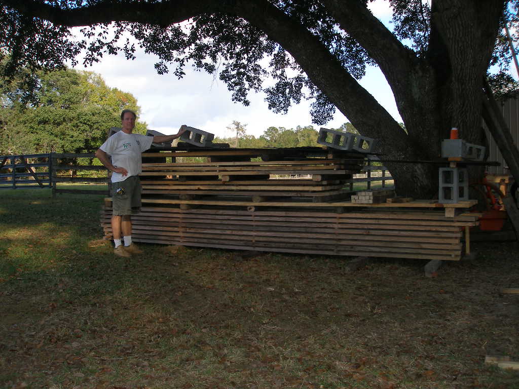

Let the boards dry or they will shrink and have wide cracks
Sent from my iPhone 5 using TractorByNet
   / To paint or not to Paint the trailer. #40
Let the boards dry or they will shrink and have wide cracks QUOTE]
And "sticker" them like this as they dry. May help from twisting, etc....
If the white oak is a 2 x 8 it may shrink up to 4%. So let it air dry for a couple of months. Put a piece of tin on top of the wood. Keeps the rain off and
allows the air to pass through the wood for drying.
