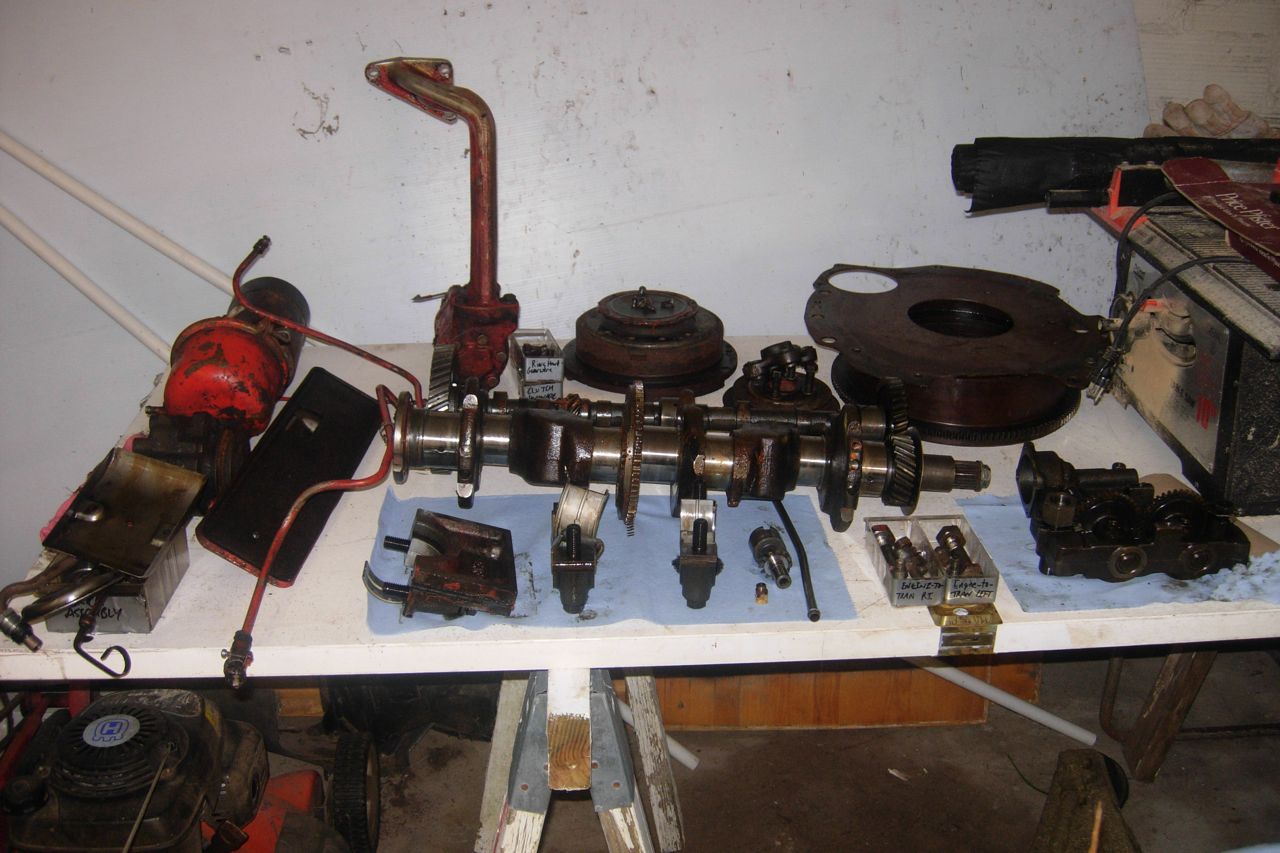

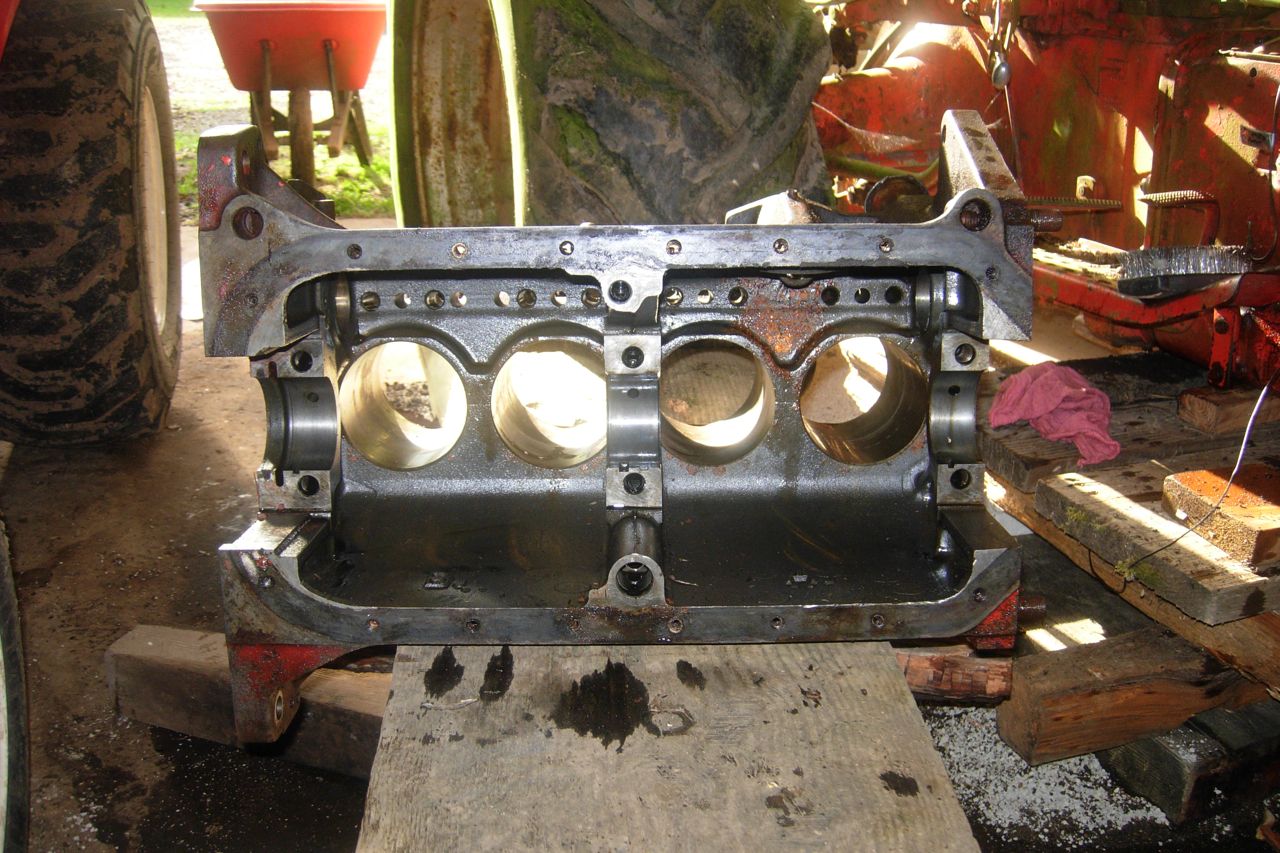

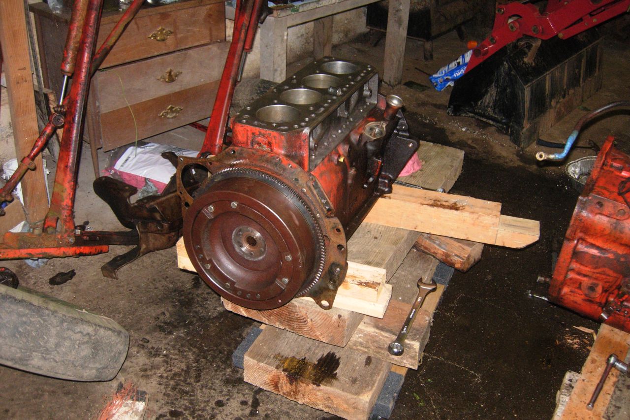

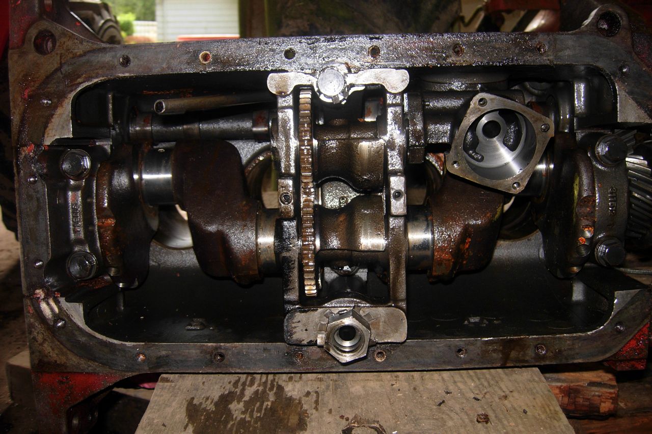

So, here's where we are today. Pretty self-explanatory - Block and Guts! :cool: Block looks pretty clean, crank and camshafts removed. I was happily surprised to see how clean the main bearings looked. Certainly minimal hours after the last rebuild. Alas - if I'd only kept her out of the rain, perhaps we wouldn't be where we are today. Water under the bridge. . .
Things look really good thus far. I'm taking the block into a local engine shop for Honing (sunnen) and quick cleanup. If all goes well I'm planning on ordering oversized rings (to grind to fit), gaskets, and a few extras to clean up the valve-train.

For some reason I was thinking this was going to be an 'in tractor' rebuild. Guess we can rule that out.
Can I assume the tractor is split in half ?, How did that go ? pics of the rest ?

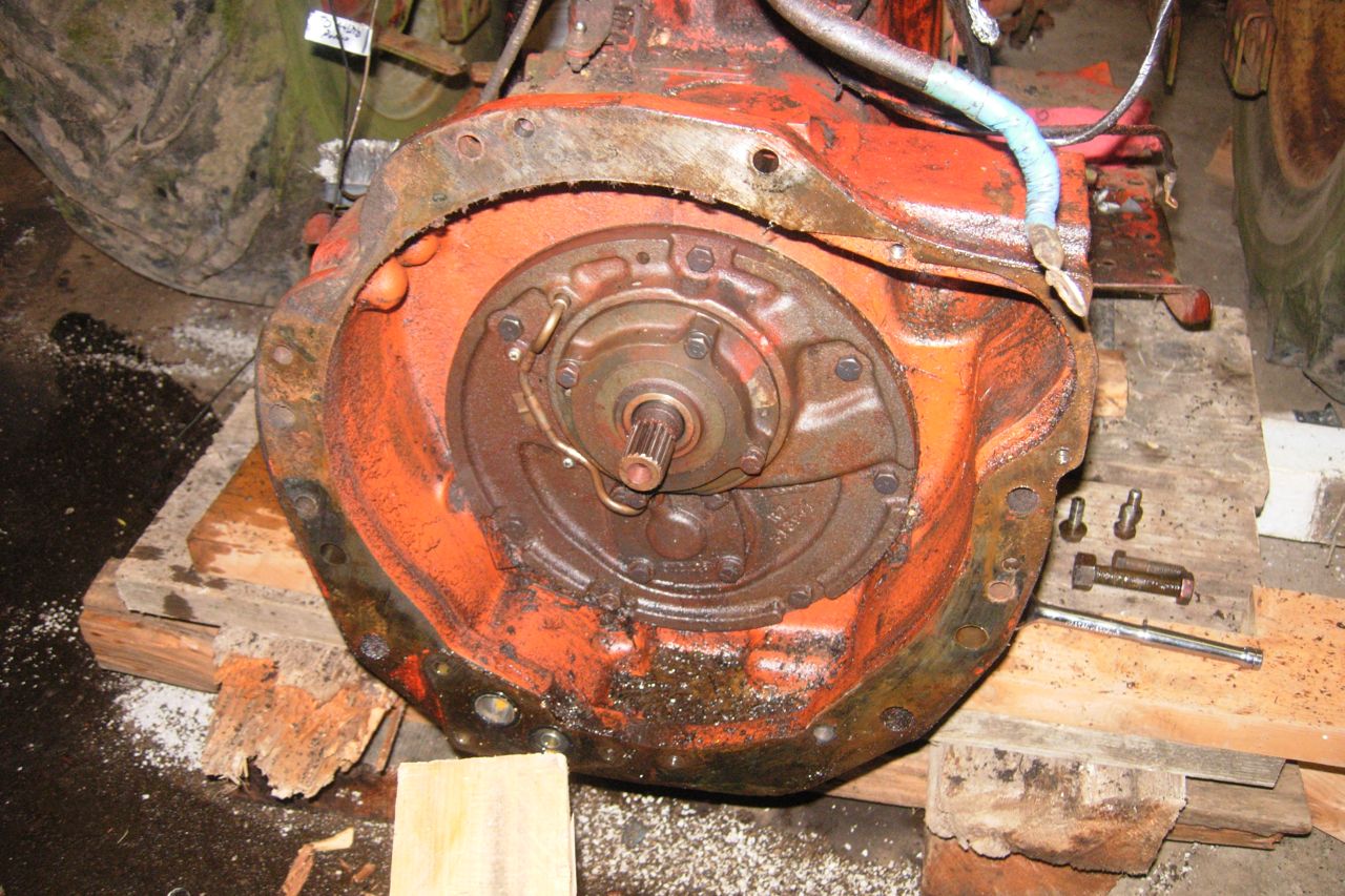

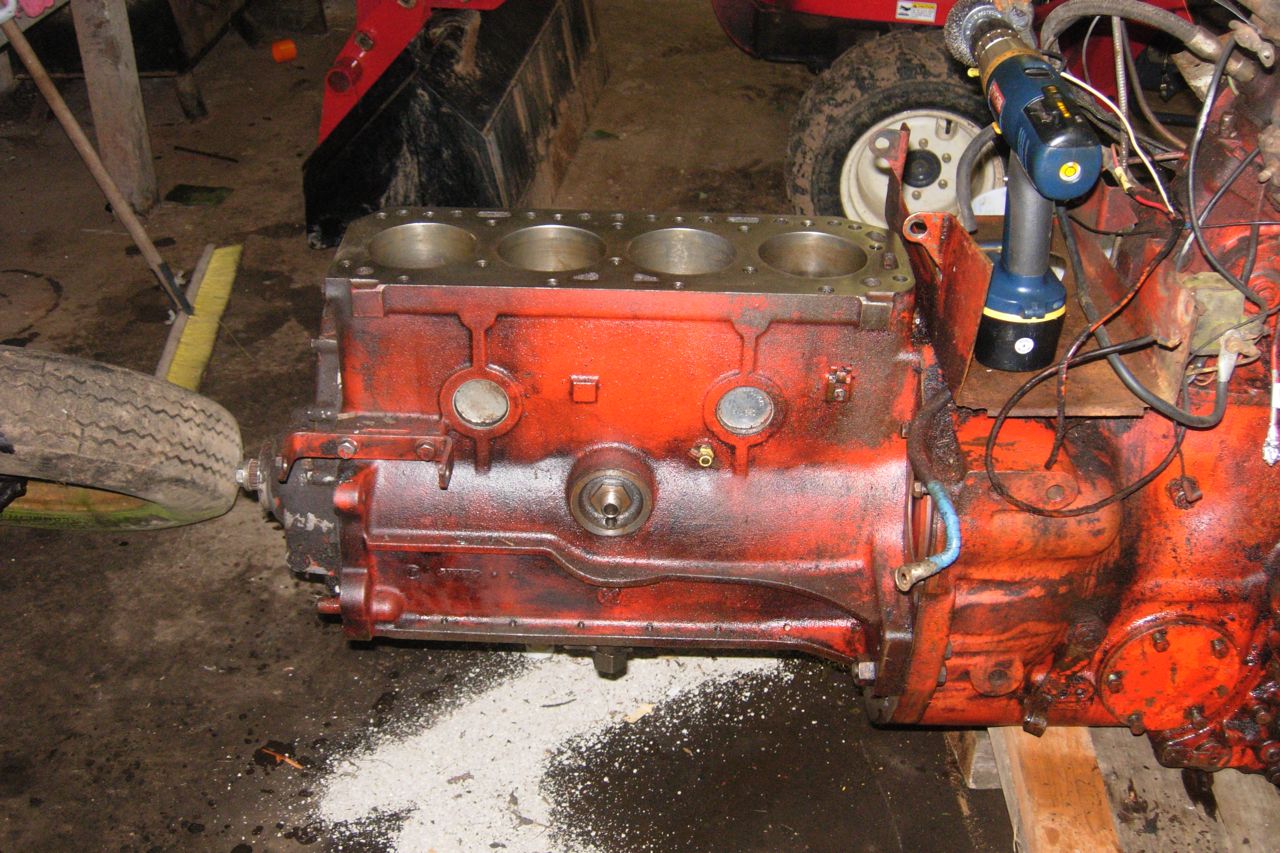

Actually, the original plan was for an in tractor rebuild, but I had trouble locating the proper hone and decided it was worth the extra effort to have a closer look at the crank and camshafts. I also enjoy taking things apart - the engineering is remarkable when you consider no computers are involved. . . .
The front end split went surprisingly well. Jacked-up and built a crib under the tranny, removed the front axle assembly,
and then built up a second crib on wheels under the block and unbolted it. She slid forward quite easily from the front end of the tranny housing.

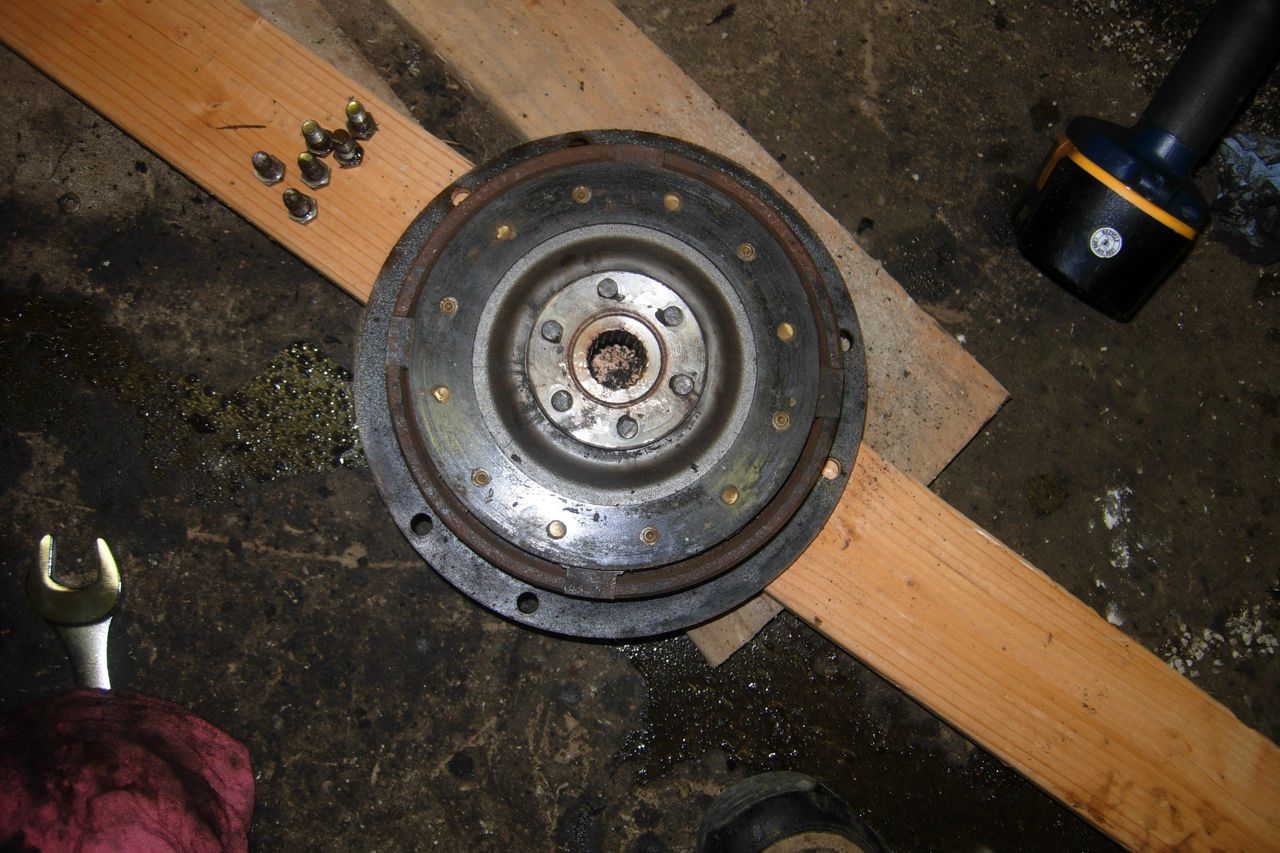

I then removed the ring gear, clutch, and Pulley Gear.

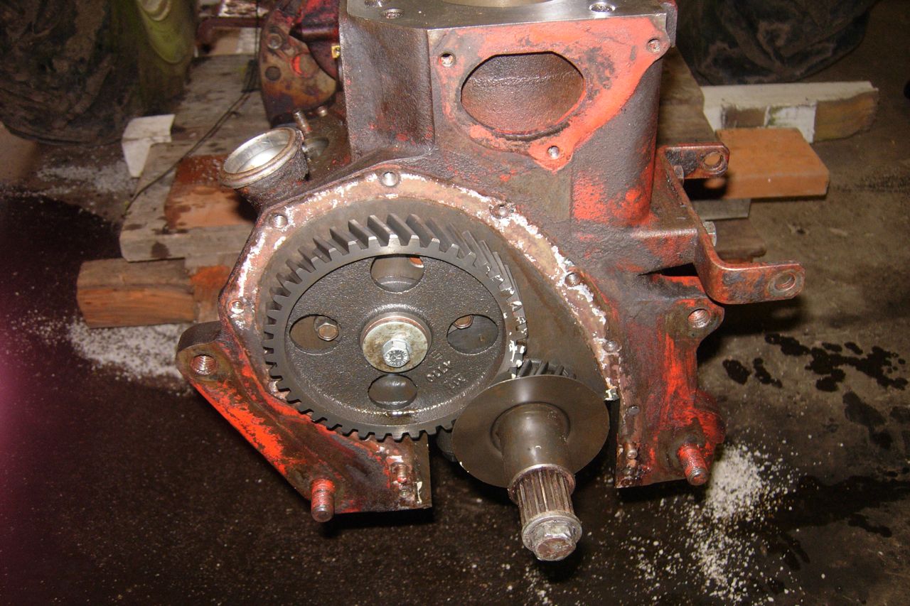

I was then able to spin the engine around and flip her on her side to remove the balancer, injector drive, and shafts.
Anything else you'd like to see? Just let me know. I'm documenting as I go to help with reassembly. If all goes well with the engine rebuild I still plan on disassembling the steering to find a powersteering leak, the rear tranny (maybe) to repair the PTO, and probably will completely clean her up and repaint. But. . . one thing at a time. Got to get her running!

A balancer ?, that must be that gizmo I was trying to identify in the last pic. Front center.
I've been into chevy and ford blocks quite often and never seen anything like that.
Do they counter-rotate ?
