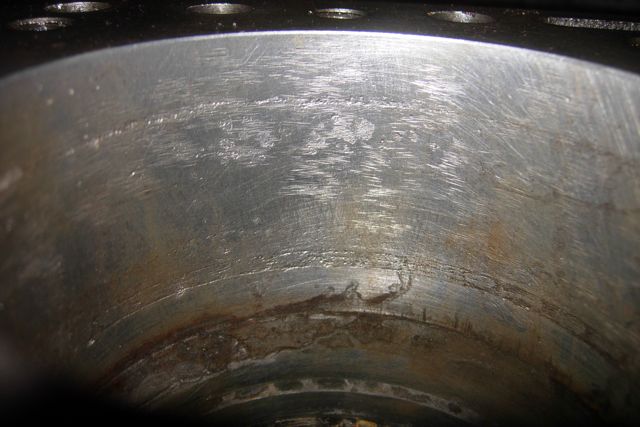

Can you "catch" your finger nail in the scratch? Nope, barely, a bit, yeah, Ouch! tore my nail! Pick your answer.
Shows what a Dingle Berry hone looks like --- correct name is ball brush hone.
Feature - Choosing and Using Ball-Style Hones - 08/06
You can buy your own on e-scam or similar places for about 25 bucks. You need one for a 3.90" bore. One good for a 4" bore is perfect.
   / To rebuild or not to rebuild this old engine?
#47
I would describe the scratches as barely able to "catch" a finger nail. I can basically feel that they are there. Here's how the scratches look in a close-up of Cyl #2. It's also fairly apparent that there is an oil ring imprint rusted into the cyl wall.

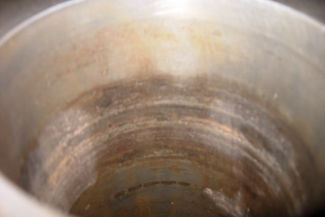

These ring imprints are also pretty obvious a little bit deeper in cyl #1 as well, suggesting that this was probably the root cause of my stuck engine.

Barely? I think I might try to hone that out.. toss rings in, and then go back in with a new set of bearing sheels the same size it already has and see what I got after hand lapping the valves.. cheap and not too bad a job if the cyls are not terribly OOR.. might get another good decade of use before you have to start thinking about other things on her..

Hey, you guys are the experts :eek:. Maybe it just depends on how long my nails are, or if I've been chewin' on 'em??
So, let me get this straight. Soundguy, you seem to be implying (perhaps sarcastically?) that the "scratches" are pretty minor?
And I have to ask, what's OOR? Is it "Out of Range" - as in - if the cyls are still fairly round, untapered, and NOT OOR, things should be fine?

OOR - I think he means Out Of Round. When cylinders wear they get larger at the top and also egg shaped.
Those may be on the edge of nasty, but for 20-40 bucks you could get a hone and try to fix them up and see what you get. That would only cost you a small amount of time and money.

Short story is you can probably get away with honing, ringing and replace bearings. Full rebuild is better and will last longer, but is the added cost worth it?
