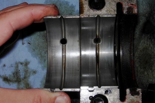

A couple of pics of the main and rod bearings. I don't have any idea who manufactured these (part number FM183X CP QT 010?), and didn't get any hits on the web, but it does look as though both the main and rod bearings are 0.01 "Under/over-sized". Can anyone confirm this?
Backside of front main bearing shell:
Inner surfaces of both bearing shells:
Backside of Rod bearing shell:
   / To rebuild or not to rebuild this old engine? #83
Fm = federal mogul
010 US = .010 Under size from standard.
The overlay looks good to me. If they are all this good I would reuse them, just as long as you haven't mixed them up and the crank is good.

   / To rebuild or not to rebuild this old engine? #84
Good to go. Dip them in oil and replace.

   / To rebuild or not to rebuild this old engine? #85
Yep.. doesn't look like the first coat is worn thru yet.

   / To rebuild or not to rebuild this old engine? #86
Yeah not bad. Try to keep them matched up if you can, top, bottom, etc. If they get mixed up don't fret. Each shell half is exactly the same. They just grab 2 and put them in a new box. Those look to have little wear.

#87
Actually I kept each pair of shells separated and organized. I can easily identify the top vs bottom shell for reassembly. To answer another question, the journals also look as good or better than the bearings, so I think I'm just going to give everything the once over, soak everything in oil, insert new seals, and reassemble. In contrast, the Rod bearings do show a little more wear than the main set, so it seems like a good investment to just pick up a new set.

   / To rebuild or not to rebuild this old engine? #88
Remember to use assembly lube.. I agree.. do the rods if they show wear.. the others look practically new though..

   / To rebuild or not to rebuild this old engine? #89
The pictures of the rod shells seem to bother me for some reason. Perhaps a picture with better light would show things better.:confused::confused::confused:
From memories of long ago the wear pattern and striations on the pictured rod shells bother me. Also the fact that they are all ready undersized indicates that some wear has occurred in the past. However, my knowledge is not sufficient to say weather all is good or not.:eek:
Chances are there are methods and equipment that can be used to measure and determine the suitability of the present gear for rebuild that would be much more accurate than an eyeball of a picture!:)
