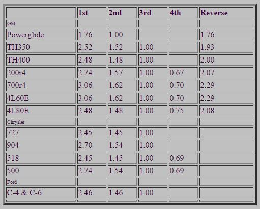

A 700R will launch faster and be so much more streetable because of the overdrive. Compare the gear ratios.

The 700R4 and it's improved electronic offspring such as the 4L60-65-70E's are great transmissions. But a lot of racers and street guys like that the "200 4 R" still has a low first gear and has closer ratios that work well with smaller engines that have smaller power curves. Having said that, the Electronic controlled 4L series are my favorites.

The 200 appears to be the same length as the 350-400, so that would be a plus in a transplant. The 700 is longer. I like the launch from my 700/4L60E's. I usually don't get past the shift to second point comparison much in town! :laughing:
453077d1452300249-todays-new-cars-way-overpowered-transmission-ratios-jpg
Well, We are talking two different directions as I wouldn't be concerned with a overdrive. As far as a hard launch, I would be more concerned with my convertor (and few other things) than my first gear ratio.
That gear ratio chart is quite interesting. It made me look up my gear ratios which are:

This gives me a big advantage over higher hp cars with 4 speeds in the 1/4 mile.
