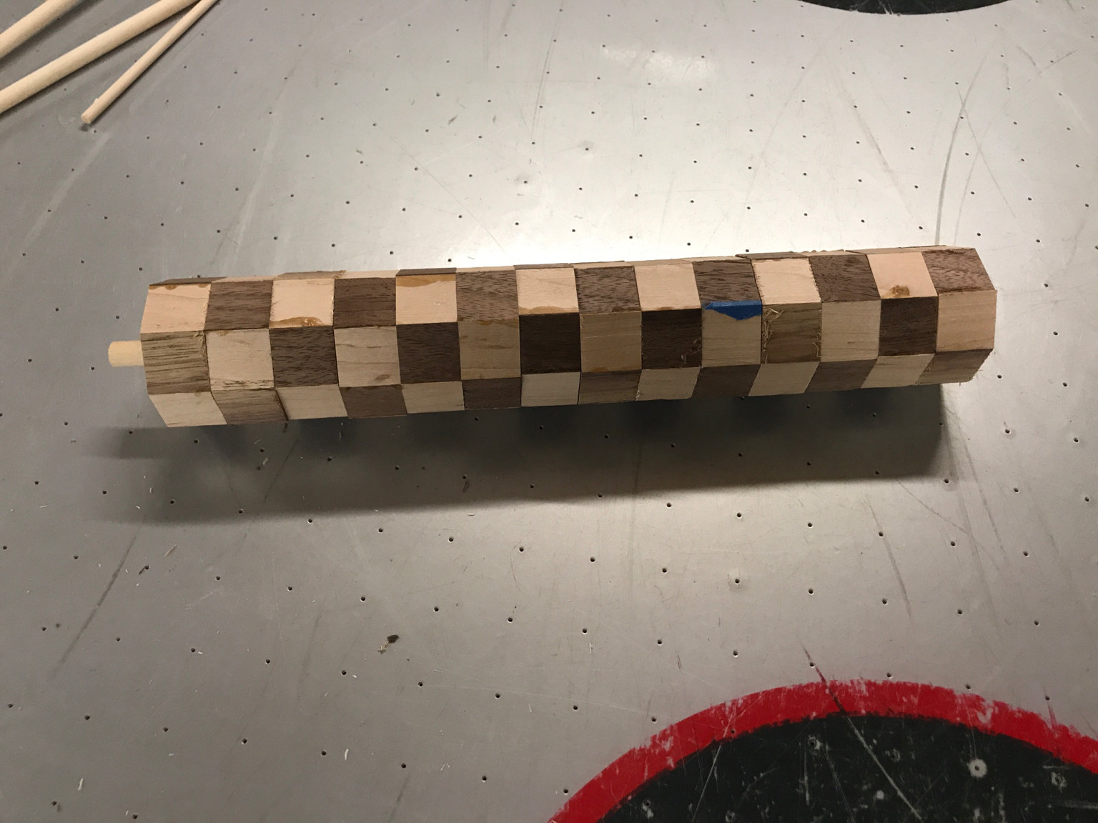

Same problem here. I could make more money at McDonald's unless something drastic changed. Here's the start of a rolling pin I'm making. IMG_0806.JPG

It probably took an hour to get things figured out. After that it went pretty quick. You glue up an octagon with triangles then cut it into pieces and glue back together. IMG_0805.JPGIMG_0810.JPG
