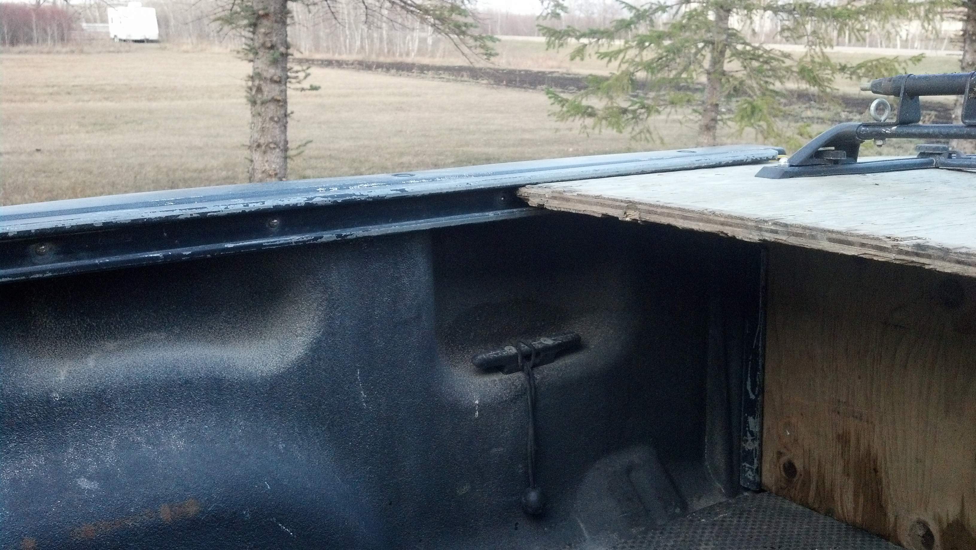

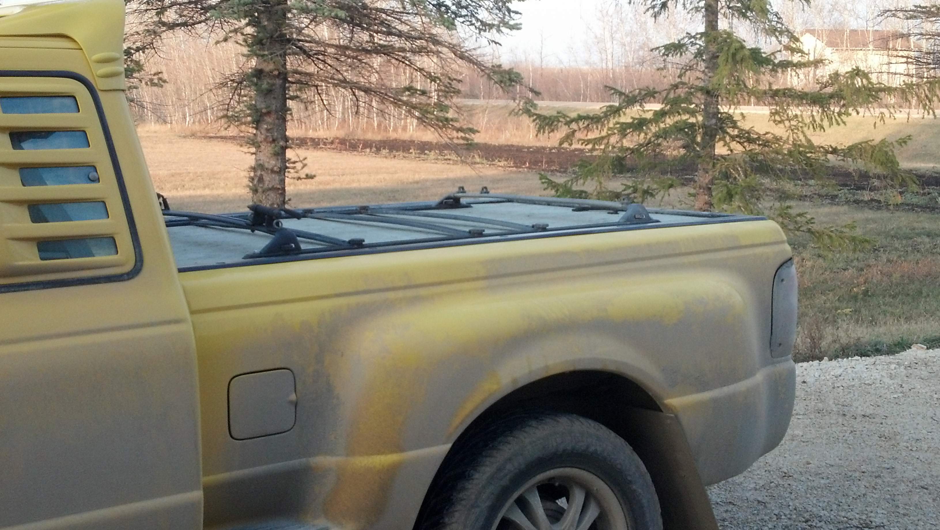

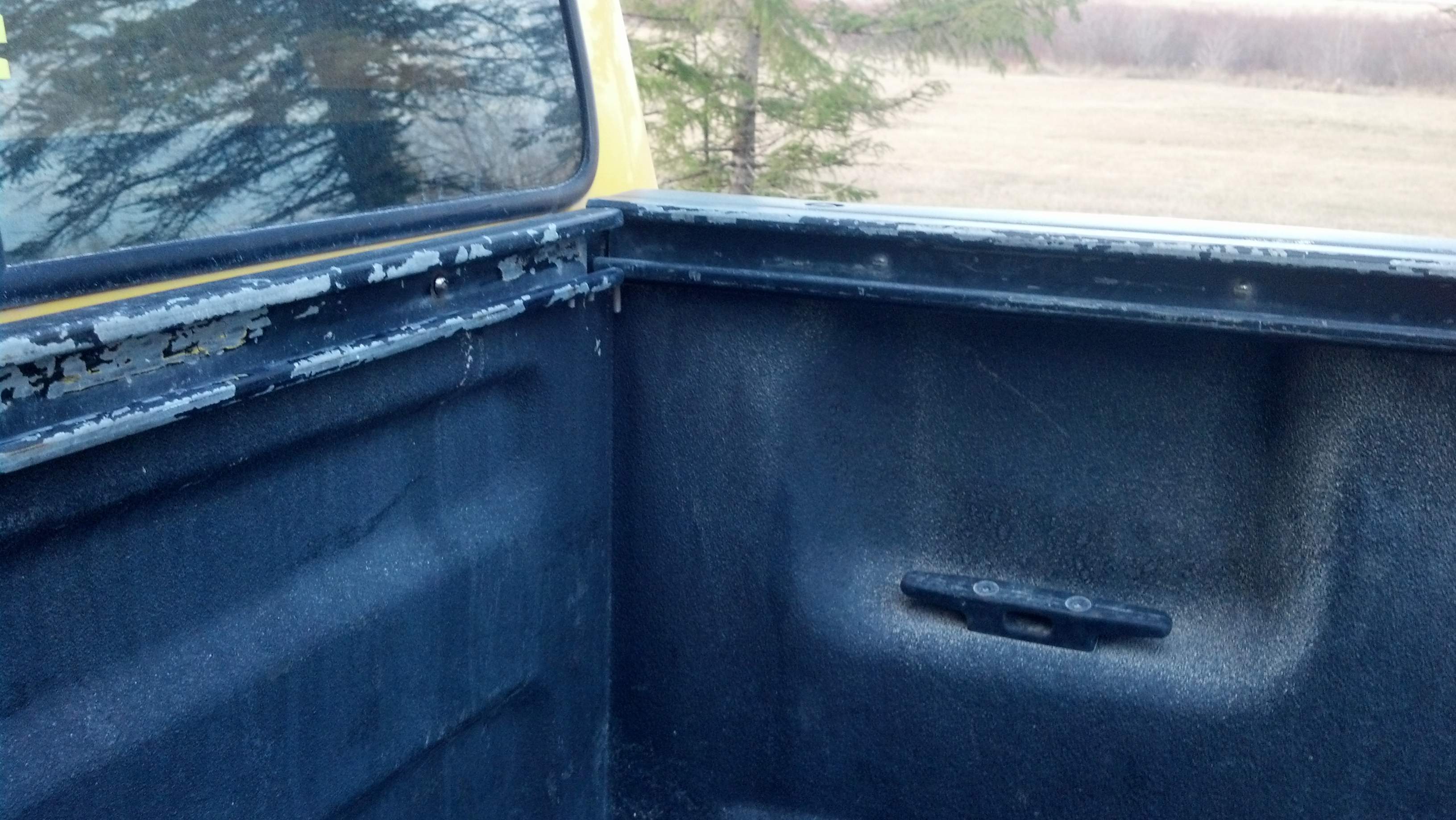

I thought I'd show us guys my reedneck improvised tonneau cover. It works pretty slick. All I did was use stove bolts to attach unistrut on both sides and the front of the box. I slide a precut sheet of 3/4" treated plywood and shazzm there you go. I put a cheap roof rack from some car from the wreckers($5). The roof rack allows me to tie larger items on top. If I don't need the roof rack, I just flip the sheet over than its smooth. Although there is no weather strip on it I find stuff stays pretty dry anyways.
I don't know if I'd do it on a brand new $50K truck, but its be on for about ten or more years and works great, one "upgade" or change might be to cut the sheet in three seperate pieces, that way you could just pull them out and stack them in the box beside your large item.
For security, its a theft proof as the lock on your tailgate. Keeps honest people honest.
