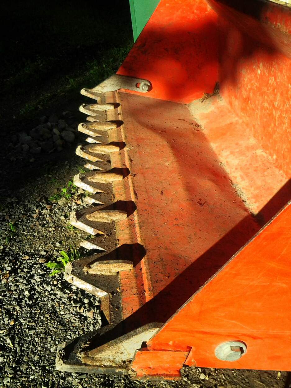

Wow, that looks nice. I have not seen as good a picture as that before. Do the teeth rust? My bucket sits in the weather.

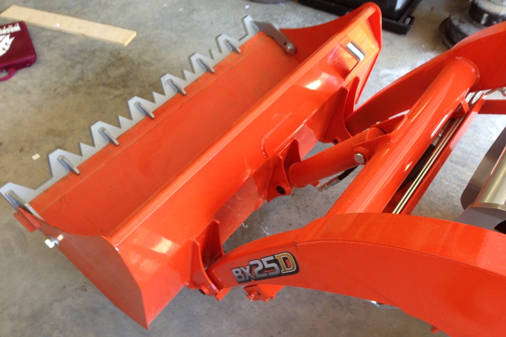

View attachment 346313I put a tooth bar on mine soon after I got the tractor. Its great help for digging and as a "back-drag" for smoothing. Mine is just a simple tooth bar(Rankin) not one of those exotic, sharp shark tooth ones. I "bump & bleed" often enough with what I've got - don't need a sharpened one.
   / Tooth bar options and. Advice? #13
<img src="http://www.tractorbynet.com/forums/attachment.php?attachmentid=346313"/>I put a tooth bar on mine soon after I got the tractor. Its great help for digging and as a "back-drag" for smoothing. Mine is just a simple tooth bar(Rankin) not one of those exotic, sharp shark tooth ones. I "bump & bleed" often enough with what I've got - don't need a sharpened one.
Nice tractor and loader. LA1153s are stout
Here is another newly installed but no rust on mine after 4 months and 100hrs use. Extremely happy with it!

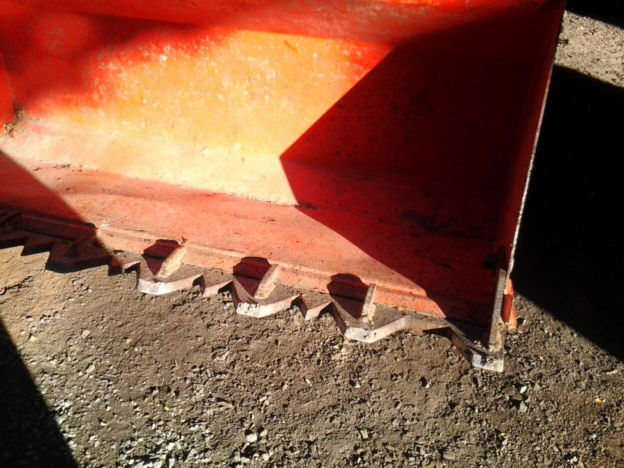

Here is ours, after used for digging, scraping, raking, and any other ground, tree, and brush contact activities we could come up with for well over 2 years.
The brown and rust colored stuff is our clay.
